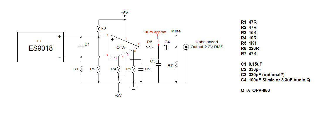

George, try a single OTA like OPA861 which can be run up to over 12mA and then add an external buffer after that - no need to do any stacking at all and the 861 will be equivalent to four (+?) stacked 844s.
Also allows you to choose the best buffer you can find.
Or use OPA-860 with its own buffer, alas the buffer is closed-loop, but uses current feedback and is somewhat better than voltage opamps used a buffers. It would make for an interesting comparison for those willing to try it - and it may possible, who knows, sound better than 5 stacked 844s.
Keep in mind -/+ 5V only, but once output is nulled, will swing 8V p/p - or 2.8V RMS - so gain needs to be set to give 2V RMS @ 0dbFS.
It works - I am listening to it right now (@ 2.2V RMS output), but not with all current absorbed by "-" input as you have to with 1704 DAC - using it differentially from a Sabre DAC.
Worth a try, but the slew rate is less than half as good as the 844 i/v stage, and the primadona's over at the other place say this is one of the most important specs for a good I/V.
And not too keen on using the +-5vdc supply that powers all the digital stage. I would rather make a new one.
Huh? I had two 15V rails and regulated down to 5V rails and no way I use the digital supply.
