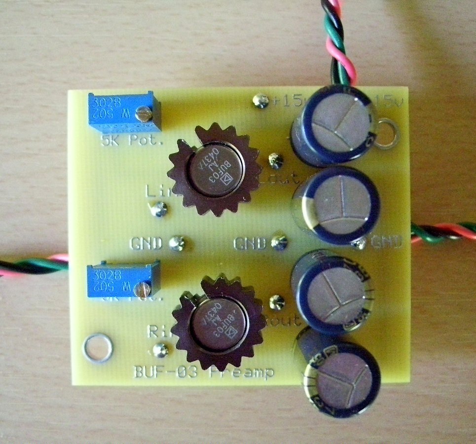

since you need a buffer anyway why not make it a 2nd order LPF with Q, fc coordinated with the RC for a 3rd order Butterworth @ ~ 40-50 kHz
Nice of you to chime in JCX, can you give details on how you would do this on the BUF03 buffer without changing it's nice low 2ohm output impedance (attached) I am using?

with a dedicated unity buffer chip you're stuck with the unity gain equations unless you add another op amp for the 2nd order section -which does simplify/separate the design equations
just use the same 1st real pole RC values with the R gnded, I into the 1st RC node == Norton equivalent
but with free choice of LPF I'd use the multiple feedback filter with good VFA - for lower distortion

George -- to get high enough Q to do what jcx is suggesting with only Rs and Cs you'll need to use feedback. Alternatively, embrace inductors.... 🙂
To do feeback around the BUF03, I'd need another opamp not for me, I have at the moment no global feeback from the output of the PCM1704's all the way to the speakers I think I'll keep it that way, I'll just settle for the 1st order filter at TZ of -3db @125khz

The standard Sallen-Key style 3rd order filter uses a unity gain buffer so you could do it with the BUF03 you already have. But if you prefer to keep things feedback free, then inductors are the only solution I'm aware of.
if you use bigger than 4:1 unequal C in the unity gain buffer Sallen Key then Q>1 is possible with equal R in the 2nd order section considered alone
values have to be adjusted due to the interaction of the added 1st RC section for 3rd order Butterworth
less interaction can be had with further large impedance ratio between 1st section and the 2nd order part
as far as "avoiding feedback" is concerned - why do you think the BUF03 has unity gain in the 1st place? (hint: because it uses 100% voltage feedback internally)
and if you just don't like negative feedback then you may be entertained to know the Sallen Key is actually using positive feedback to boost Q

It sounds magnificent as it is, I think I'll just keep it at the simple 1st order at -3db @125khz on the TZ filter. With this there is just a couple of degrees of phase shift at 20khz, and the vhf noise on the output of the BUF03 is only a couple of mV at more than >100mhz, I don't think this is detectable at all. And then this way it's very simple with no global feedback anywhere in my system.

the worry about “phase shift” is also misplaced – how long do you think the digital filter is – typically low double digits of the sample rate, 100s of degrees
so “phase shift” is not so useful a quality metric, the player already has lots – if linear with frequency it is simply a pure delay
the real “time distortion” is the variation in group delay over the audio range
for a 50 kHz 3rd order Butterworth that's ~ 700 ns of delay change from 20 to 20 kHz
or about 0.2mm (0.008”) of air path difference – how's you speaker driver alignment, what's you're driver x_max?, any baffle diffraction, room reflections? what's the radius of your tweeter diaphragm?
