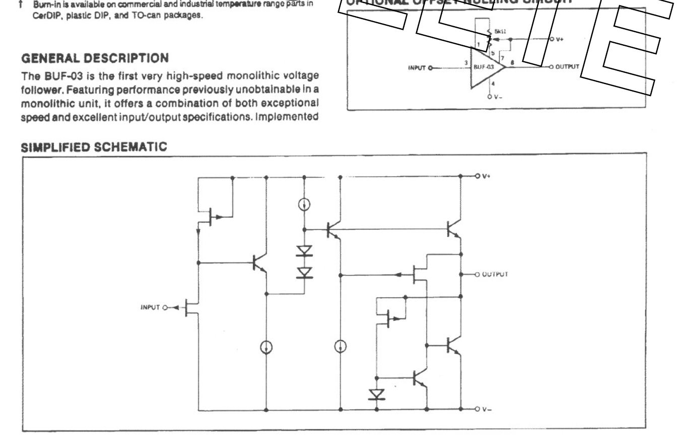

They did it with the BUF03 and that was some 20 years ago and they even had a dc offset null pins on it, they must be able to do today and even better, I just can't understand it. Dirk by any chance do you have some BUF03's in your stash?
Cheers George

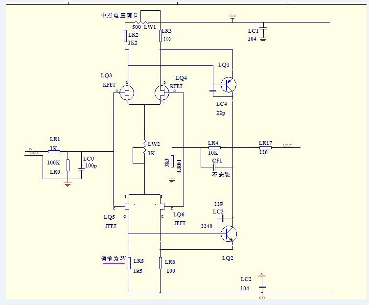

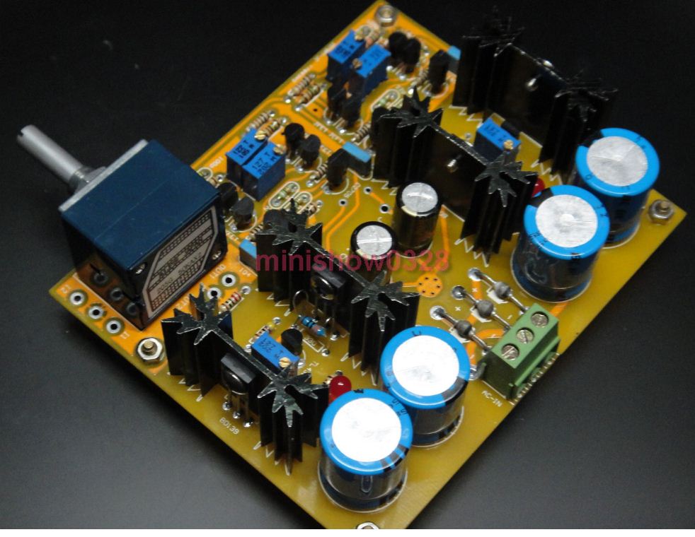

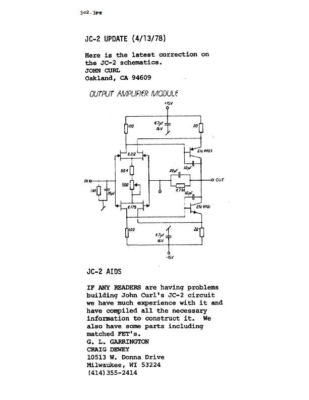

There is a discrete one on ebay that's cheap, it a clone of the JC-2 I believe that John Curl designed for Mark Levinson preamp output buffer. And it has power supply attached as well What do you guys think of this circuit? Are the bi-bipolars the output?
Cheers George
