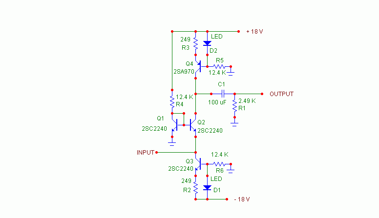

His IV stage?:
http://www.diyaudio.com/forums/digital-source/6121-easy-build-i-v-stage.html

Hi Jocko,
Nice to see you back. I thought you had left us.
I see a common base amplifier between to current sources or should I say between current source and current sink?
My problem is I don't like common base amplifiers....
All the best.
Jocko:
If you carefully adjust the current, it will work.
Yes, it is a common-base. Not an RF engineer, eh? I am, so I do.
Jocko
In post 42 he provides an update:
Why don't you guys ever believe me???
I built this thing......made a few changes........
The load resistors are 3 K, so that you actually get some gain out of it. The resistors for the current mirror were changed to 5 K so that the collector voltage was decent. Raised the rails to +/- 24 V.
With 1.2 mA (peak.....which is what a '1704 puts out) the distortion is.........drum roll, please........
- 40 dB.
Just one problem. That is when you measure it from the collector to ground. When measured between the collectors, it is -23 dB.
So there.
Jocko
