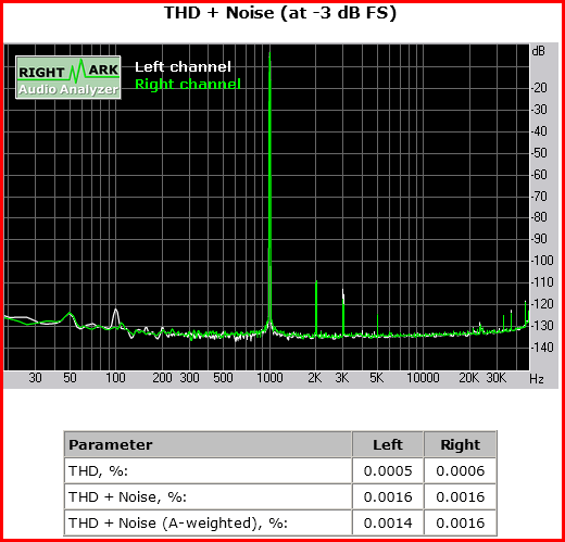

misreading Putzeys? - the Baxandall "harmonic growth" plot doesn't even have 9th on it - with a -120 dB floor
Then work out how much feedback is needed to get the same high order distortion performance (talking here 9th harmonic and above) at the top end of the audio band as against an open loop design.
- is meaningless - by itself - most can't hear the 9th harmonic of 2 kHz
feedback reduces all the errors it can measure by the loop gain at that frequency
IMD products folding down into the audio band are in fact reduced by the excess loop gain at those audio frquencies
modest priced soundcard with indifferent JRC V-mode op amps, Delta-Sigma ADC and DAC - can't see 9th at -130 dB
double the frequency so that the 9th is at the upper edge of aubibility and the the single pole compensated op amps are only expected to do 6 dB worse from the loop gain roll-off

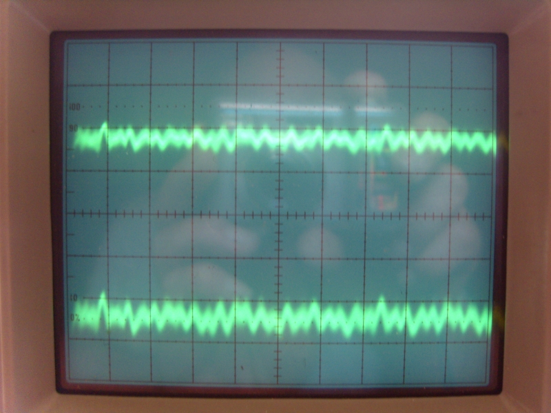

George: I have scoped it, with a 200meg Tek with all my tech bench test disc's till I was xeyed. Stable as rock under all conditions.
IMD. I'm guessing it won't be a test track but more of a test situation. Freqs involved in IMD will be much higher and involve freqs from the workings of the DAC and freqs picked up from other parts of the circuit, RFI, EMI, etc... again I await those who work with this stuff in their dayjobs and know what they're talking about to chime in ... I just try to restate things at different levels ...
George: I do have 2mV of very high noise now on the output, but it's so high even the scopes 20mhz filter doesn't touch it, I scoped it all the way back to the PCM1704's itself giving it out, nothing to do with the AD844's or buffers.

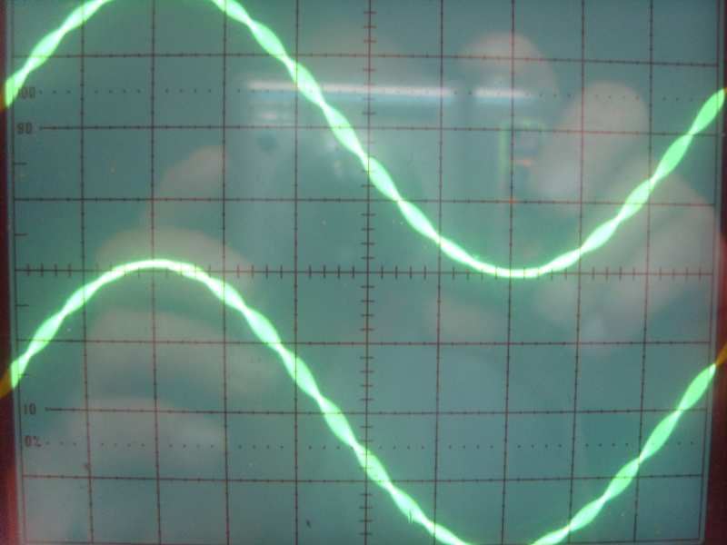

I do have 2mV of very high noise now on the output, but it's so high even the scopes 20mhz filter doesn't touch it, I scoped it all the way back to the PCM1704's itself giving it out, nothing to do with the AD844's or buffers.[/I]
P.S. Depending on what the experts say, that 2mV high freq could be used as an IMD test signal that we follow through your circuit and see how the different parts "handle it" as they simultaneously try to pass all the other frequencies ...
This noise on the rca's is I think the staircase noise in the pic (20khz 0dbf), no LP fitering at all from the dac to the rca's. I prefer to listen with the noise present and no lp fitering at all. As it's so high, way over 20mhz as the 20mhz fiter on my scope dos'nt touch it. As Terry "Zenelectro" said to me a while back about these noises, "trust your ears and not your eyes in some cases" I also believe the AMR CD77 that Thorsten Losetch designed, someone here said it has a lot of HP crap on it's rca outputs as well becase it can cause trouble with certain smp supplies on amps.
