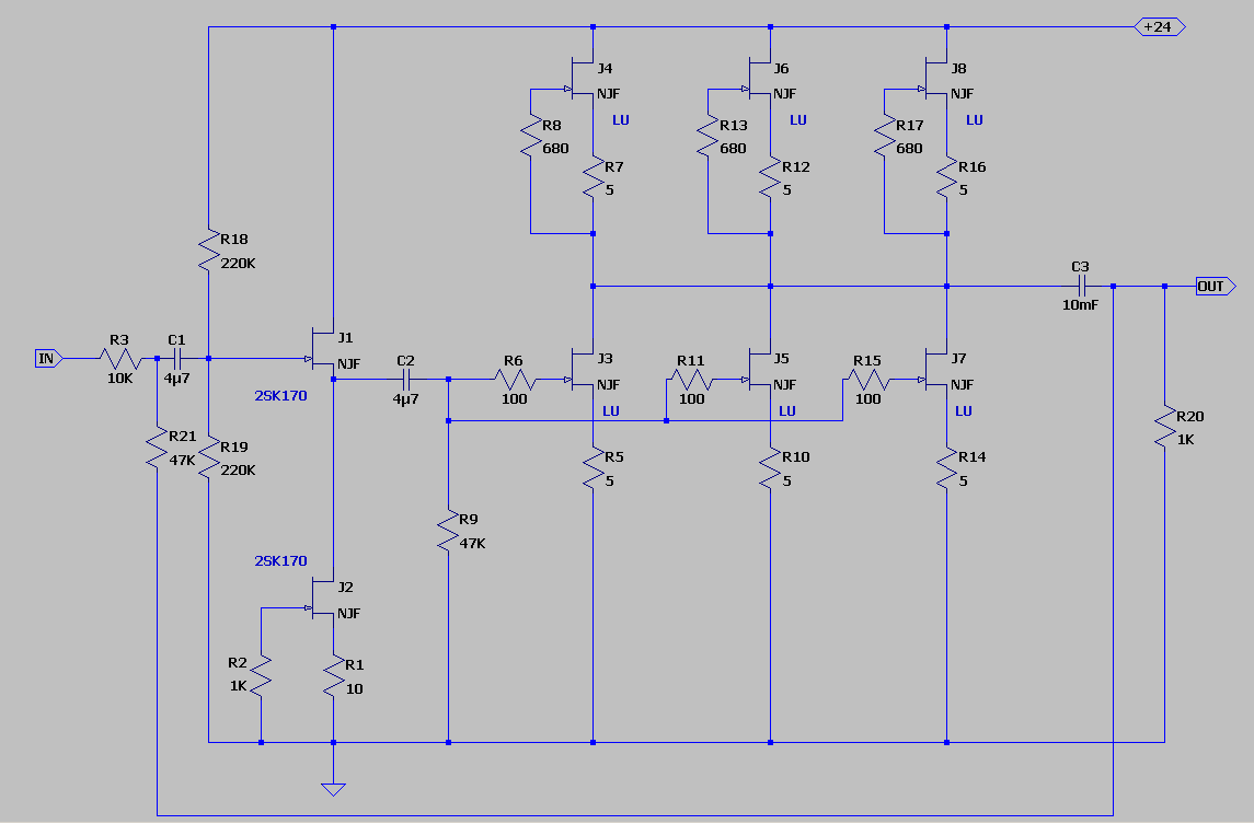

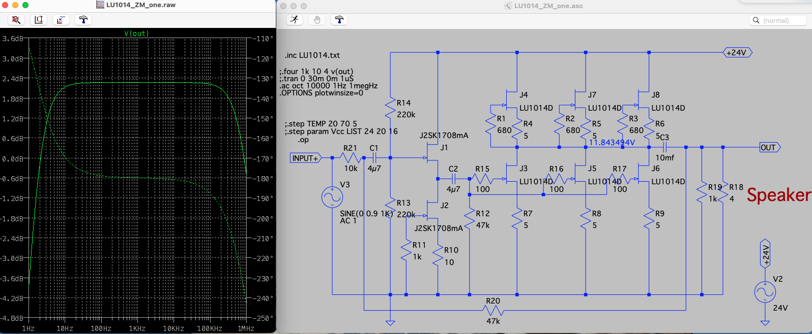

Using LU1014D in parallel for a power amp stage.
Maybe they are running too hot – almost 40W for a package that is designed for decawatt use.
After failure – did Drain become open circuit?
BTW VGS breakdown is in the 12 to 14V range (in DS).
EDIT: Exactly, as Nelson said ^ it is tiny device (we posted at the same time).
I'm almost ready to give up. I have a couple things to verify but I can confirm that heatsink is around 30 Degrees C when the fault occurs. It is not heat related.
As nelson states, I want to verify vDS of both fets before failure and then I put baby to bed and build the F3. I will put the all parts out to the sidewalk for the next poor bastard. It's been a great learning experience and I can barely get 1W into 8 ohm but its better into 4 ohm.
I question the fact it is not heat related: What's the junction temperature? What's thermal resistance junction to heatsink times 40W, where junction to heatsink is aggregation of at least three values.
Can you measure failed devices and say what's wrong with them, as rayma asked? Please don't give up, maybe you are just too fearless… 🔥
Reactions: myfirstamplifier
The LU1014D spec sheet gives the Power Dissipation at 25 degrees C as 69W. At operating temperature the maximum dissipation would be much lower. The junction temperature would also be much higher than the 30 degrees at the heat sink.
So if the device was at 40W when it failed, I would say that it was most likely due to excessive power across the device.

Just wondering here could one replace the upper half (ie. SRPP aka SEPP aka mu-follower, or whatever people call it..) with perhaps something like an IRFP240 instead of LU1014D without losing too much of the sound signature as I assume it's the use of a JFET in the lower half side that sets most of the character, no?
However, as a device like the IRFP VFET's is an enhancement mode device it would need a bit different biasing scheme though.
Obv, can't measure the junction temperature but I measure the package temperature with IR gun which is soldered to RF shielding then C-clamped to 100w copper heatsink with a fan on it the package temperature is around 35 degrees C at 20v VCC fault voltage.

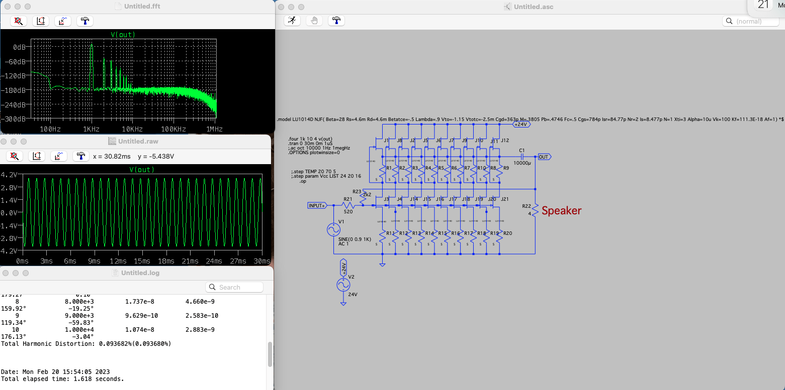

I have it running at 18.11vDC drawing 4.3A 77.90W for a couple hours:
Nelson here is vDS values:
Top FET VDS = 9.58vDC
Bottom FET VDS = 4.27vDC
Top source resistor: 1.968vDC
Bottom source resistor: 2.00vDC
Output cap voltage: 8.15vDC
Likely when voltage is brought to 20vDC there is too much voltage on the upper FET (around 12V?) I think that may explain it.
