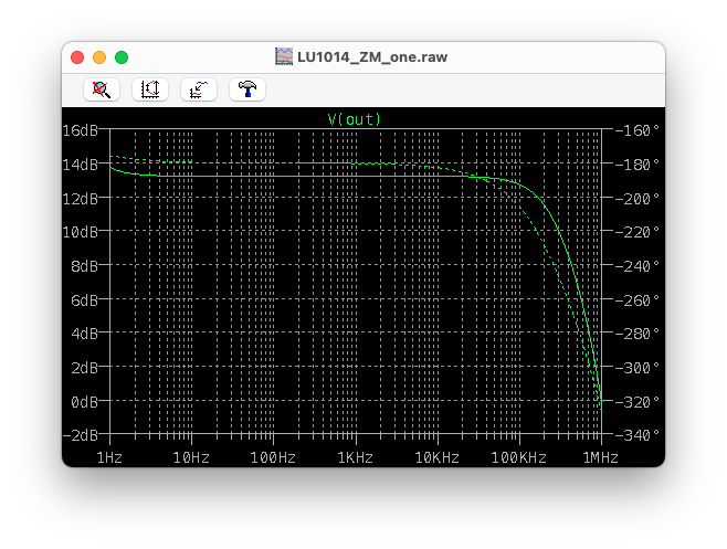

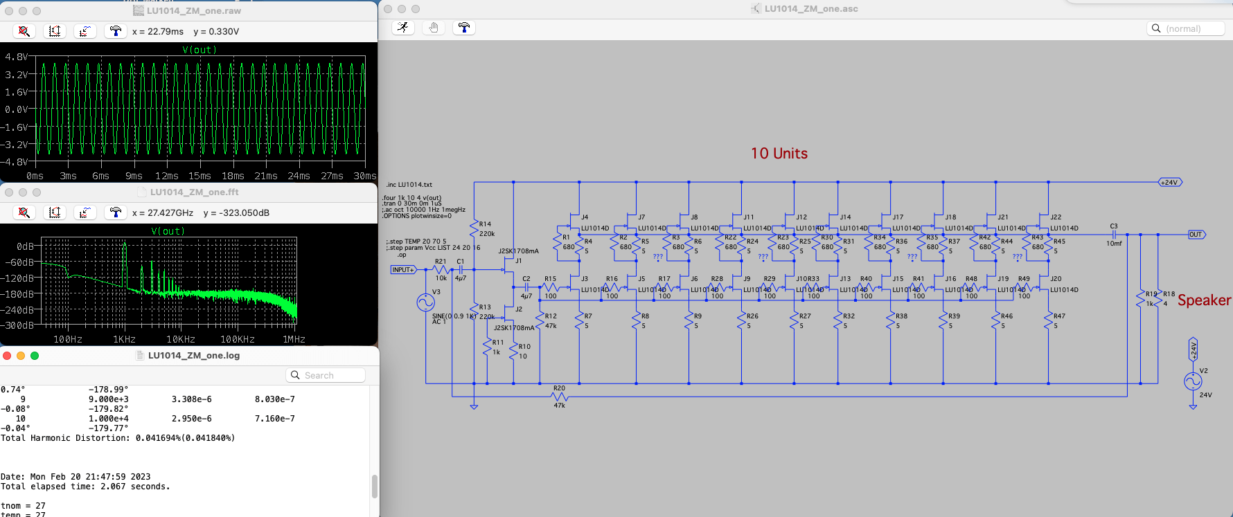

Using LU1014D in parallel for a power amp stage.

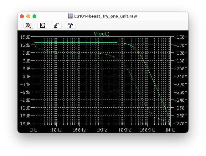

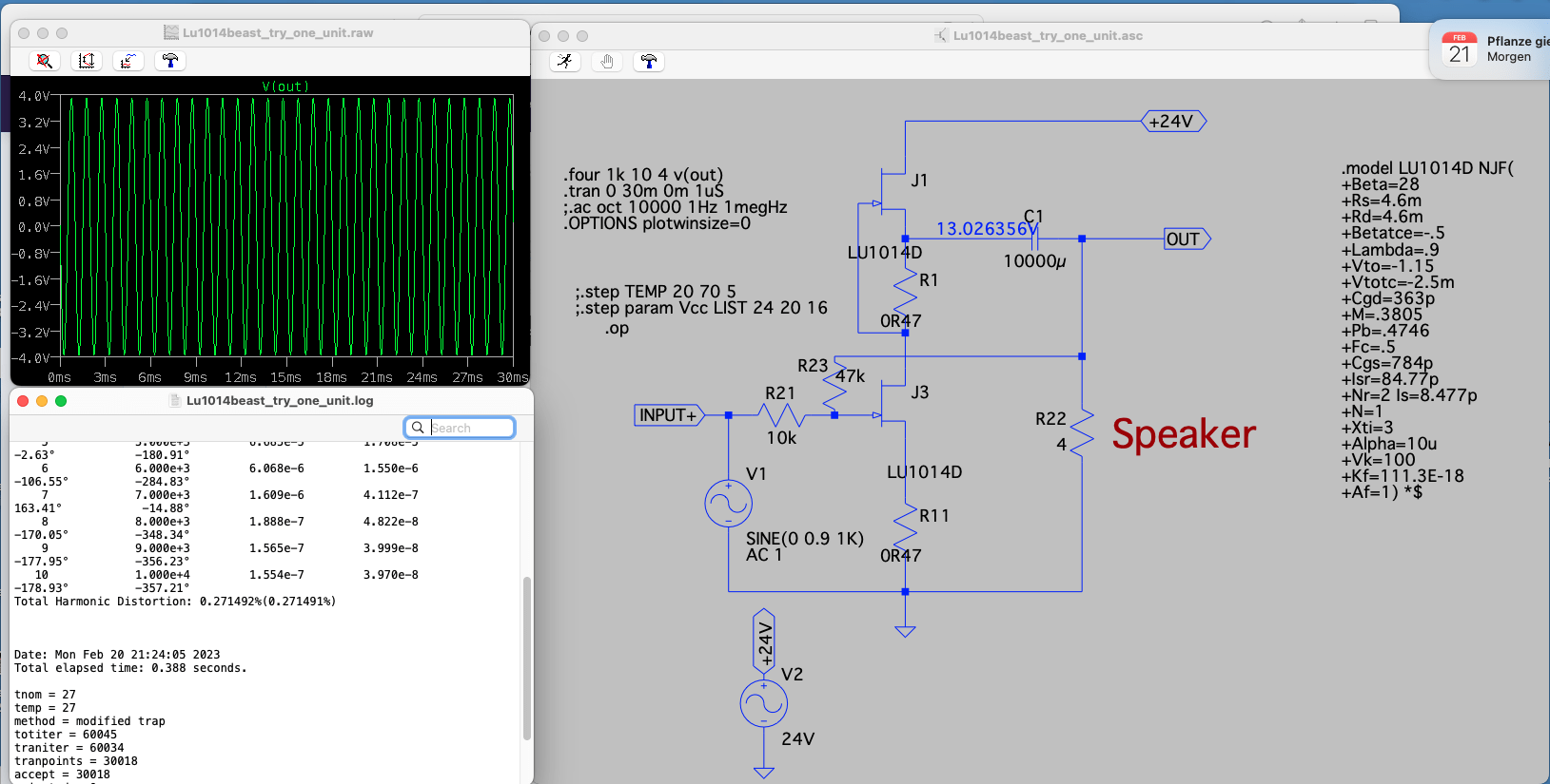

and why has the simple circuit the gain x4 with one unit? lower source resistor?
But I doubt the LU1014 will do the 2Ampere and also the distortion is not as low as shown from Kokorian in the first circuit.
He claims 0.16% at 1W at 4 Ohm but in Spice I get nearly the double value....
replace input buffer with "e" from LTSpice library, set to "1"
that way you'll get ideal buffer stage, and what you get of THD Spectra is strictly from OS
after that, put back this crude JFet buffer, and you'll know its influence in circuit
also, worth trying complementary JFet buffer, cleaner THD Spectra than same sex one

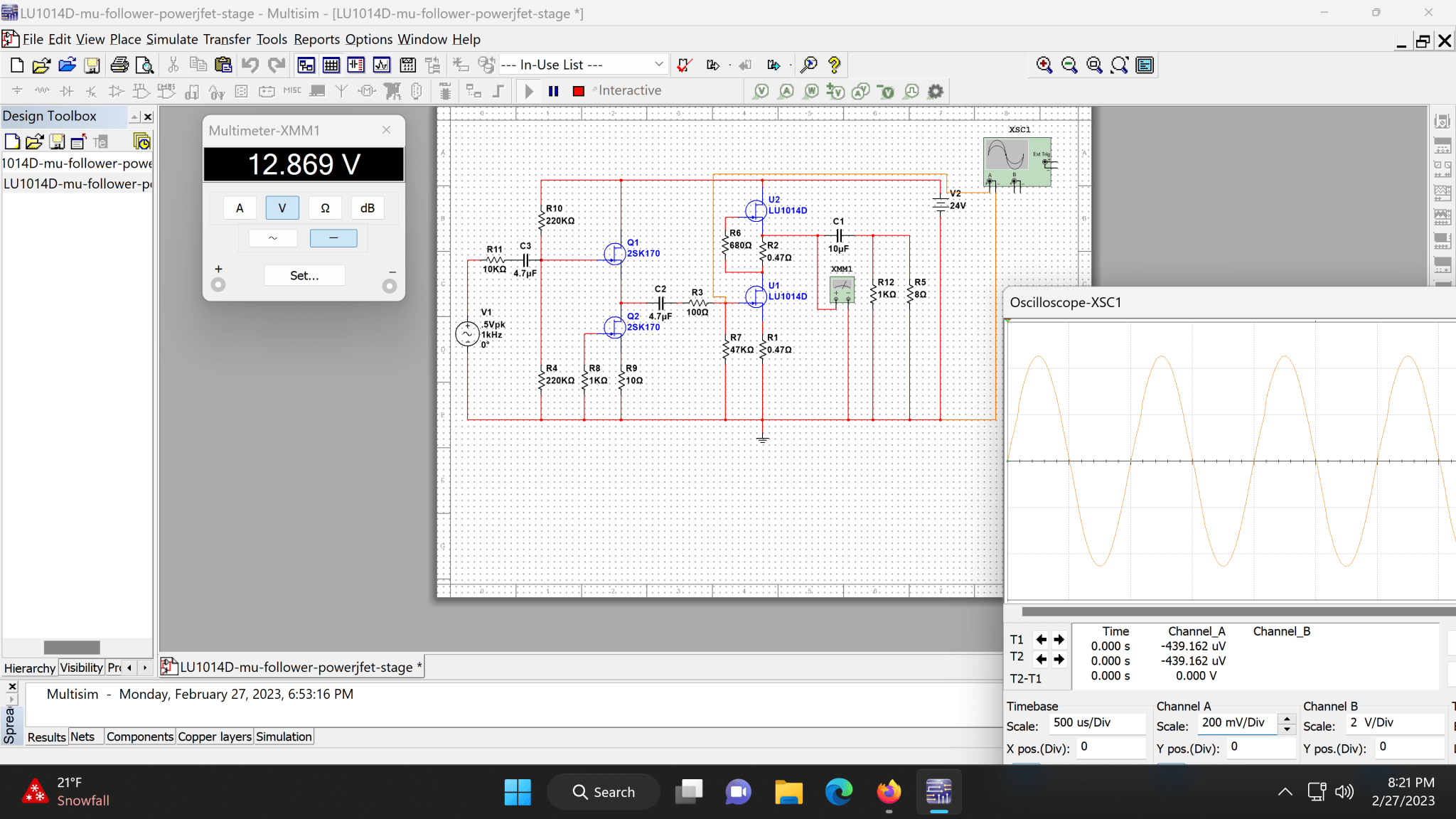

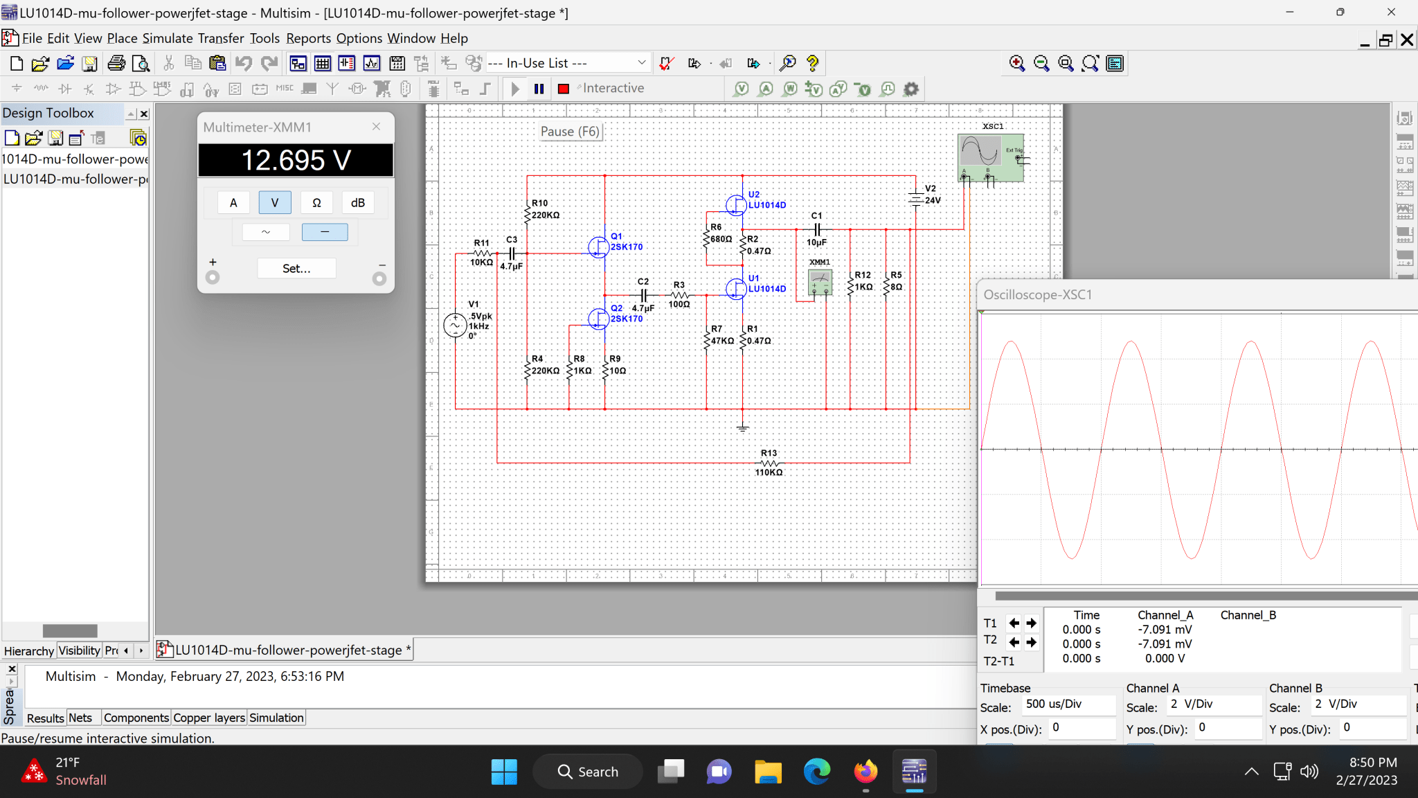

Can anyone help me? I am trying to build the first two stages of the Generg version of this thing. I used Multisim but I am not getting good output like he does for my sim?
Output taken from output stage:
Below is output taken from R3 and R7:
Using "Qspeed" LU1014D model which seem to be official based on file contents.

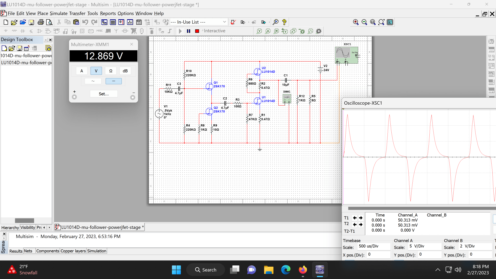

Ahh, I forgot to apply some feedback:
