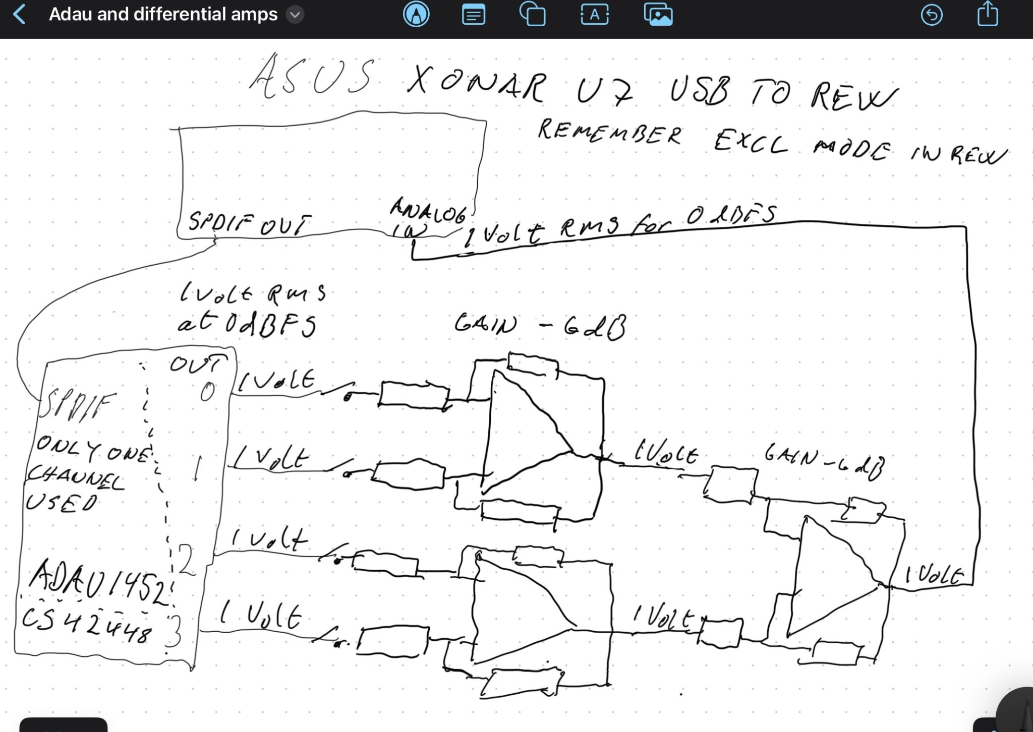

I expected to see the 'good' DAC, the 'not so good' DAC whose distortion you want to measure, and a 'bad' ADC in the sketch. I also expected an amplifier (a 'good' amplifier that adds less harmonics than the DAC you want to measure) with a gain that can be switched higher in the case where you are doing the fundamental subtraction. I assume the ADC is hidden behind 'Analog in', but I see only one DAC box, not two, with a total of four DAC outputs. I also see what I assume are three op-amps with (I guess) differential inputs, two of them fed by four DAC outputs, and one by the outputs from the first two op-amps. Where is the low distortion DAC that allows you to (mostly) only cancel the fundamental frequency out of the DAC you want to measure? Also, all your amps are listed with '-6 dB'. I don't see how that would allow you to gain signal level for the harmonics you want to measure after the cancellation of the fundamental.
I understand the idea, but how to decide that the good DAC is good enough when having only a bad ADC? Especially when harmonics have phases shifted and their vector subtraction can actually increase the resultant amplitude? IMO the standard measurement method with notch filter is OK - REW pre-measures the notch params automatically and compensates its effect during the measurement, reconstructing original amplitudes and phases of all FFT bins.

Thats the differential BB INA2137 I've got. They are -6dB.Also, all your amps are listed with '-6 dB'. I don't see how that would allow you to gain signal level for the harmonics you want to measure after the cancellation of the fundamental.
I do not need to gain signal level of the harmonics. If the fundamental is redused before the ADC the ADC will distort way less. (Until the -60 dBFS distortion is reached) - 18 dBFS and lower in this example

Also the differential stage introduces its own distortions which may not be negligible.
Right right right, because the fundamental that would create the harmonics is suppressed. You would only need the extra gain if you were worried about noise.Thats the differential BB INA2137 I've got. They are -6dB.
But I still don't see the 'good' DAC. If all the DACs are the same, then you are subtracting as much harmonics as you are subtracting fundamental. And that still leaves the clock and phase alignment problem that phofman mentioned to be dealt with.
So, which of the two DACs (I assume the paired outputs are just differential outputs from the same DAC, not really separate DACs) is the good one, if they are all sitting in the same box?
For my setup I need to differenciate two and two outputs to get a somwhat nice sine and low noise. But with better dac and software for DSP you could just use L channel to correct R chanel. Then you also only need one differential amp

No need for differential amp of course.
I was inspired by the combfilter of the 3. harmonic to investigate that a little further. Now using onlo channel 0. So single ended into the two -6dB stages.

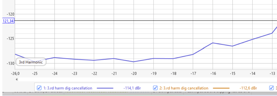

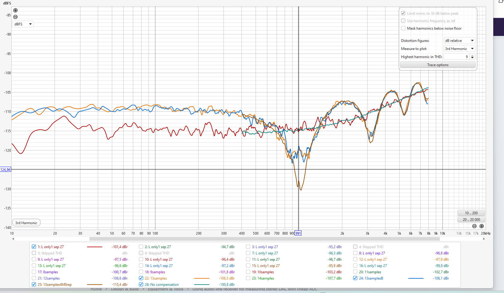

Found the level of 3.rd harmonic at -3 dB signal generator out. Generated" the same" level of syntetic 3.rd harmonics and had a digital differantiator.
The delay of the syntetic 3.rd harmonic was set to 13 samples at 96kHz sampling freq.
Guess what. first dip at around 1 k
Then I maxed out FFT with and repetitions.
Was able to lower 3.rd harmonic about -15 dB when averaging.

That is true, the dynamic compensation of harmonics simply generates sine waves at same amplitude and opposite phase as the measured distortions. While the distortions can be pre-measured at various frequencies and levels and vector-interpolated between these points, it would take many pre-measurements for a frequency-sweep measurement.But can you do it in real time. At the same time as you are doing a sweep?
My understanding was that you could compensate for one level and frequency then use those values to measure one level and frequency
Yet IMO the very same issue applies to the method which subtracts a clean synchronous fundamental - how would you generate a distortion-clean and synchronous frequency-swept fundamental?
Post number #44 #45 and #46 try to mimic that case.Its a
Think I should remeasure that setup with more resolution/averages

2. and 4. is cancelled quite good with balancing. 3.rd can be cancelled with method in #76. But I lack a way to adjust the delay of the syntetic 3rd harmonic, based on the fundametal frequency or the projected estimated value.
I believe the dB value of the third at a frequency can be premeasured.
My measures on my DACs are pretty stable THD dB values up to 1 k. Then they start to rise at different gradients
