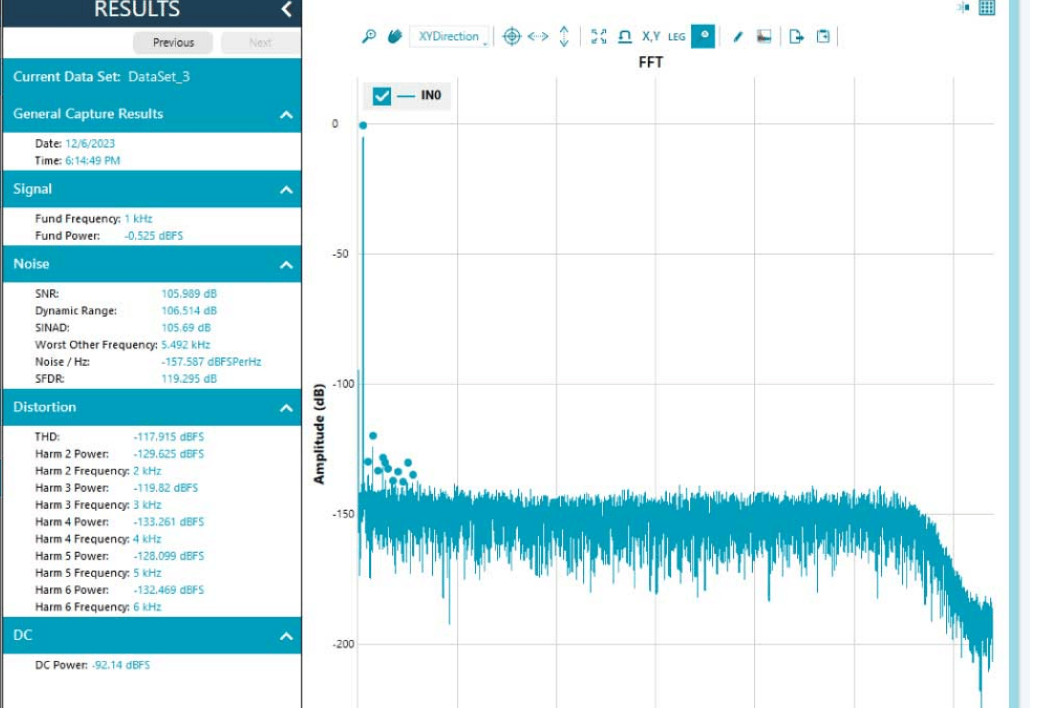

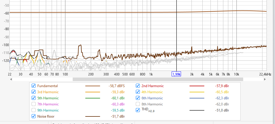

Made quite a few measurements and got to see some interesting features of third harmonic distortion.
This measurement is on a syntetic a*x^3 harmonic. The a is fixed but input is varied 30 dB
We can see that adjusting a with 3 dB is the same as adjusting input by 1 dB. No suprise there.
But it is only until a low level is reached. Then it is not very predictable

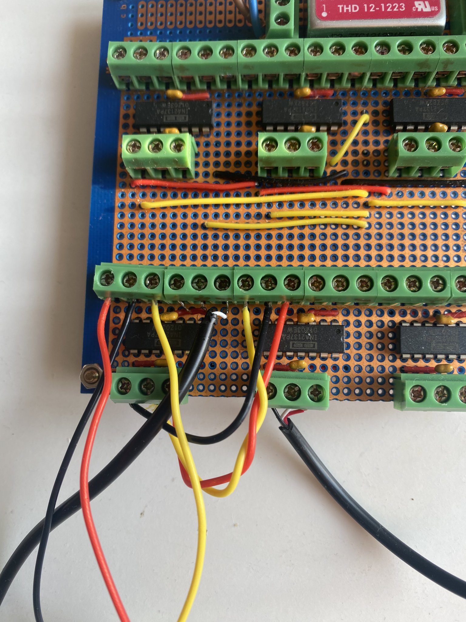

Also put a 3250 HP filter on the input of the second analog diff amp (2.2 nF before INA)
Then a whole lot of action came to display at the different frequencies and levels.
Some of the measurements took a few hours so noise in each frequency bin is way down.
Example of setting:
Code:
Stepped THD measurement at 2,5 kHz
From -10,0 to 0,0 dBFS in 0.1 dBFS steps
4 averages, FFT length 4194304

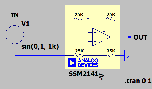

Even if the analog diff amp has quite high ohm feedback (about 20k) we can "see through the noise"
Both analog 3250 Hz filter on 01 and optional digital filter on 23
The syntetic 3rd harmonic distorion is for reference how the analog filter affect the 3rd harmonic.
This is the reference without HP filter and all harmonics
The -6dB - 6dB = -12dB on diff amps helps to attunate the signal before DAC so that really helps to se the DAC distortion and not only the ADC distortion.
The HP filter attunated further, but more difficult to translate the measurement.
Just bought me a clean fundamental😉

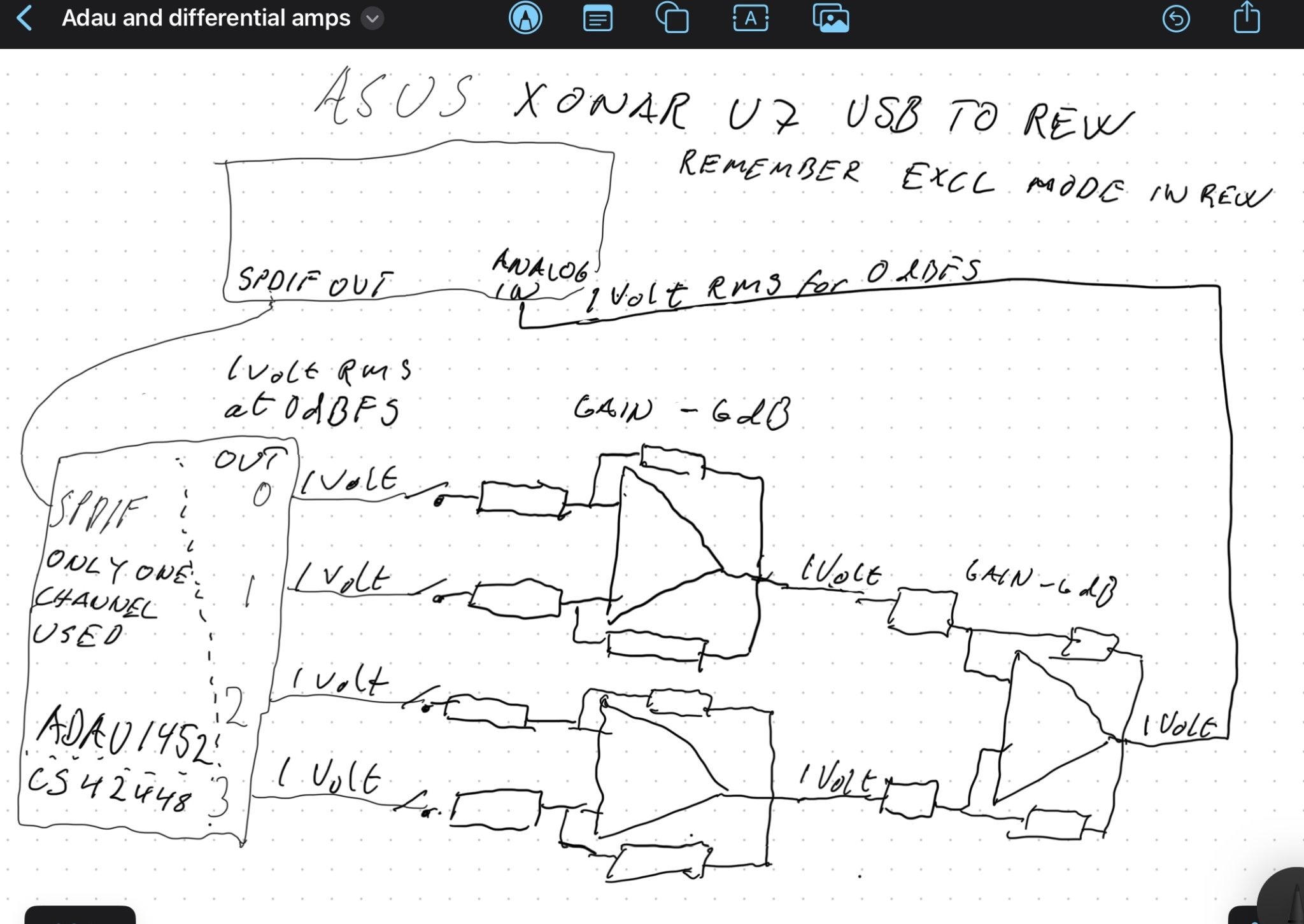

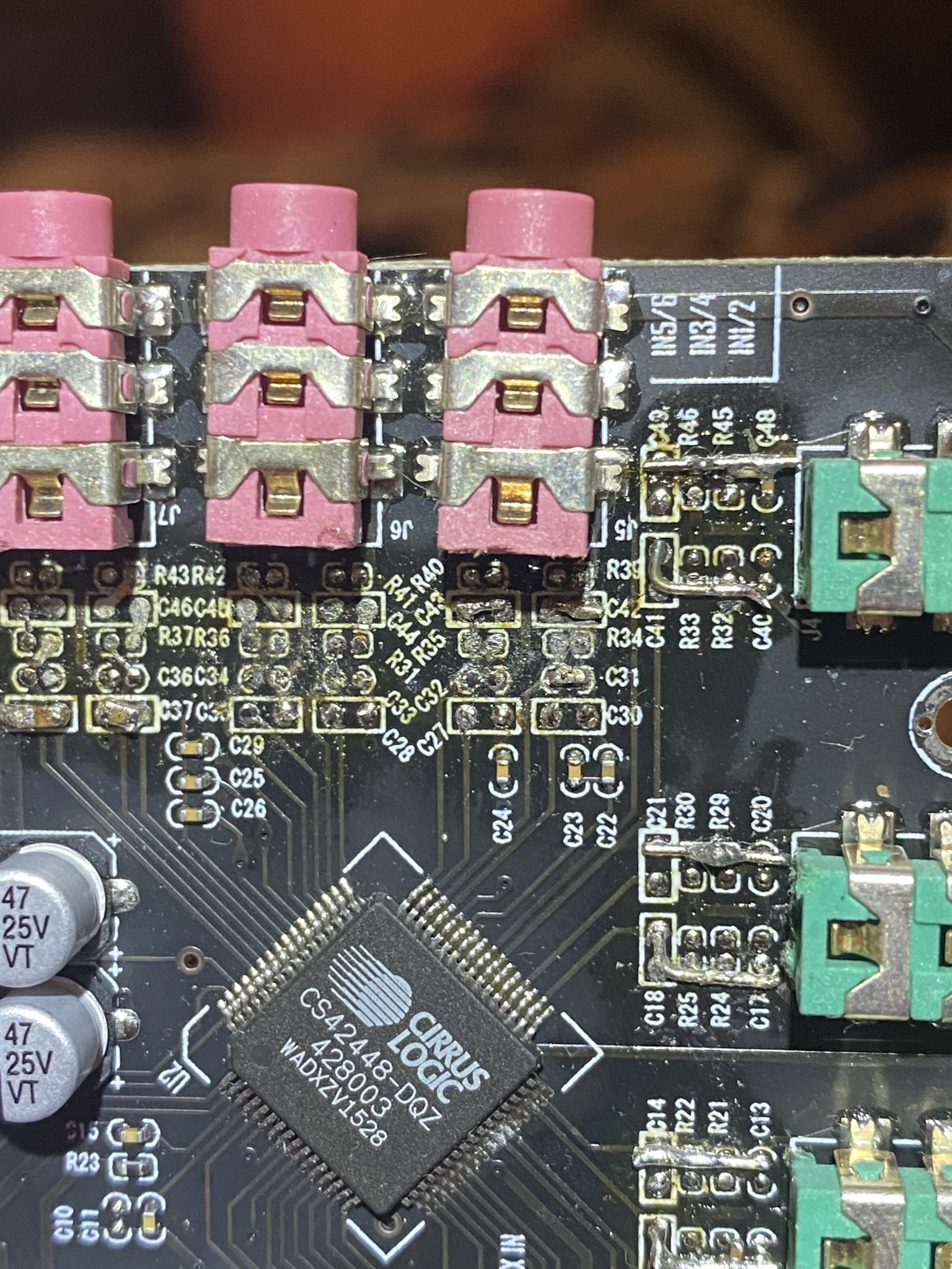

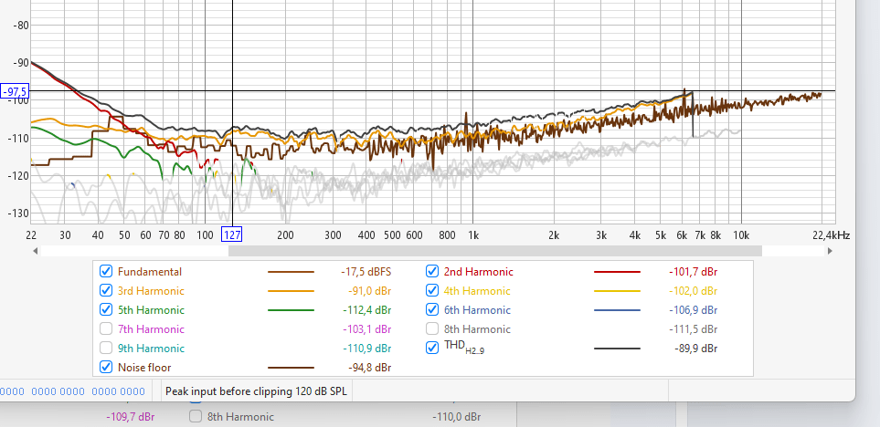

So made some measurements un a SMSL SU-9 PRO into the Xonar U7. No differential amps. SPDIF as input to SMSL
Max resolution on REW
Noise floor 4M 8averages
Distortion, THD 0-9, at -4dBFS and 6dB steps down to -22dBFS
There is really something to gain for distortion measurements by decreasing the ADC input.
Don't have access to daily setup so can't make any subtractive measurements for some days.

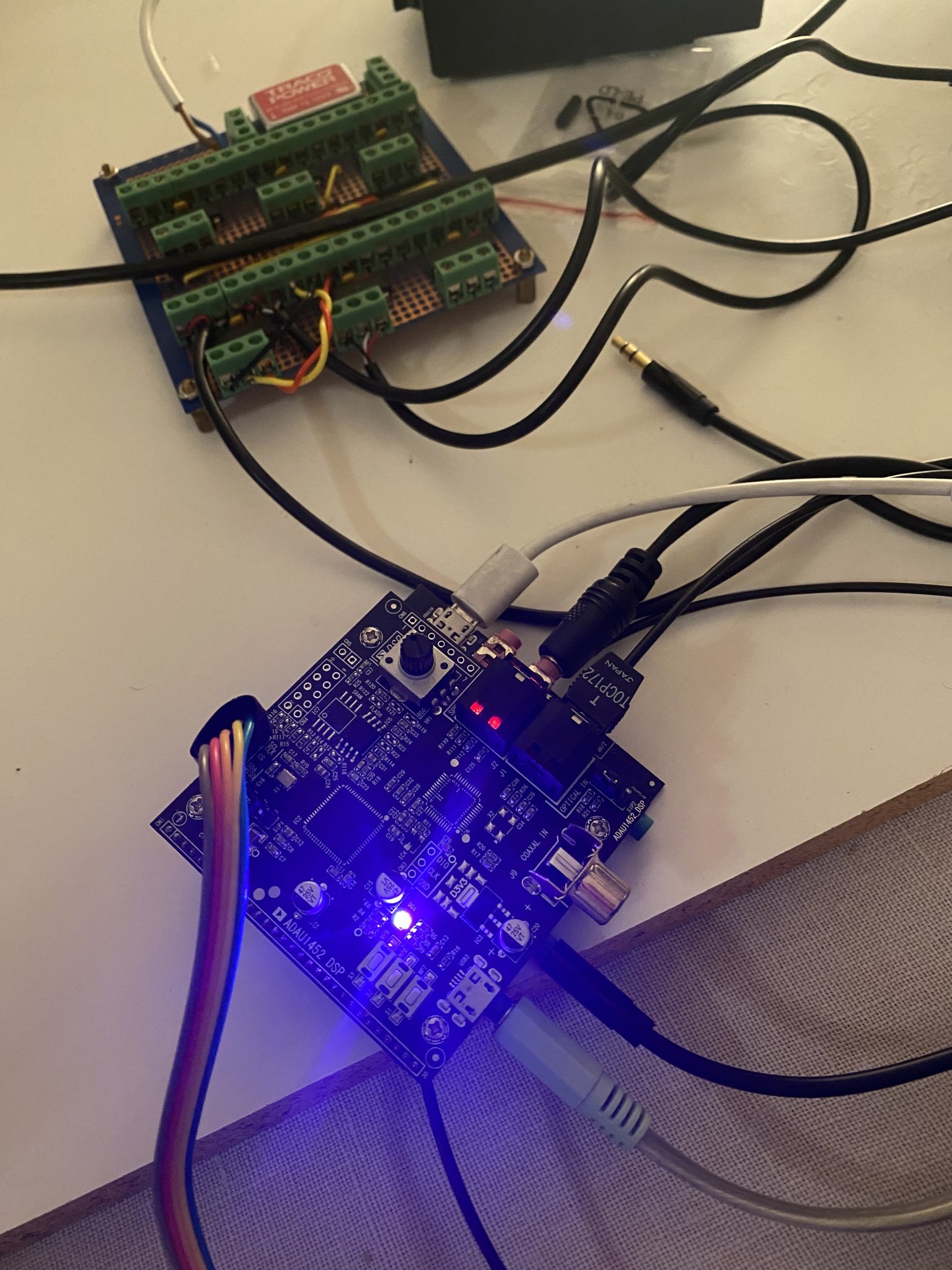

Back to the setup with the -6dB + -6dB gain differential amps.

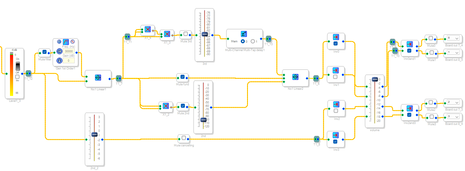

Source is the CS codec card stripped of the output filter and ADAU1452 as the TDM source,
Output 0 ad 1 are sent to differential inputs, output 1 inverted.

1. is CS DAC as above. -1 dB from generator. So -6dBFS into ADC
2. is clean fundamental (SMSL DAC) time alligned down to closest sample.
3. is CS DAC inverted and clean fundamental (time alligned) into differential amps. So fundamental is down max about 40 dB compared to the two sources.
The fundamental is under -20dBFS up to 5k. The common mode rejection is bad in HF because of not perfect time alignment and a 6 dB/oct 13kHz analog LP filter after the SMSL DAC

Just a comment on the repeatability on the setup. This is using a ADAU DSP to make the delay for the perfect fundemental.
.It is SPDIF copied as input the SMSL DAC.
The codec 01 outputs on the CS board are delayed about 675 samples.
But since it is real DSP with TDM out the dalay is the same every time. No dalay variation ever. The prosessing are deterministic. Unlike some linux DSP setups
