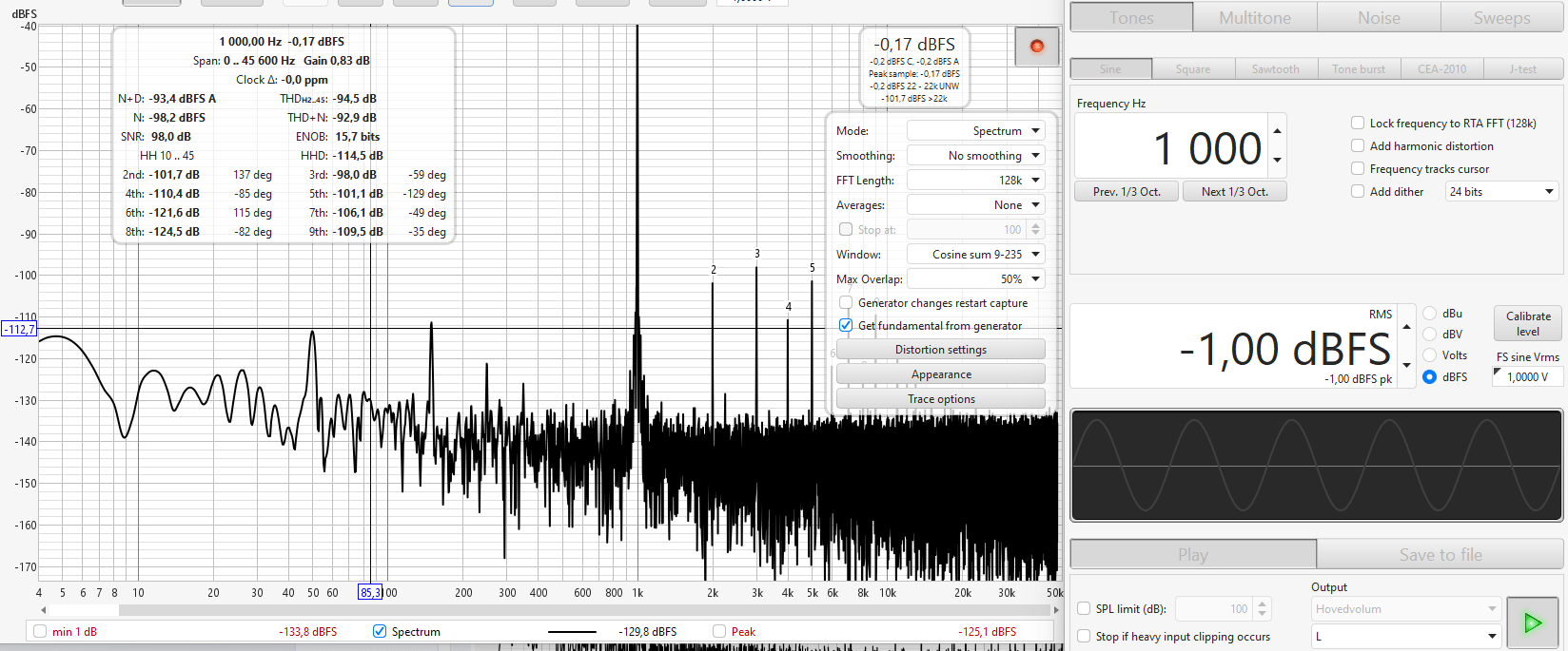

See REW can measure THD pretty low by expanding the FFT size or maesurement time and averaging the noise away.

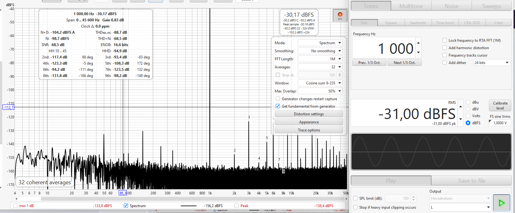

For the record. the above graph is a 13 euro cirrus logic card fed with USB power. Passive output filter on codec card is removed. But 4 channels used. First two and two are balanced. Then those are again balanced to single ended. -6dB gain in both stages. Fed from spdif in in ADAU1452 card and TDM 96kHz out,

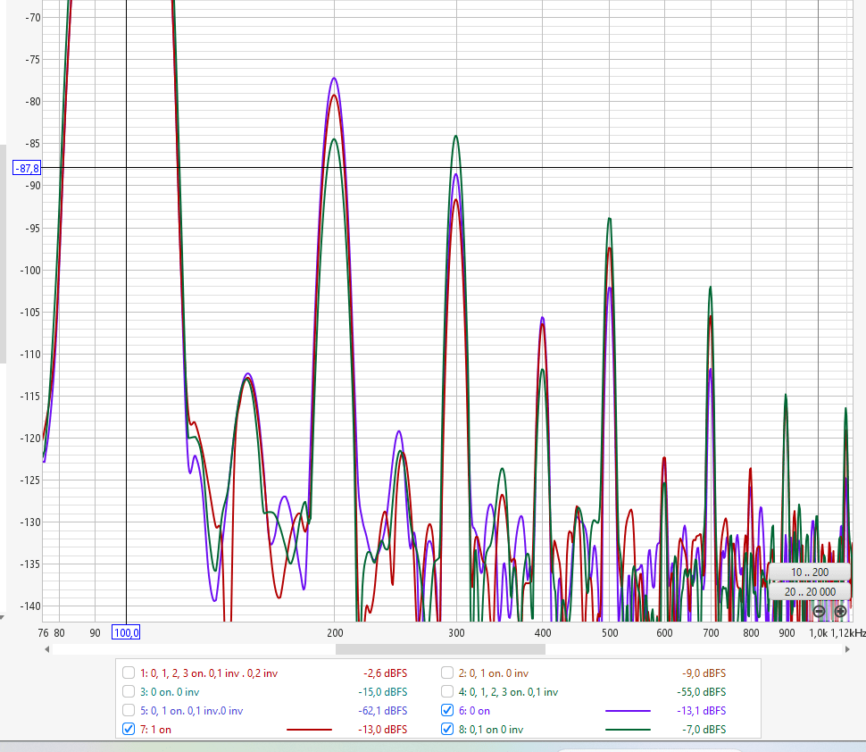

But I was not able to propperly cancell second harmonics caused by passive filters on dac output. Maybe because the distortion was different in amplitude on the two channels https://www.diyaudio.com/community/attachments/1726083576827-png.1355200/
Yes you were right. REW is within a degree fault on phase when amount of distortion is higher.
The whole reason for little cancelling was different amplitude (2,5 dB) on second harmonics on the two channels. (The fundamental was spot on amplitude)
Lucky I got a board in the post today, so I could control measure with output filter.
Without filter the codec card distorts much less and the second harmonic is more or less the same on all channels. So then balancing functions for removing 2. harmonic

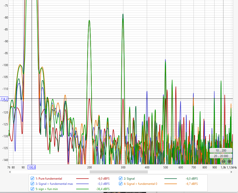

Now we put one of the good DAC channels on one input of receiver and the mediocre dac at the other. We adjust volume to be the same for both.
I want to test at 100Hz so but 100 Hz into mediocre DAC. Then i put close to 100 Hz into good DAC. Maybe 99.99Hz
Then i get a beat and cycling betveen cancellation and amplification. That is sum and difference.

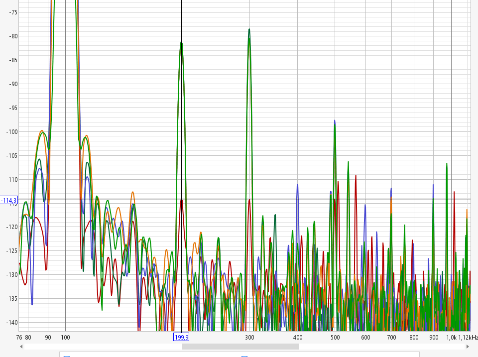

These two pictures show some measurements. Cursor at 100 and 200 Hz.
We se the harmonics are fairly stable so it must all come from the DAC and not the ADC. The ADC would else add to the distortion at when difference is larger than signal and distortion should go down if it is smaller. Actually the DAC is very little loaded at max cansellation.
Cursor 100 Hz
Cursor 200 Hz
If mediocre DAC was better than ADC we should see the distortion level at max cansellation as the DAC then distorts minimal. About -30dB less fundemental in this example. But we could never measure better than good DAC
