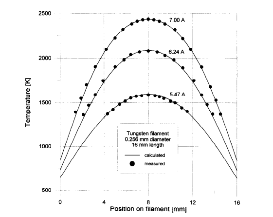

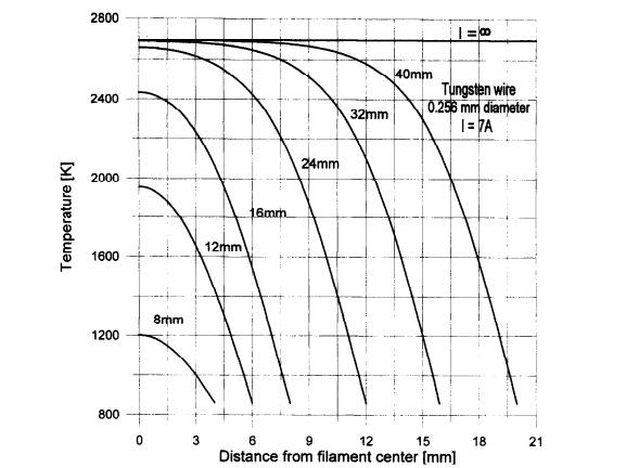

Indeed, to phrase it in a more rigorous way: temperature is an INTENSIVE parameter in thermodynamics. That means that it is the same everywhere in the body (filament) in STATIONARY conditions (which is the case of heating the filament/heater of a tube with DC or periodic AC) and so, being the emission regulated by temperature, there is no variation of emission due to voltage gradient. There is a just a cloud of undistinguishable electrons around the cathode/filament.The filament rate of emission depends on the temperature of the filament material, and this temperature is a function of the current and resistance which don’t change along the length of filament with constant cross-section. There isn’t going to be any variation of emission along the filament due to the voltage gradient.
Just a to be precise, when I am saying temperature is the same everywhere, I mean and ideal case and that it does not change due to the voltage gradient. The applied voltage only impacts on the current flowing into the wire. Rather, the temperature will depend on the geometry/size/material. For the simple case of a single straight filament with DC supply from end-to-end, temperature is max at the center and lower at both ends! Symmetrical distribution, nothing like the voltage gradient. See picture on the left where it's case of a rather short wire. The longer the filament the more uniform and sharp temp becomes along the wire (picture on the left). It is the same everywhere for the "infinite" case.

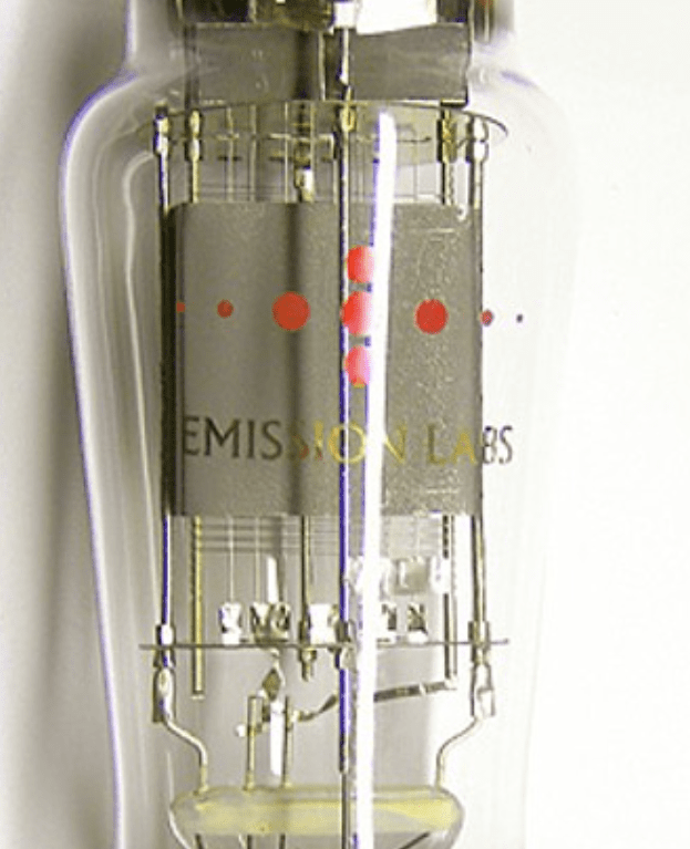

Looking at the pictures of EML tubes they seem to have multiple wires in parallel rather than 1 or max 2 wires running "along" the plate and folded over 1 or more times like the typical W-shaped filament or a single very long filament folded over many times and inserted into the cathode for indirectly heated tubes (to get them as practically long as possible). Still, given the large size of EML tubes those wires are surely much longer than the 16 mm wire showing temperature gradient and in the case of smaller plate tubes, like the EML30 or 20, only a fraction of the wires (the central part, where temp is uniform) goes into the plate.....

The filament rate of emission depends on the temperature of the filament material, and this temperature is a function of the current and resistance which don’t change along the length of filament with constant cross-section. There isn’t going to be any variation of emission along the filament due to the voltage gradient. In practice, there will be variations in the filament temperature due to different rates of heat loss from the filament along it's length, e.g.- the ends will be in contact with colder supports. For the purposes of this thread though, the emission can be said to be uniform and constant along the filament. Think of the case of a series string of identical power resistors, this will all have the same power dissipation, and in the same environment the will all reach the same temperature despite having a voltage gradient along the string.
Where the voltage gradient has an impact on the tube is to create a gradient in the filament-grid bias because the grid is at an equipotential (it should have a negligible voltage gradient of it's own) . This bias directly controls the cathode-plate current and the dc voltage gradient along the filament will result in a variation in the current flow between the filament and the plate depending on the geometry of filament-plate. This would happen with AC heating too of .

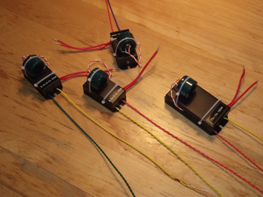

On another forum (can't remember at this moment) there were threads about using 'dc transformers' aimed at 12V halogen lights which they opened up and changed the number of turns on the output transformer to match the filament voltage. These are usually working at just above the audio range and most of the fellas also modified the unit to push the frequency up a bit more. They produce some ugly waveforms but those who tried them said there were no issues with the sound at all. I bought a couple of these cheapo units to try out but they are waiting in the project queue......

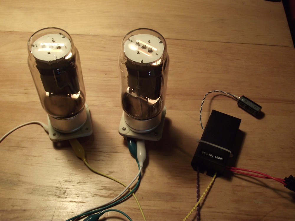

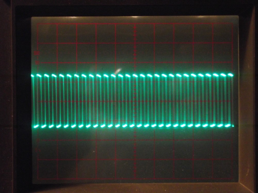

It seems nobody bothered to read the solution mentionned in post #5 at the very beginning of this thread. I have gone this route and it is much simpler than the convoluted contraptions I see around. I have built a few, both for me and for a friend, and they are dead silent at all power levels, be it in DH or IDH filaments. Silver-plated wire secondaries for DH filaments please 😎
I used a simple input capacitor to reduce ripple but in my next project I'll be regulating the HV upstream of the "electronic transformer", allowing super stable filament voltage and no need to rewire the transformer secondary by adjusting the input voltage at the regulator.
