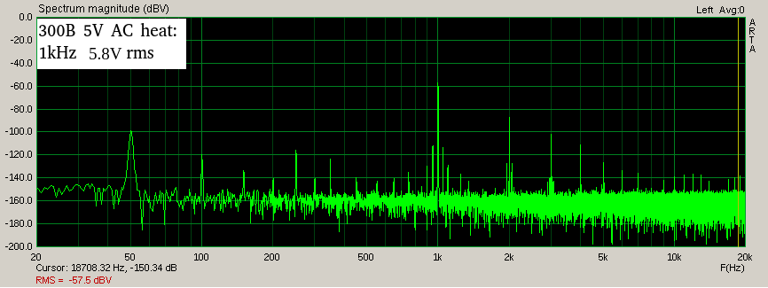

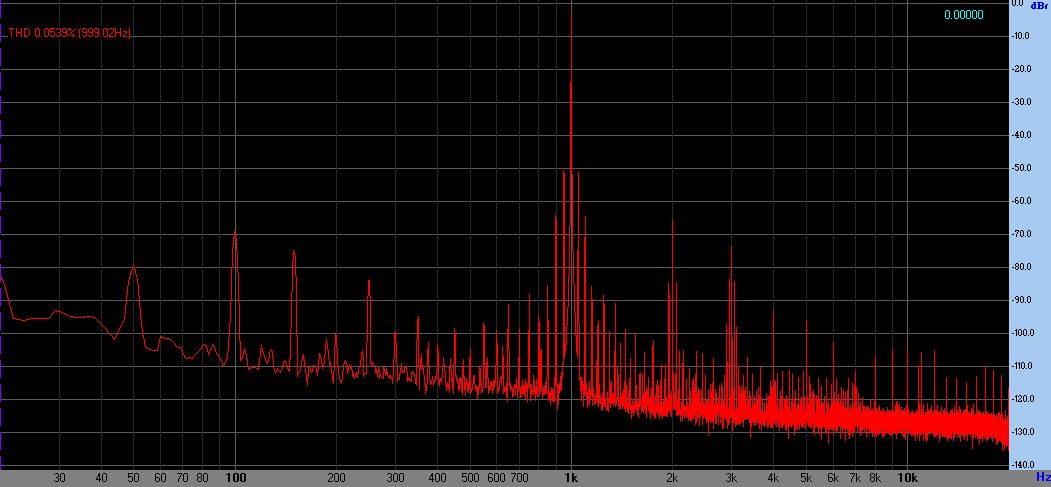

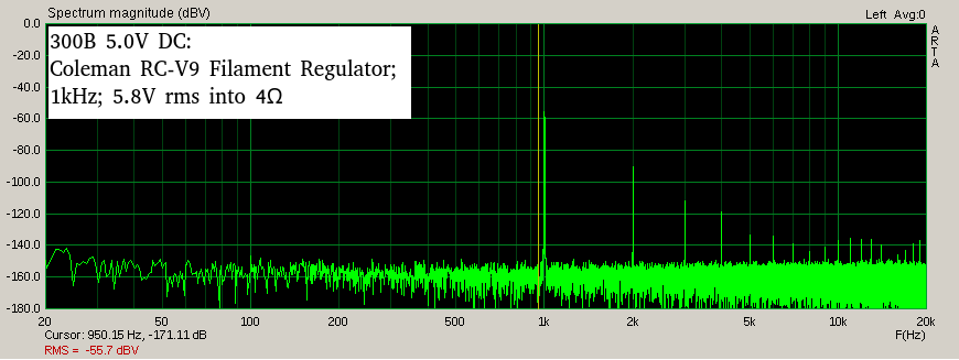

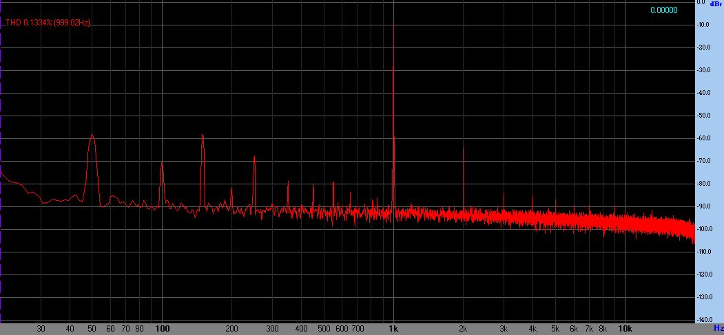

As for the difference in performance between AC and DC heating, it is not so well illustrated in the tube curves, as with the output spectrum of a real amplifier.
To keep the testing fair, these plots were taken on the same day, with the same amplifier, same EML 300Bs. Only difference is the the one is with AC heating and the usual 2x 33Ω resistors from each end of the filament, and the other is DC heated with my RC-V9 regulator. The scale is in dBV, so you can see that the noise floor is quite low enough without the resistors.
In the case of AC heating, the intermodulation distortion is shown by the spurs on each side of the 1kHz signal, and its harmonics at 2, 3, 4 ...(etc) kHz.
Intermodulation with 50/60 and 100/120Hz is of course completely alien to the original music signal, and does not fit in with my idea of 'high fidelity'.
The noise floor of the amplfier here is very low: the anode supply uses large capacitors followed by a capacitor multiplier.
With the AC heat sample, the 50Hz fundamental can be reduced with careful nulling; but the IMD remains in all cases.
