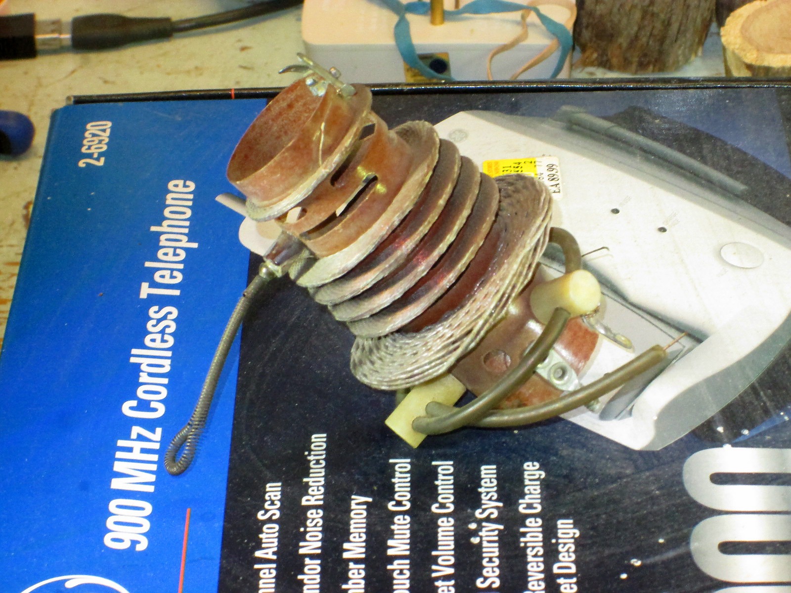

Just after the Earth cooled some people did use Ultrasonic Oscillators to heat tube filaments & heaters.
I've still got one of the specially constructed coils used. The circuit used a 6L6. I'll post a photo later. (y)
On this one it looks like I'm SOL. During the Autumn of 2019, just before COVID I decided to unload some of my stash.
I'd just turned 87, I'd been wondering what to do with my stuff. My heirs & successors have no idea what this is.
So a few boxes went out the door to a friend who runs a small business restoring old radios & auto radios from
peoples project cars. The device in question may have been in that lot.
I did find what looks like an early HV TV Flyback transformer.
But I do recall several articles published during the 50s describing circuits to heat some of the tubes of the day.
A single 807 running as a Class C oscillator is rated for 40 watts of output. That would easily heat a pair of 2A3s. (y)
