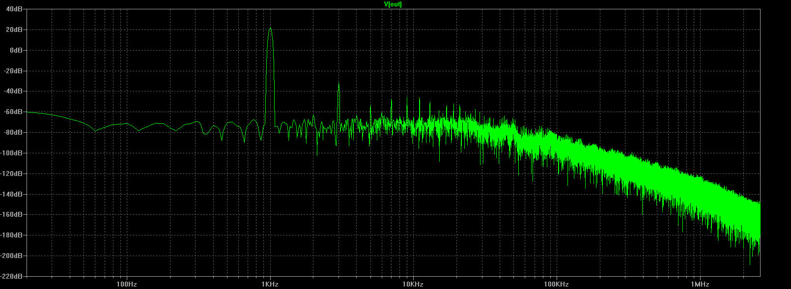

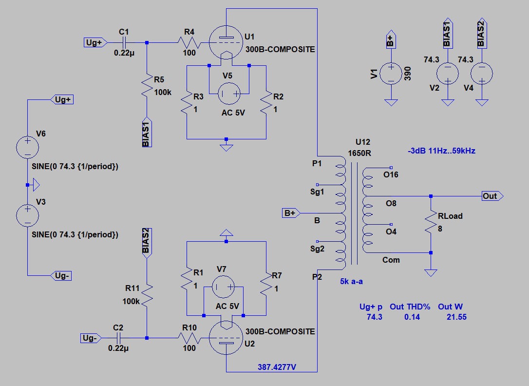

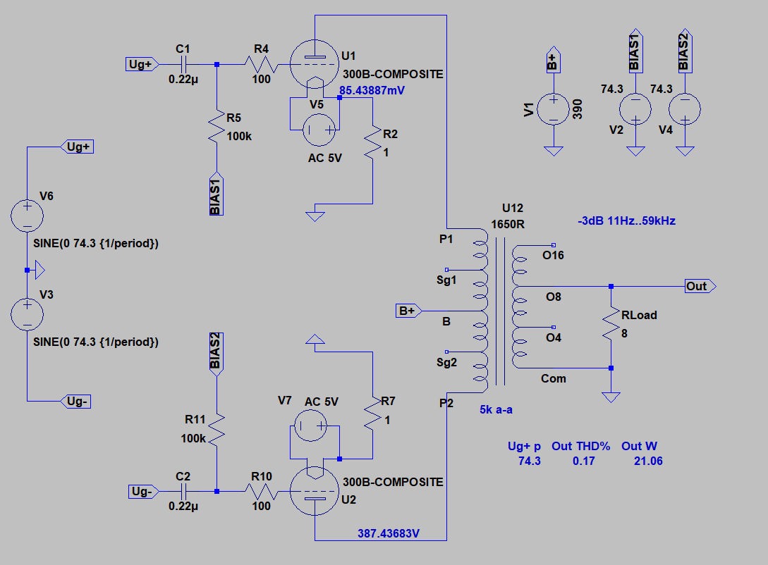

The plot posted by @euro21 shows no sign of cancellation in this case.Rod I think for PP amp with a CT sinewave drive on each tube you will just get 2nd harmonic both outputs in phase which will cancel at the OPT
So it's probably easier to just measure the proposed circuit and see.

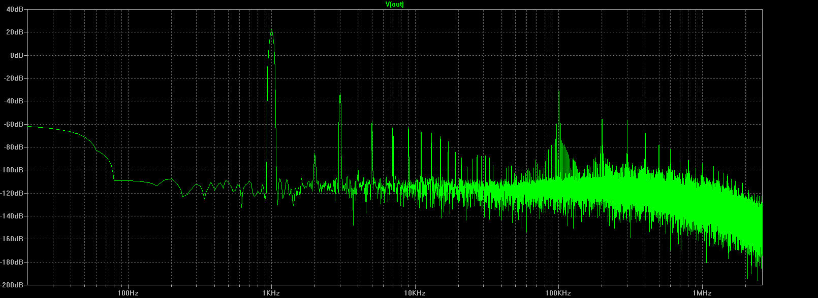

I agree that square wave heating is much worse than sine wave for near-field coupling, and also for conducted emissions running back through the mains; a potential coupling into the DAC and its oscillator. (My DAC oscillator runs from two stages of regulation, including a high RF rejection stage, and a separate winding for the PT. I am certain that this is worthwhile, even without big noise generators nearby).
Yes by the time you get to 2x100KHz the OPT windings will no longer be in anti-phase, so you may well get reduced cancellation. The conducted emissions back through the mains needs the same treatment as any SMPS. The problems at the output side are much easier to deal with than a class D amp, where you have PWM many tens of volts into a LPF before the speaker.
OK I assume the 300B composite is a number of tubes. If you swap the +/- of the bottom AC source you will get different results. What I would be doing is CT the heater source with the 1R on the CT.

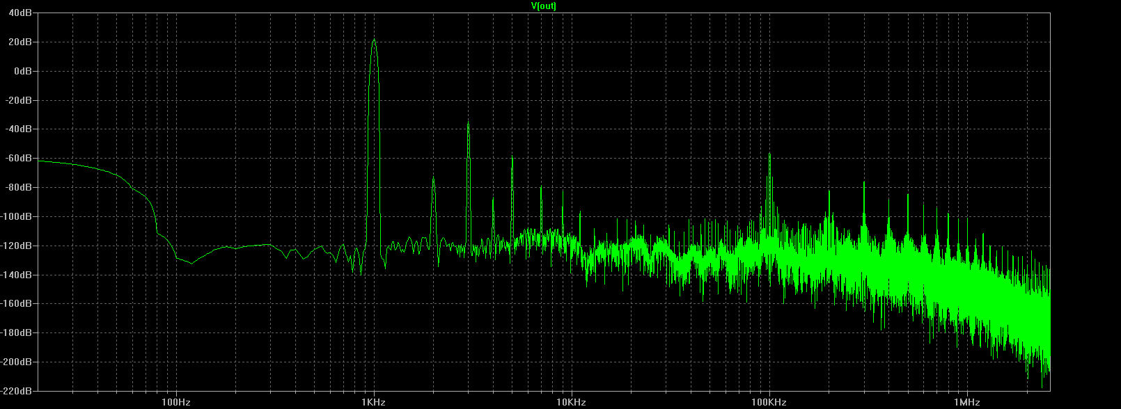

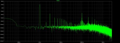

Ideal transformers don't exist. You have significant capacitance, leakage inductance and imbalance to deal withSome simulations:
300B PP with 100kHz sine and 100kHz SQ filament.
View attachment 1298847 View attachment 1298848

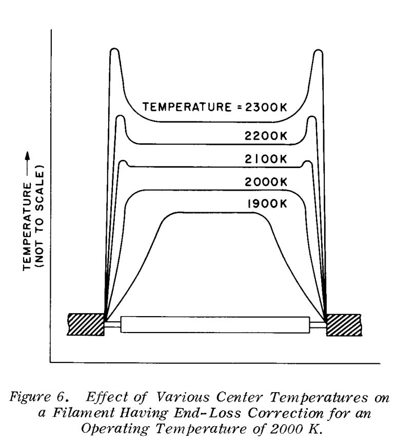

When powered by DC, the emission current along the filament from the negative end to the positive end is not uniform due to the grid-to cathode bias gradient along the filament structure. That is, on an example DC-powered 7.5V filament, one end is at -3.75V compated to the center, and the othe end is at +3.75V. The more sensitive the tube is, the larger an emission current gradient along the filament will be. The more negative end will wear out first.
When a tube that is sensitive to this effect, such as when the filament base material can deterioirate and increase resistance or become embrittled and fail, and the tube cost hundreds of $ and up, or is hard to get, then it's best to run AC on the filament. The only choice is the frequency to be used.
When DC is not avoidable, the advice is to periodically reverse the DC polarity on the filament. I can not recall right now where I read this, but it was in a power tube manufacturer's book or data sheet.

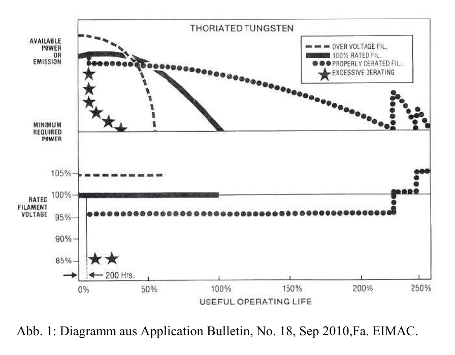

Running higher OR lower by only a few % of Vf(nominal) destroys the lifetime of the filament, as this Application Brief for EIMAC shows only too clearly:
It shows that without regulation, the filament voltage must be run at 100% of rated voltage, becuase Line dips do more damage than rises.
But regulation to 1% (preferably) up to 3% allows operation at 95% of nominal voltage, which more than doubles the lifetime of the filament compared to 100%.
The idea that skewing of the filament current from DC heating reduces filament life has been debunked - with evidence - in this thread. Please have a look, especially noting the temperature plots posted by member @45 .
Overheating or underheating of TT filament may generate unevenness of temperature distribution via the wire.
The moderate temperature variation manageable, severe overheating may sooner or later will degrade the filament.
Underheating -if it is significant- not recommended for power tubes, the emitting surface may drastically decreases, the extractable power too.

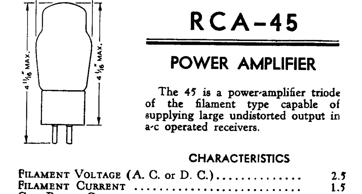

In 45 datasheet posted all the typical configuration of amplifier are listed with ac filaments and not dc

RCA data sheet for 45 indicates AC or DC. But tht does not mean anything about the lifetime - especially with today's tolerances. ±10% on AC mains will give short life if it gets that bad during use.
