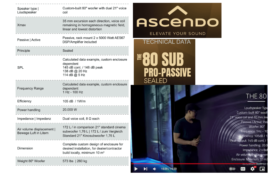

And if you want 47 or 172 liters of displacement with one driver, Ascendo has a 163kg 50", 105 dB at 5 Hz, and a 260kg 80", around 114dB at 5Hz.
Pricey drivers, but that's a "whole lotta shakin' goin on" :smash:

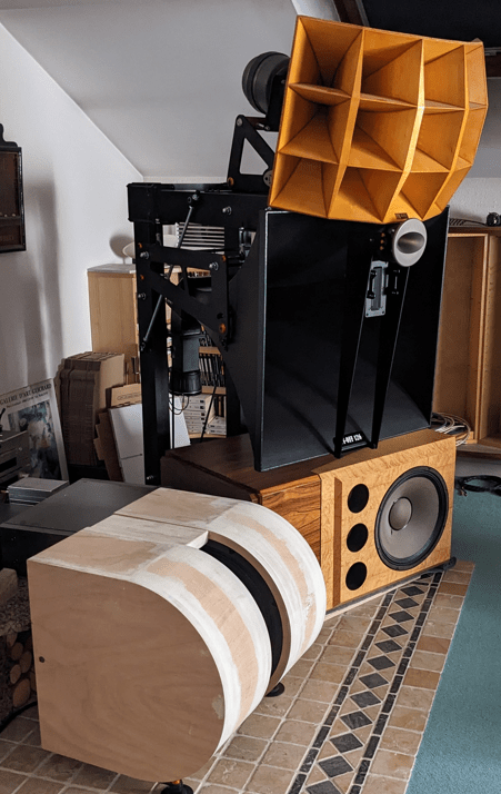

... For infra-bass extension, I built my Omega Ripole subwoofer :
It is a compact unit, able to reach 15Hz in a 400x400x440mm package. I use it below 40Hz, under the natural extension of my speakers.
This is perfect for EM of any kind - notably Space Ambient - where there is deep infra-bass content. The Ripole principe generates that floating bass, without any boxy tone of focused resonance... But OK, for explosions, gun noises, crashes and all other huge-boomy noises common in Home Theater, it may not be the best solution !
Very nice ripole sub! Are these 15" drivers? I'm also fascinated by the ripole principle. ...
Apologies, I'm responding late on this.
Compact folder dipoles (of which so-called Ripoles are a subset) are fascinating, but I don't believe they are a practical approach for infra-bass extension, because the driver volume displacement would need to be enormous. Siegfried Linkwitz, who did much to develop and promote compact folded dipoles, created a spreadsheet to calculate the maximum SPL available from a given dipole configuration. It's still available at Linkwitz Lab - see here: https://www.linkwitzlab.com/spl_max1.xls
I entered the numbers for the Ripoles built by @tubelectron (i.e. a pair of Beyma 12BR70 drivers, with a path length estimated at 450mm). At 15Hz, the excursion-limited maximum SPL will be around 67dB at 1m. That's not just quiet, it's below the threshold of audibility (which is above 70dB at 20 Hz, on the ISO 226:2003 contours). What might well be audible, though, is the harmonic distortion. For example if there's fourth harmonic around 3%, which there could easily be at maximum linear excursion, that equates to around 37dB at 60 Hz, which probably is audible.
Folded dipoles are well worth exploring, but the physics means they are best suited to the 'regular' bass range, say 30 Hz and up.
