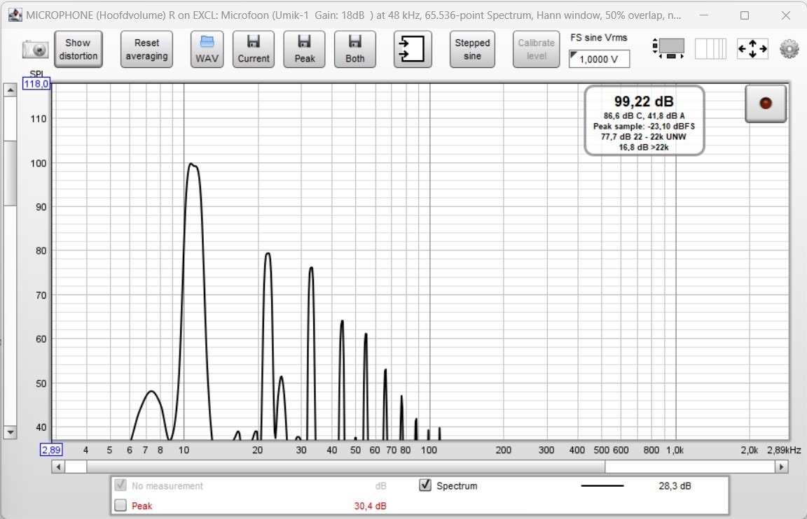

In the meantime I did some REW RTA measurements @11Hz on both my subs and this was quite revealing. The older sealed 4x 15" Visaton TIW400 clearly distort when pushed a bit harder. See attached picture. Also the port noise on the B&C 21SW152 LLT was quite obvious also @11Hz but the harmonics were quite a bit lower what IMHO explains that they can't be localized despite they're close to the listening position.
So I decided to go all sealed subs with a QTC between 0.5-0.6. For extra headroom and less distortion I bought 2 additional SBAudience NERO21SW1100D and I'm currently building a heavily braced 407L/14cuft sealed enclosure. The B&C 21SW152 will also be converted to sealed with about the same QTC. All 4 will get a slight boost to get the desired infrasonic reproduction.
The second harmonic of 22Hz is more than 20dB down from the 11Hz fundamental, less than 10% total harmonic distortion. Under 10% THD is generally considered good, though listening to sine waves makes THD easier to hear than with music or LF effects.

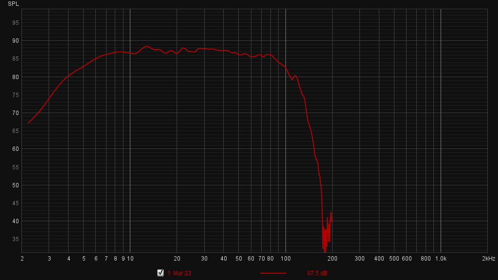

First room calibration with the standard Audyssey gave good results although the infrasonics that I used to feel with the LLT B&C were not there. I gave the MultEQ app a try but this didn't bring substantial improvements. Up to the next step then.
After ordering and receiving the Audyssey ACM1-X calibrated microphone I downloaded Audyssey MultEQ-X and bought the license. The calibration went smooth with an extension just below 18Hz in my room what confirmed my earlier observations.
For the extra infrasonic push I added a peaking filter to the subwoofers. For now I've settled with a PEQ @12Hz with a Q=3 and a 10dB boost. This falls just outside room mode territory and avoids too much boost under 10Hz.
So far I like what I'm hearing. Stress tests with higher SPL levels show no audible distortion. When I have more time I'll do some measurements in REW so I can do more fine tuning 😉
