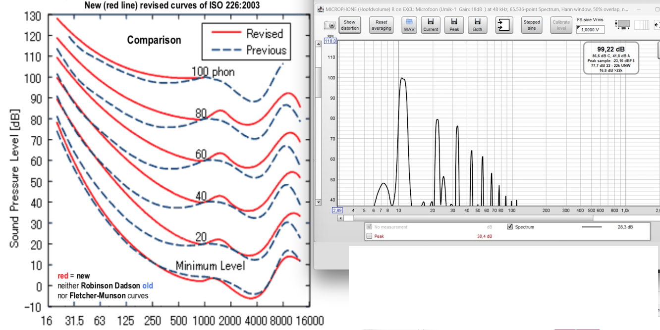

Which might be what you are hearing. Post #22. My normal listening levels are circa 70dB. Link to the imageThe harmonics are there but exactly @ 22, 33, 44Hz and up.
https://www.diyaudio.com/community/attachments/subwoofer-1-rta-11hz-jpeg.1154978/

The fundamental frequency 11Hz is called the first harmonic, multiples up to the 11th harmonic at around -40 daB from the first harmonic are visible. The second harmonic being more than -20dB (THD of less than 10%) indicates the drivers are at or under Xmax, not near mechanical limits.REW has a generator on board and if I select a 10Hz tone and the microphone records 10Hz with a 100dB SPL this should be a harmonic? I'd like to refer to post #22 which was an 11Hz tone in REW close to the speaker. The harmonics are there but exactly @ 22, 33, 44Hz and up.
At 100dB, the upper harmonics of 11Hz would be more audible than the fundamental, comparing the harmonic distortion curve to equal loudness contours makes this visible, the third harmonic (33Hz) at 75dB is just a bit above the minimum "hearing" perception level.
That said, the transition between "hearing" and "feeling" varies by large amounts between individuals, the ISO 226:2003 is just an average of normal hearing people. The 10dB "twice as loud" perception at 1kHz drops to less than 5dB below 20Hz, so relatively small increases down low make more audible difference.
@weltersys thanks for the clarification. Today I played around with REW just did some testing from 10Hz and up at higher level. Of course my subs only come really into action from 16Hz but that frequency clearly put pressure on my ear drums.

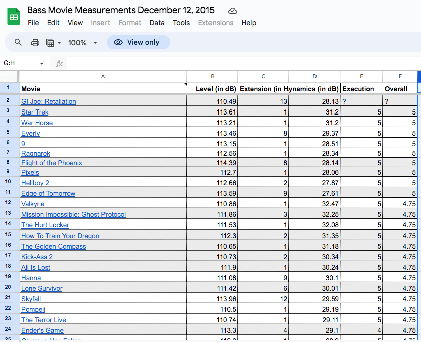

You don't have to guess- post #59 gave links to available titles and the response levels, etc:Hard to guess what's on your source (typically a movie). Did they boost the thunder and military explosions to incredible high levels for the movie theatres or something different (and louder) for the home theatre customer?
Plenty of pants flapping frequencies available well below what most commercial theaters are capable of.
