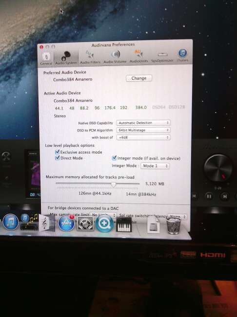

Recently I have finished my ES9018 DAC with Amanreo. I am using Audirvana plus on Mac mini, however, Audirvana said Amanreo only support PCM but not DSD. Could you tell me how to solve this problem?
Thanks all of you!
Don't use "automatic detection". Try "DSD over PCM standard 1.0", works for me (but I am not ES9018 user).

It works! Thank you so much😀Don't use "automatic detection". Try "DSD over PCM standard 1.0", works for me (but I am not ES9018 user).
