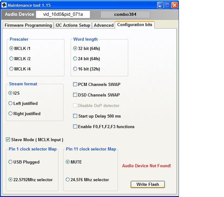

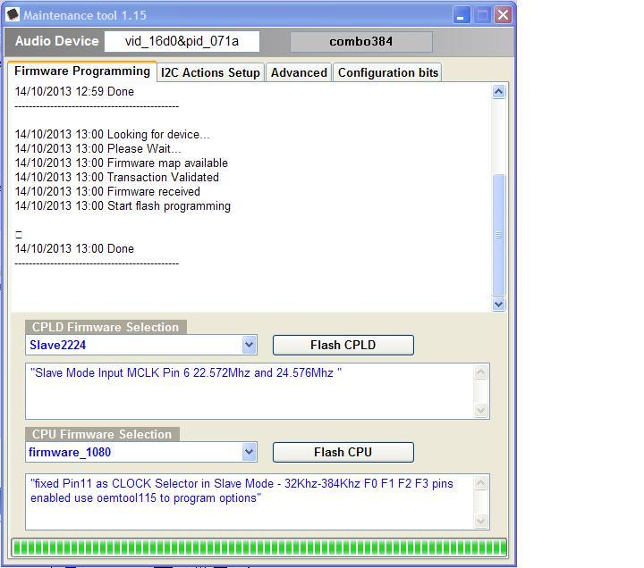

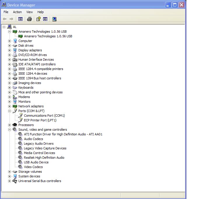

I need some help. I've been trying to get my Amanero board to operate in slave mode but I can't get pin '1' to switch to select the clock. Pin '1' is fixed to 3.3V regardless of whether I'm playing music at 44.1Khz or 48.0Khz, pin '11' is fixed at 0V. I've attached three pics of my latest set up. I suspect the board not showing up in Device Manger under Sound, video and game controllers may be the problem. Probably the reason why in Maintenance tool 1.15 the Configuration bits window can't find the board and says no Audio Device found. Any help would be greatly appreciated.
