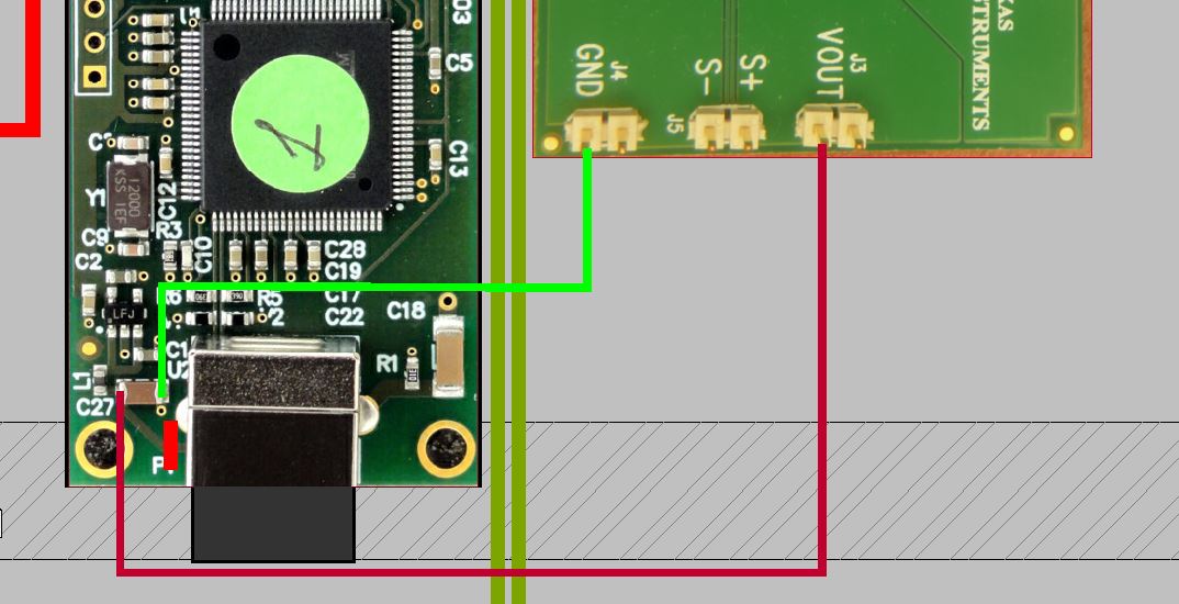

I was planning on bringing a permanent 5v power supply to the Amanero as per the image below, basically solder it on to either side of C27 & cut the trace leading to the USB power in.
Can anyone see any issues with doing it this way?

I want to feed the card with a Audio gd psu l, I have to connect like this
or solder directly behind the USB connector?,
to connect the grd to the psu I take the usb output pc?
