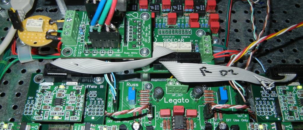

I have a dual mono BIII with Sidecar and Amanero USB module. PCM plays fine through Amanero module, in stereo with R and L channels phased properly. DSD files play in mono. I also converted Left, Right and Both PCM test tracks to DSD and confirmed R and L channel test tracks play from both speakers. The DAC is I2C controlled but no I2C on the USB module. I am using foobar with ASIO Combo384 driver per recent June 2013 HiFiDuino blog Amanero update. No channel swap done in foobar; nothing done in I2C Actions Setup with Amanero config tool.
I have the latest firmware applied to the USB module. Both BIII boards are configured per manual; that is no JPCMx or JDSDx jumpers installed when Sidecar is used. I don't know if this is a configuration issue I am missing with the Amanero USB module or something in the DAC? Appreciate any guidance.

I don't think the Combo384 is to blame for that problem, thee is no way it can know to what kind of DAC it is connected to and sends the same sdignal regardless it is a single stereo Buffalo or a dual mono confinguration or any other DAC for that matter.
The problem is most probably lays in the Buffalo or maybe even worse, in the ES9018 chip.

I agree with you. And I'm not smart enough to figure it out.
I can tell you I got it to work but cannot play SPDIF now. I had to make a new ribbon harness from Sidecar to L and R channel DAC boards. I cut D2 (DSD right channel) at the left channel DAC board and D1 (DSD left channel) at the right DAC board. To get sound from right speaker, I had to connect D2 (DSD right channel) to the D1 input on right channel DAC board (D1 would be left channel input in single BIII DAC application). Now my Right and Left DSD test tracks play from respective speaker. With music vocals are centered, in phase, sounds great.
Wih BIII dual mono, one half of each DAC board is in anti phase making internal DAC mapping complicated for DSD, to me anyway.
