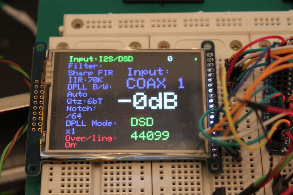

Got mine too and it is playing DSD with the original TPS Buffalo24. The Sabre 9008 autodetects between PCM and DSD and plays so no messing around with writing I2C to Registers for this feature. However it still needs I2C comms to switch between SPDIF and I2S so I still need to investigate the Amanero Config Utility to decide whether I should use that or go the full hog with Arduino.
