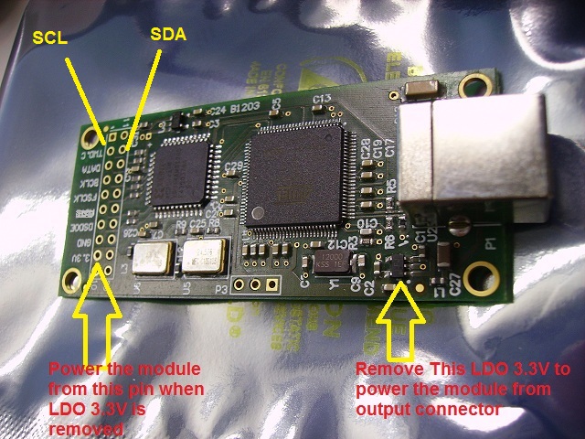

Jesper, the Amanero's firmware tool allows to assign I2C commands to events working as some sort of micro controller. They are saved to the boards flash memory and applied automatically each time the event takes place.
This is a capture of the tool's I2C tab:
I am not sure how this works. Surely I2C control and configuration of external devices such as the Buffalo Sabre chips requires I2C connections to the Bufallo Board and I don't see any I2C connections on the Amanero Board.
Anybody shed some more light on this firmware tool and its use?
