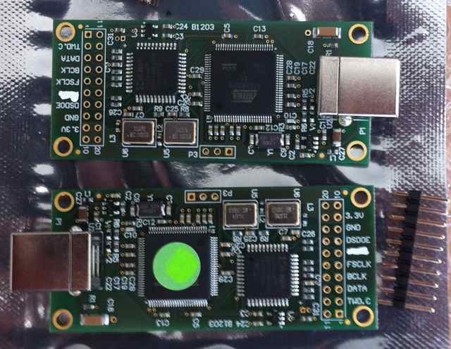

Found something in my incoming post today........
Hi, gentlevoice and NicMac,
I should have clarified that "the board was amanero and he connected his own discrete direct DSD/analog converter to the DSD output terminals on the board".
To gentlevoice
Your guess was correct. His converter is a single resister of 1k ohm as a LPF.
I believe it is far more simple, less expensive, feasible and reproducible than the complicated one appeared in a dRaydream.
To NicMac
His conclusion was that "the aggregation of all" matched his taste the best.
doesnt really sound like the DSD direct filter is ..you you say....'optimal'? :scratch2:
then again it was hard going even with chrome translator, it did seem to be a theme among thos he tried with the LPF compared to using ESS DSD mode
i'm not discouraged, part of the reason I got this thing was to experiment with direct out, maybe not just a single resistor though...... with the USB board being usb powered this would mean USB ground passed right through… thats what you call terrible PSRR :worried:
hey maybe a high bandwidth transformer could be used as filter and isolate the output ground. :idea:
but a few extra parts and perhaps battery psu it could be winning

As far as I know, more than ten people in Japan tried their own "easy LPF" methods to play DSD raw signals without DAC because two DSD64,128,256 compatible transports, Chiaki's SDTrans and ElectrArt's USB Dual Audio are popular among them. Some try a single LCR, other try line tranformers & load resistors other than a single R. No one say "It is optimal" as they suffer residual digital noises that is hard to be eliminated completely. However, most of they say "more vivid or fresh with enough resolution than expected".
The author of the blog page says, Amanero Combo384 is a suitable platform of high cost performance and good availability to experiment such a DSD "playing". His usual DAC is not ESS-based one but FN-1242A(by Japanese manufacturer)-based one.
