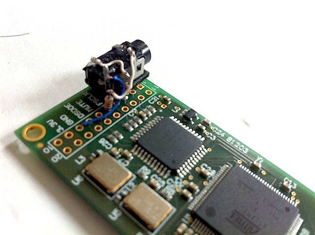

How to :
http://www.diyaudio.com/forums/vend...-i2s-384khz-dsd-converter-26.html#post3155450
Regards
Phil
Regards
Phil
