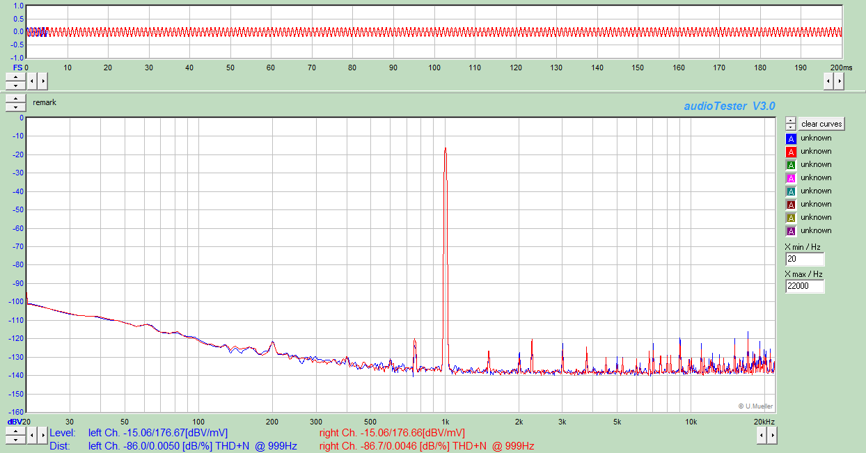

Out of curiosity, I borrowed a Sound Blaster E5 mentioned in post #128, and did some measurement with Audio Tester, with results attached.
BTW, E5's ASIO driver will crash ARTA, but works OK in Audio Tester.

It's way better than the onboard sound card of my notebook, but THD (+N) is quite worse (9dB difference) than the QA400 that I have.

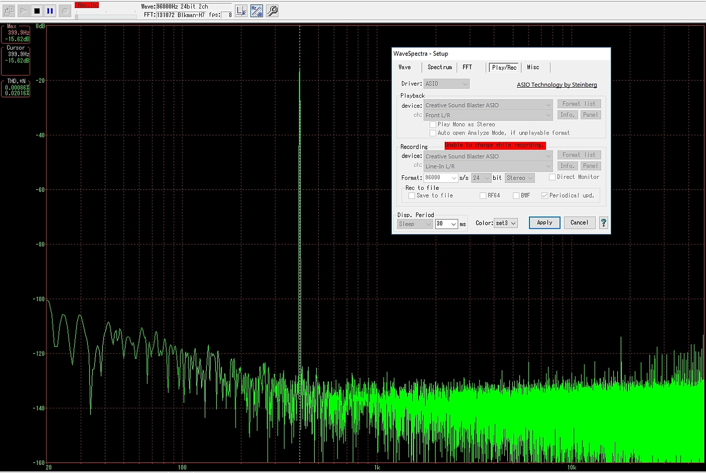

Hi cwtim01. Interesting difference. I agree with the noise observation, it's audible with sensitive IEMs. What were the test conditions and the source?
Edit: Out of curiosity I repeated the test, this time with Creative's ASIO driver and with the digital volume control set to full. Visible spectra essentially disappeared but indicated THD rose, suggesting a measurement artifact?

Test condition:
Source: E5 line out, ASIO, fs 192K/32bit, -20 dBfs
Notebook on battery.
I think the noise floor of below -135 dB is actually very good (it'll degrade quite a bit if the power adapted is connected), what it loses to the QA400 is that the signal it generated is less clean, but at below -100 dB THD it's not bad at all. It'll be interesting to couple the E5 with a low THD oscillator like Victor's oscillator (if you can find one).

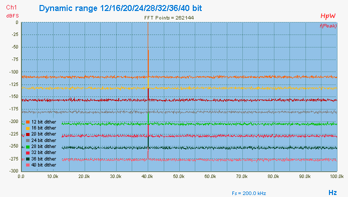

The noise floor also depends on the size of the FFT used for the analysis. You can reduce it by simply using a larger FFT size. Therefore, its not a stable reference for judging quality.
for each 2^x increase the noise floor will/should go down -3dB.
This is sometimes a nice side effect to get into the lowest side peaks. The whole thing really depends on the used detector. Traditional FFT detectors are peak based.
The thing arises from a large FFT size as say 2^19 ... and the real x-axis data presented (means display pixels) has a 1024 as an example. Soon I will present a true RMS detector where the sample size will show the same flat noise level.
Hp
I think shorted input power level measurement is more interesting measurement of
the real noise floor.Frex
Really, it does not help ... while it's still FFT 2^n dependent!
Again look here about the f(Peak) vs f(RMS) (not FFT size dependent) noise levels on various Bits sizes... 😀
Hp

While was expecting this question... 😀
FFT analyzer are able to more things... and not heavy duty 😀
in case you know to deal with:
- Sample size
- Sample freq.
- Bit size used
- FFT Window & resolution bandwidth
- FFT Window filter shape with signal or noise
- marketing bits form ADC/DAC's
In the other hand it's a math./DSP algorithm with it's strengths.
My new upcoming f(RMS) Detector against traditional f(peak) deals with the FFT bins.
Means, if you have a 2^18 (262'144) sample size, the resulting FFT spectrum size will have 2^17 (131'972) FFT bins = RMS Data points.
Now having 131'972 RMS data values but on your screen you may display on the X-Axis 1024 pixels.
Means you have to deal with this data reduction 128 : 1 (RMS data values / pixel). This is the question of the detectors.... Peak/RMS/Min/Avg/.... and required re scaling (took me several month how to deal with this).
Using my RMS detector, results in a FFT size independent noise floor. 😀
Keep in mind, the f(peak) is very useful to get a view into the some nasty peaks
