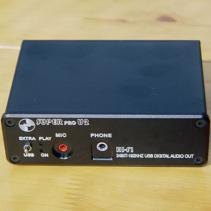

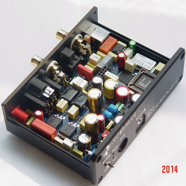

A 24bit-192KHz audiophile sound card from China, which is currently still in production. It's not cheap though (USD150).

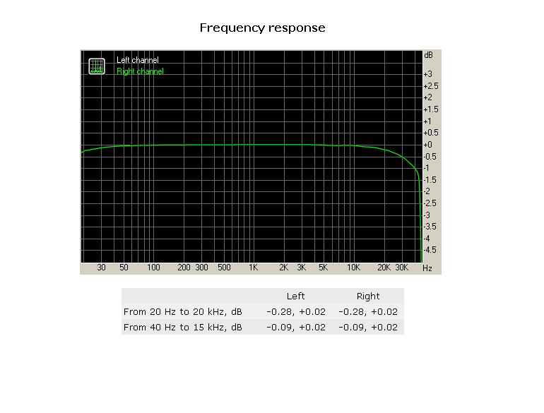

I have used the emu 0202, tracker pre and 0404 with Win 7 in 192/24 full duplex. I have an RMAA report on the 0404 but have no idea how to share it as its an HTML file + directory.
So far my experience has been any win 7 driver works on win 10 just fine.
Keep in mind you are looking for a soundcard + software so the QA400 may be more than enough. It has some specific benefits like making sure the data is not dropped (a real problem in some audio card setups). Building an attenuator or interface for it is not that hard. I have posted two generations of designs that would work. The software is good enough and getting better.
Or you can use a usb sound card (I would strongly recommend a used EMU 0404 usb) and ARTA. Getting that sorted and running may be more hassle and work vs. a QA400 + you still have the I/O levels and interfaces to resolve.

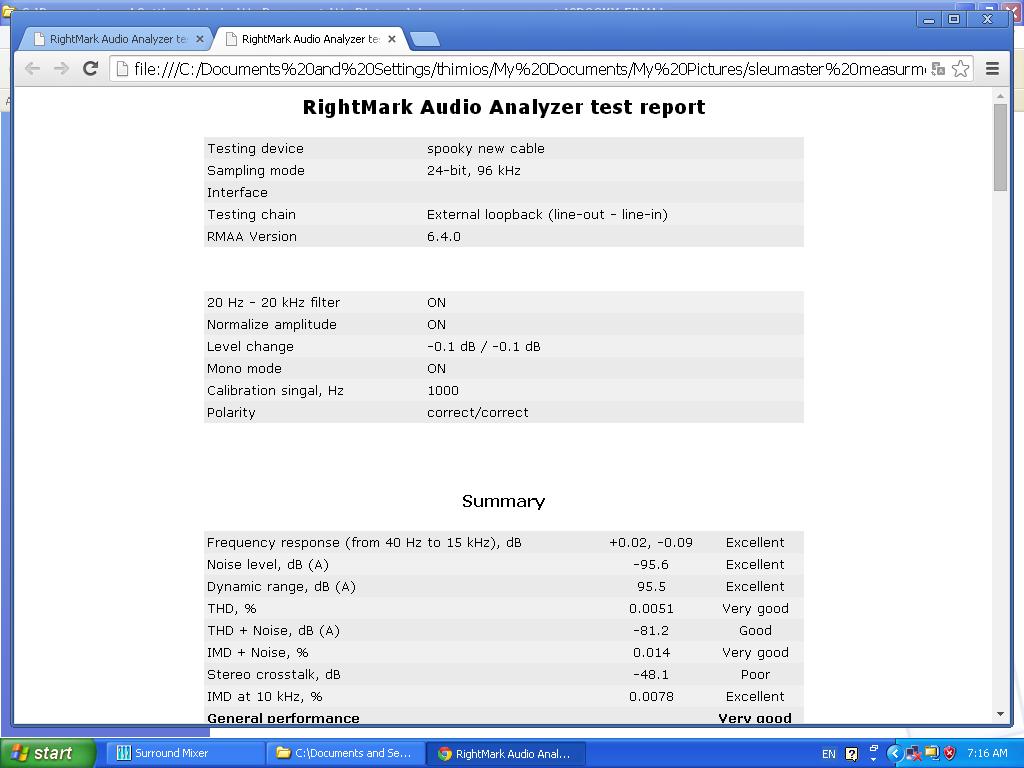

Open the HTML on your p.c .Push print screen,open the windows <<paint >>
push contr+v .Now push file.save as.PNG or JPEG select a folder.
Re-open the HTML if you want scroll where you want push print screen ....thats it.
Sorry i don't know a better way.
