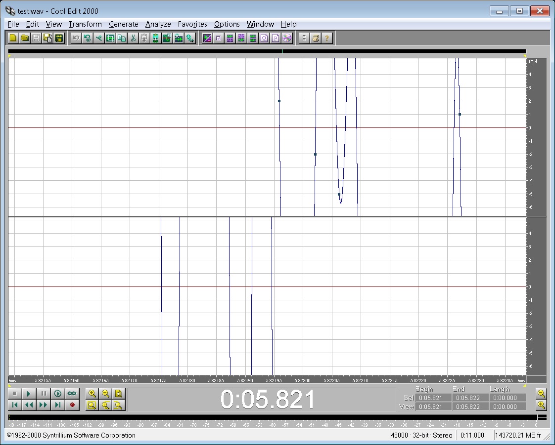

By full duplex I mean you can open two instances of Audition (for instance) and play a waveform in one and record in the other with no drop outs or glitches. When I wrote my first Linear Audio article I was using an Edirol UA-5 (>15yr. old) and it did this flawlessly at 24/48 under XP (USB 1.0). More than 1/2 the USB cards I have tried recently break in any number of ways, garbage or nothing in the record side, refusal to make the second connection, or freezing the app.
Also Arny I think in some cases we are talking about two different things, by performance I mean the 24bits not the THD or noise of the A/D. Failure in some cases is simply there are zeros in the last 8 bits without any warning.

I just ran this test, either Audition or CoolEdit works here. I recorded the noise in my office with the built-in sound card set at 24/48 (no USB involved) using Audacity set at 48K/32bit, it's pretty common to promote 24bit integers to floats for computations.
The picture is blown up to show a few individual samples at 16bit resolution, there are no samples that are not at exact 16bit values, note the data is saved at 32bit resolution (at least the app thinks so). The vertical scale is labeled in 16bit LSB's.
If I send you a short (a few seconds) nominally 24 bit .wav file, could you tell me if I'm seeing the same phenomenon?
Sure, I just ran my internal sound card from two instances of CoolEdit no problem making a 1K sine tone and picking it up with the mic at 24/48. This is CoolEdit 2000 the same shareware copy I've used for 15yr.

What were you and Scott looking at? If your card and software are really doing 24 bit?
Yes, they aren't, Audacity gets the upper 16 bits and adds an LSB of 24bit dither. Here's some values normalized to 1V (1 16bit LSB = 3.0517578e-05 V), you will notice these are all divisible by 1 16 bit LSB with an occasional 24bit LSB remainder. The file will still essentially act like 16bits truncated unless dithered somewhere at 16bits, there is no way of assuring this is done.

I used Audacity to make a short recording at (supposedly) 24 bits using the Scarlett 2i2. His data showed that it was 16 plus zero fill.
