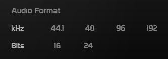

I'm pretty sure with difficulty I did 24/96 on a Xonar-U5. Even with the Scarlet I needed to run something like ARTA to set the sample rate and resolution and then go back to Audition to record. BTW you probably know Audacity almost always returns 8 zeros in the LSB's even set at 24 bit.

This is the U5 format selection portion of its app. I'll try again to get a screen shot of the actual data. I decided to use a field recorder off line on batteries to make recordings that really matter.
