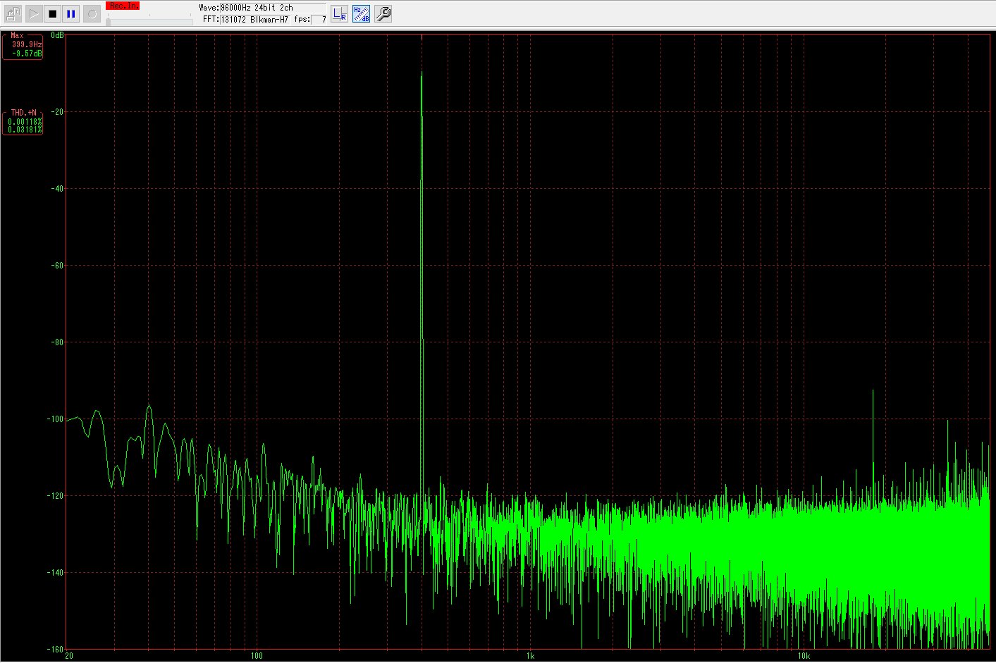

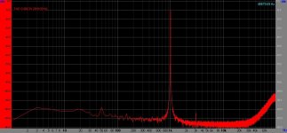

Thanks again. At maximum gain a generated tone higher than -15 dBfs appears to clip the E5 internally. I took one last run taking care to:
- use ASIO as in the previous run
- set the E5's digital output level to maximum
- set all other output sources in the E5's software mixer to minimum and mute
- set the E5's record input level to maximum
- set all other input sources in the E5's software mixer to minimum and mute
A tone of -22 dBfs resulted in minimum indicated distortion at a record level of -9.6 dBfs. Again no harmonic spikes were visible and the THD was around 0.001%. I'm fairly convinced it's a measurement artifact, visually the distortions components are below -110 dB.
It's correct that the bin used for these measurements is very large in order to reveal harmonics so noise shouldn't be taken at face value. Displayed noise also follows the line input mixer setting and might be pointing to a limitation ahead of the AD.
Incidentally, with the output loaded by a 27 ohm IEM at a comfortably loud listening level the distortion at 400 Hz rose to 0.003% pure second. For my use - primarily measuring tube circuits, listening to podcasts over Bluetooth from my tablets, hands-free phone at work, and playing games - I'm deep into the nit-pick weeds here.

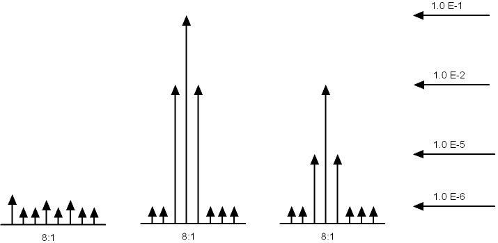

Broadband noise gets its energy is divided up among all or at least many FFT Bins.
A pure wave will be divided up among 1 or 2 bins depending on how its frequency lines up with the center frequency of the relevant bins and the windowing technique that is used.
But this is true regardless of the width of the bins since the pure wave has all of its energy at a single frequency.

See also the picture below about FFT Bin compacting...

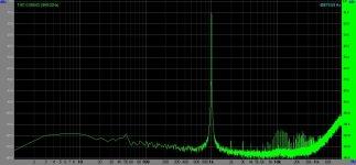

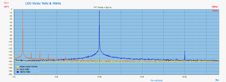

Wish to tell you little about one amazing result with the E-MU 0202. Not far ago got this card from the ebay auction for 30 EUR. I was planning this for my laptop as spectrum measurement tool. This USB sound card uses AK5385 as ADC. The chip is semi compatible with the AK5394, and I thought, that maybe I can replace the ADC chip, if it needed, but seems that is not needed. After one working day, some changes in the buffer amp and little tricks I got wonderful results from the right channel of the ADC. The left channel was more worse (seems that the chip internal problems), and I blocked it. As result I got this relatively small "magic" box, and the nice spectrum picture:

The spectrum seem to have fundamental level at 0dBFS, but it need to be confirmed.
I'm very surprised by this results, THD is less than -130dB here and even AK5394 doesn't reach this ! Maybe you fell on the best one 🙂

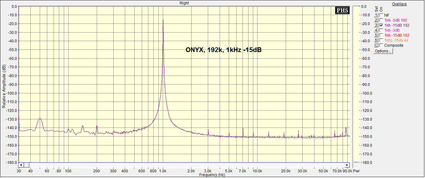

I see -135dB noise floor.

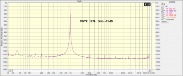

Don;t know about 5385 in this soundcard, but with 5394 it can be expected ~ -150dBFS, so this picture can have 0dB=-15dBFS.
@-15dBFS signal, 5394 have harmonic level ~ -140dBFS (see attachment. @44.1 the results are better).
🙂 Yes, Alex. You are almost right. 0dB=-16dBFs in my picture. All the soundcards, that I previously had, required offset for the best results in the spectrum measurement. My main internal soundcard Asus Xonar D2 works with -23dB offset...
I am using Spectrum Lab ver. 2.4.0.31. Sampling rate was 192/24 with maximum averaging.
Mainly all changes was done around ADC buffers. High gain and noisy input amps was disconnected. Later, I shall post more detailed information - when I get it in suitable format.

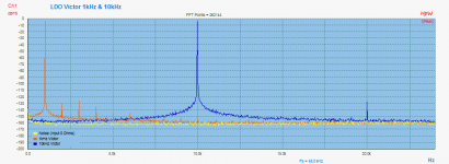

Here some measurements using your lovely LDO's...
And it will always be the hard part with the input LNA & best ADC. And finally for a DIY, to effort such HW/SW or even to build with the existing knowledge such HW. 😀
