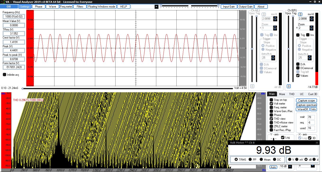

On w10 testing now the Visual Analyzer from Italy.
So far looking good. M4 basic thd 0.0004 and thd+n 0.0009

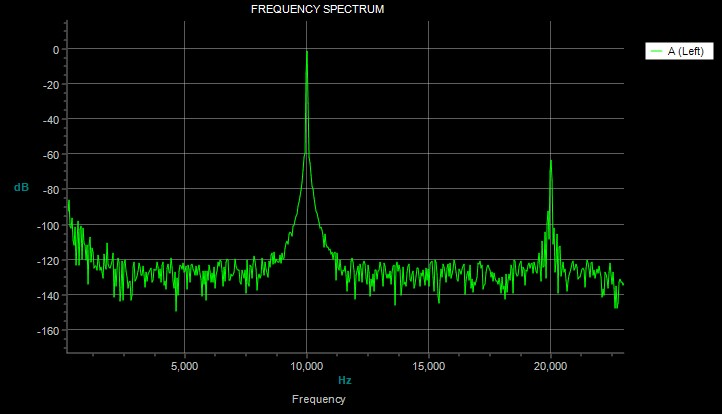

Measured the M4 max outputs RMS levels, seems some confusion on the ASR tests.
Going frum - to + on balanced line out I measure 5.2VRMS and 15V PP.
The unbalanced outputs are slightly less than 50% of the bal output. ie 2.4VRMS 7.2 PP
Here is a stereo pic testing a real tube amplifier, different skin playing with colors.
I don't have the spectrum cal scale figured out yet. The measured voltages are correct.

On Visual Analyzer, use the 2014 release. Works perfect, the 2019 beta has too many bugs.

VA 2014 did not run OK in linux/wine, while the 2019 seems to run fine. I did not do any extensive tests though. It can handle 1.5MHz samplerate without any modifications, the only one from the windows bunch https://www.diyaudio.com/forums/equipment-and-tools/349239-support-samplerates-sw-analyzers.htm While a few minor bugs arose during the test, its multithreading fared surprisingly well (at load over 150% CPU core for the VA process it was still quite responsive).

On 2019 va i had bugs when using config save/retrieve and would have to reinstall, floating point error probably due to AMd differences. I tested various buffer sizes and other analyzer software. It just needed fast computer.
