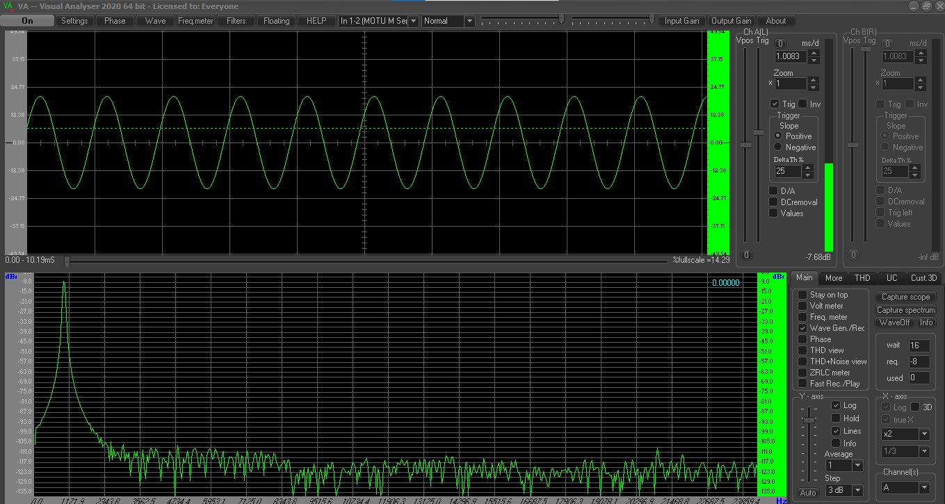

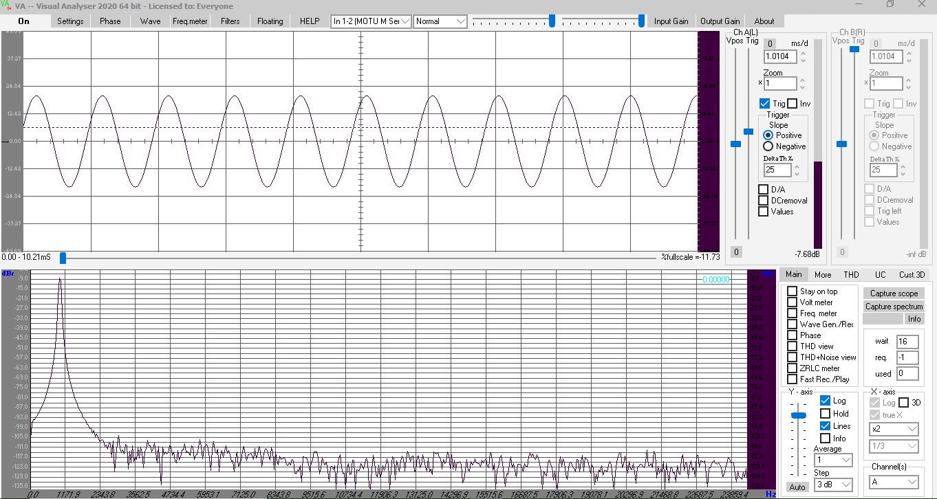

I'm testing the Visual Analyzer latest beta with M4 and everything so far working great.
Also updated to latest win 10 driver.
This plot is un-calibrated, not at the lab today.
(fixed) I noticed a faint weird pixel thing at ***-end of scope trace and just assumed it was a communications or graphics glitch. Later it proved to be on 10ms intervals.
Tried different buffers sizes etc still would see on screen. It showed up in fft too.
I would see using other software too. Turned out to be windows real-time virus protect. Turned off now and all is peachy.
Setting on quick test are:
M4 config window 96000 1024 buffer
VA Beta- Running as administrator , 24bit,96000 2k fft buffer, un-calibrated vertical, input/output m4 ch1-2 out ch 1-2
Even though not using mic the e sys microphone cannot be 'disabled for apps' or you will see a system comm error. I guess VA checks all io devices in list.
VA64 (beta) is excellent professional software imo.
