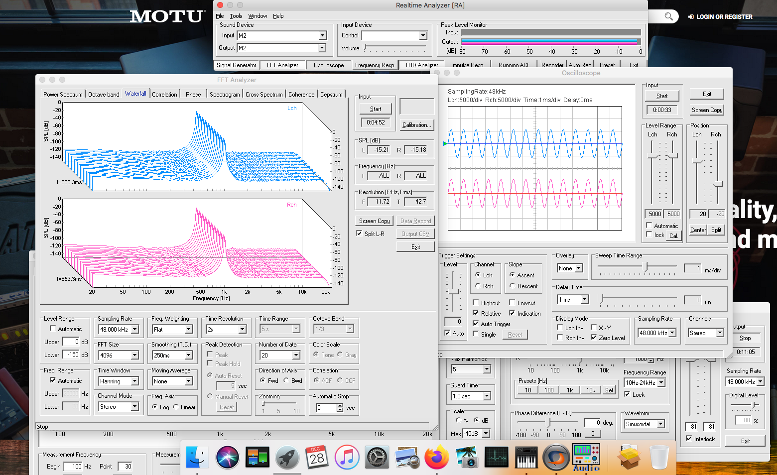

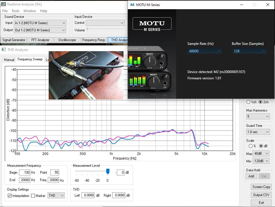

I done playing with the m2 analyzer. It works great, its a major upgrade now back to the projects.
Here is screen pics my old software using the M2 on Osx/wine and w10.
Made a couple of RCA to 1/4" mono plugs.

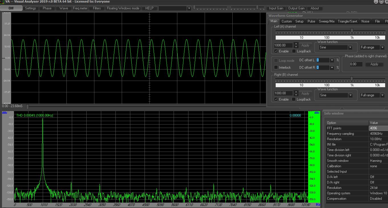

Nice line out/in and the motu driver is perfect. I looking at new software as my old RTA is now defunct and no longer supported.
On w10 testing now the Visual Analyzer from Italy.
So far looking good. M4 basic thd 0.0004 and thd+n 0.0009
Visual Analyser details
