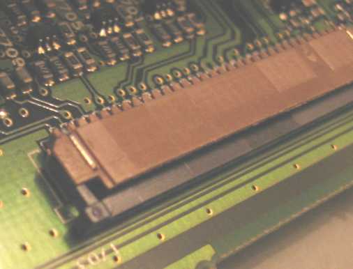

I have the service manual for the DVD module assembly SD-4.00SA_CH , also used in the SACD1000 player if anyone is interested.

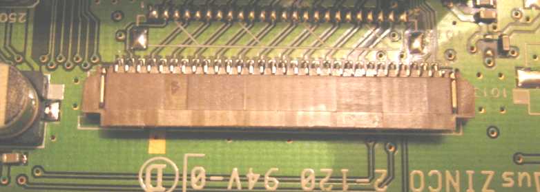

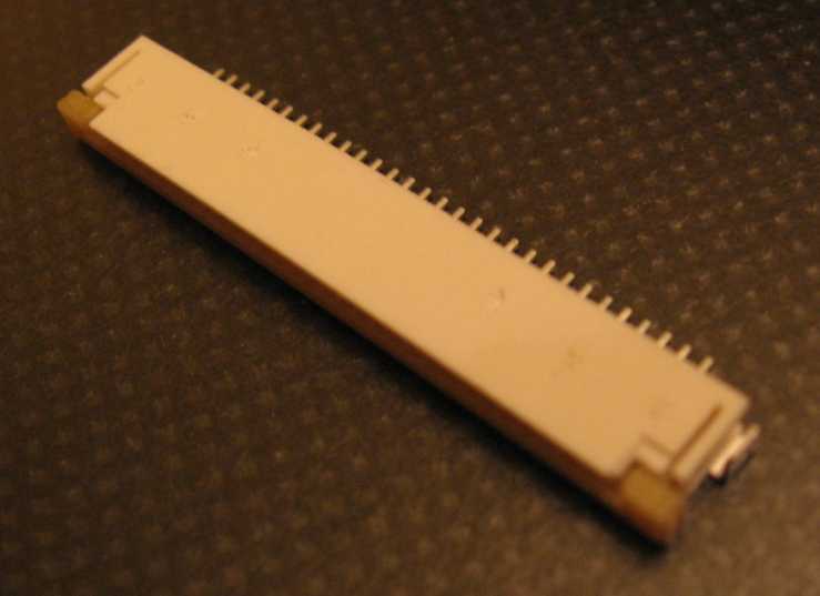

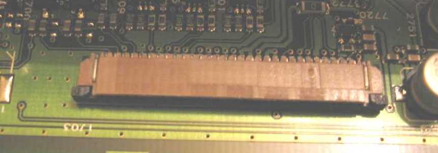

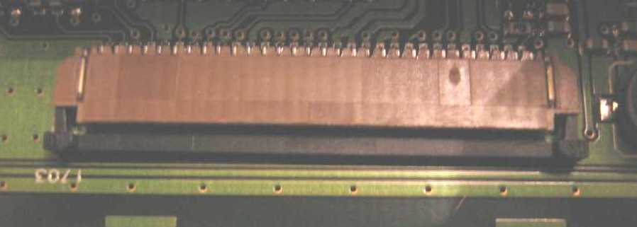

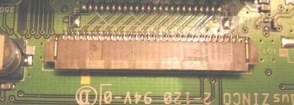

Can anyone help out with the 30 way FFC connector used at the right hand side of this board ? The plastic locking latch on mine has broken after inserting and removing the ribbon a few times. It's 1mm pitch right-angle (horizontal) with upper contacts. I haven't found a replacement with exactly the same latch and I'd rather fit a new latch than desolder the existing connector if possible - I don't know how the pcb will stand up to desoldering so many contacts and the last thing I want to do is to lift any tracks.

Hi Jon
I'm very interested in that manual...
Sorry about your connector, it 'll be very difficult to remove the thing I'm afraid. Maybe you can solder a different type of connector with very short wires ? I was thinking about something like an ide connector, should be a lot easier to insert a cable. Backdraw is you'd have to do it on both sides of the flex, so on two pcb's...

Hi Jon,
Can you post the pics of what exactly you want? Let's me try to source it at Hong Kong and post to you.

Hi Bearbear,
Thanks very much for the offer, very kind of you. I'll see what I can do in a day or two regarding photos. Did you want the manual for the mono board ?

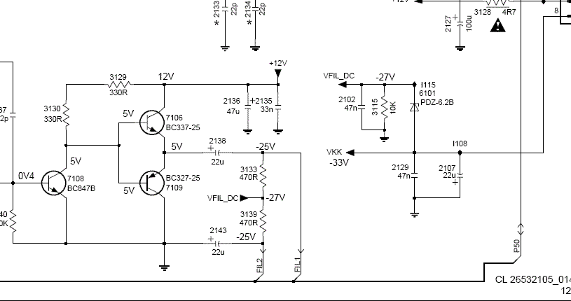

My 963SA doesn't respond anymore after putting the plug in. I investigated some in the powersupply and checked the voltages that are suggested in this forum.
They seems to check out when I have the power supply disconnected from the AV module. When I connect the two, the -32V supply drops to 0V !
Any idea's what is the source of this? Is there anyone here with schematics who cares to share them or give some relevant info?

Check capacitors 2131 (47nF) , 2129 (47nF) , 2107 (22uF) , 2102 (47nF) and resistor 3115 (10k) all on the display pcb.

Thank you Jon, but it's hard to find the right components without the schematics. Are it the components that are directly after pin 8 on the connector?
Any hints on how to test them in circuit? Or is this impossible. It won't be easy getting these smd components off and on the pcb.
Yes !
Check if any of the caps have failed short circuit. Check if the resistor measures 10k. C2129 and C2107 are probably most likely.
