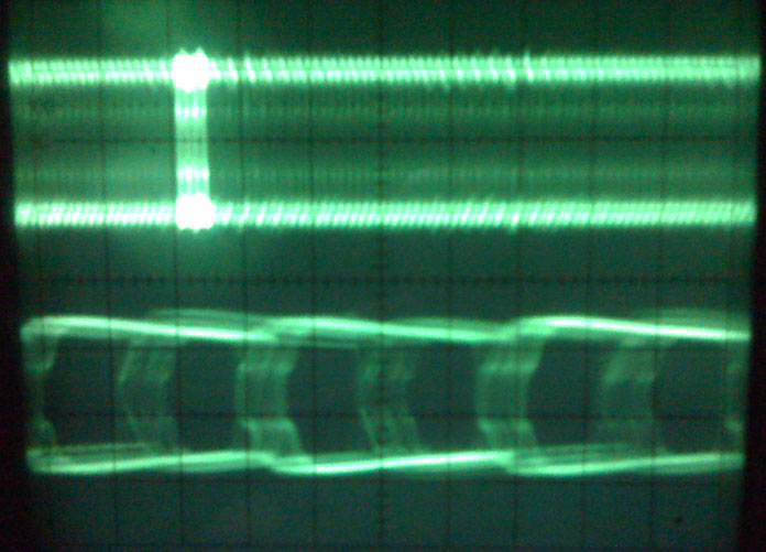

Digital out problems
Hi!
Although my problem is about the digital output of this player, let me give some background on the modifications I did to my DVD-963SA. Basically i replaced the caps for Panasonic FC, and added the red little MKTs. I did this for the power supply, audio board and the video board. The player is connected to a Marantz SR7500.
Now my problem lies with the digital output (coax as well as optical). When I play CD at 44.1 kHz, 16bit and upsampled to 96 kHz, 24 bit no problem at all. However, upsampled to 192 kHz, my receiver does not make a sound. Also playing dolby digital tracks and dts tracks leaves me with no sound at all. For dobly digital I see the format (2.0 / 5.1 etc) blinking in my display, as if it sometimes manages to see the signal and sometimes not.
Does anybody know what could be the cause of this problem?
I suspected a large jitter in the digital signal, and tried to measure this with an analog scope. I compared it to the output of a Philips Q50 and the signal of the 963 looks much better. The Q50 shows strong overshoots, and the 963 gives a much cleaner block wave. Jitter seems to be equal for both players, yet the Q50 gives digital sound without a problem, and silence for the 963... 😕 I attached a picture of my diy jitter measurement of the 963.
Could a low-jitter clock upgrade solve this problem, or is it due to something else?
Thanks for you input!
Marijn
