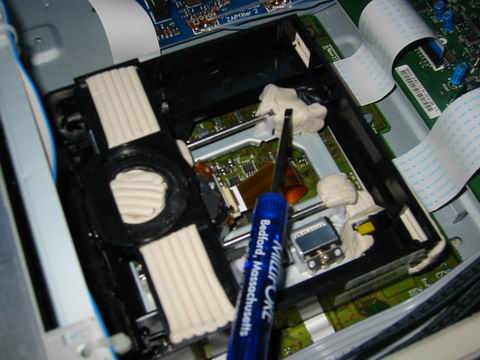

I recently discovered the root cause of the transport noise problem which has been reported by many 963SA users. This problem also bothers me for a long time on top of the ticking noise which I mentioned previously in this thread. The ticking noise was reduced a little bit after I switched to servo firmware 7.12.0, but the tranport noise was still there and I believed it must be a purely mechanical problem.
I did some experiment by finger toughing several places while playing one of the CD which causes the vibration noise. Then I found out if I can stop the vibration at the point where the screw driver points in the attached picture, the noise went away. So I further apply more "Rope caulk" (can be easily found at Walmart here in the US, it's used for window/door sealing purpose) to this joint on my already heavily damped transport. Now pretty much all my CDs play without error and noise.
