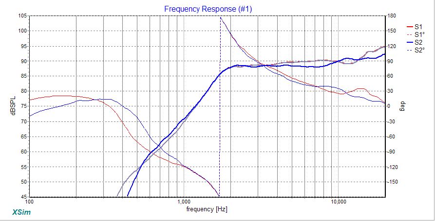

Here's just a little thought experiment to follow up my last post. I wanted to look at how the Scan 2604 behaved with xo parts in front of it vs the Satori 29R. Don't take any of the xo values to be correct nor the position of the resistor either - the FR files also don't include baffle diffraction effects and I just randomly chose a low roll-off frequency that might be suitable with an MTM design or not.
So here is the Scan 2604 again from Zaph (grey) vs the Satori 29R again from the spec sheet (blue) when you just drop it in with no xo changes:
Fairly similar below about 3.8Khz but significantly different above that.

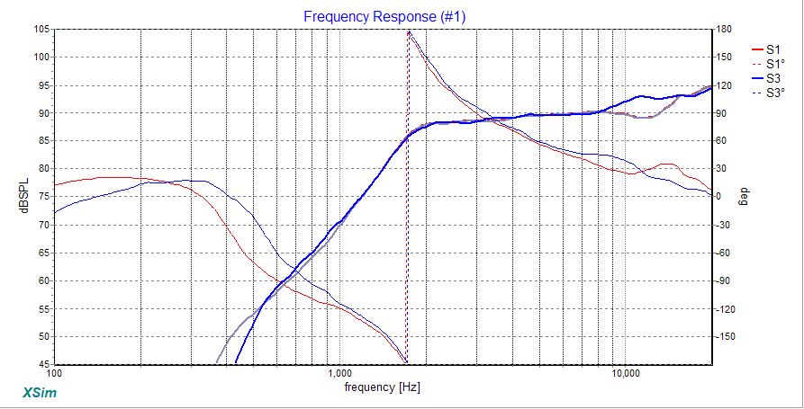

And here are the 2 again but this time with just some minor tweaks to the xo values:
Now we get pretty much a perfect match except for the boost in between about 8.5Khz and 16Khz which again may be exactly the kind of thing that will make the difference you are looking for.

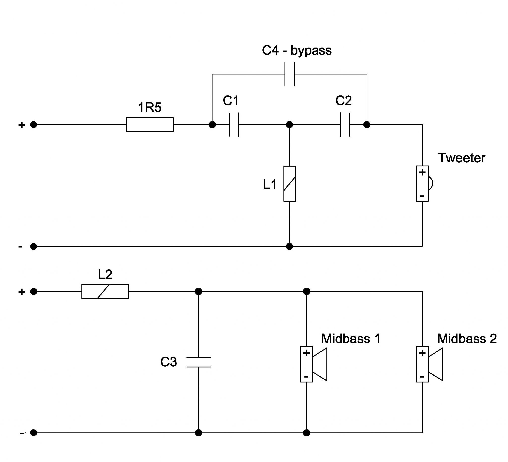

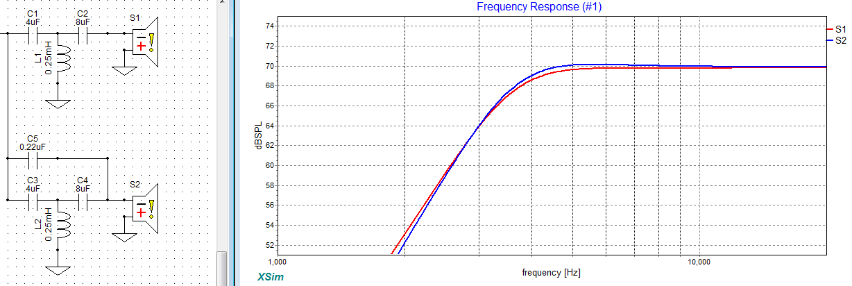

And the xo schematic:
I chose a simple 3rd order electrical with a 1.5ohm resistor before it. S2 is the Satori with no xo changes and S3 shows the changes that were made. The situation could be a little different given the original actual xo parts used on the tweeter, but it certainly shows possibility anyways.
Physical dimensions look similar too except for slightly different Satori wire terminal positions which shouldn't be too hard to change.
