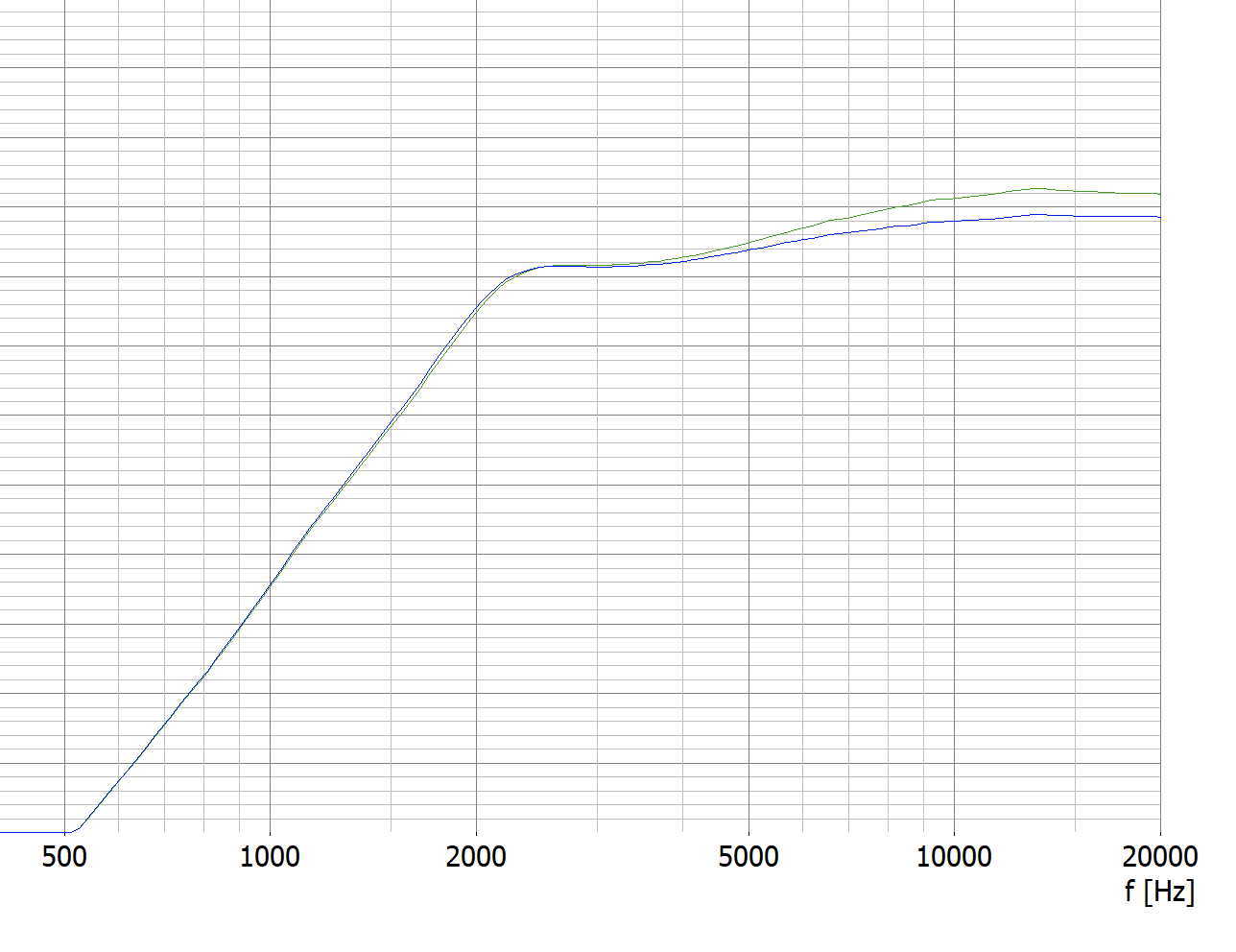

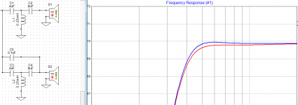

A similar effect is likely to be obtained if each capacitor is bridged by 0.22uF. There is also a some deviation of the capacitor capacity in the crossover. Let's say + -5% at 4.7uF is + -0.235uF.
In addition to all this, there are speaker impedance deviations, resistors tollerance and deviations in the frequency response of the speakers.
It rarely happens that two identical speakers come out of the factory. Only when a matched pair is sold.

Unless you listen to pure mono recordings and your signal chain is tightly channel matched, you will likely not hear a difference between 2 like drivers which aren't factory matched. Some brands are worse than others, but the better SS and Seas drivers are fairly consistent to one another. The average listening room will impart a bigger effect on channel balance than the typical production tolerances between the same model drivers from similar production dates,A similar effect is likely to be obtained if each capacitor is bridged by 0.22uF. There is also a some deviation of the capacitor capacity in the crossover. Let's say + -5% at 4.7uF is + -0.235uF.

I still think this can be solved with existing tweeters, just to detect all the problems first.
The question is, what's wrong? In the original posts it was about retrieving some more 'sparkle'. After 9 pages we still are clueless about the X-over part values. OP wants to spend big on beryllium. I say: bypass the 1R5 resistor with a 33µF MKP cap, that will give some 1,5dB extra around 10kHz.

I've first suggested this and been saying this since the beginning of this thread. Minimal risk and good potential for a quick solution to a subjective problem.The question is, what's wrong? In the original posts it was about retrieving some more 'sparkle'. After 9 pages we still are clueless about the X-over part values. OP wants to spend big on beryllium. I say: bypass the 1R5 resistor with a 33µF MKP cap, that will give some 1,5dB extra around 10kHz.
