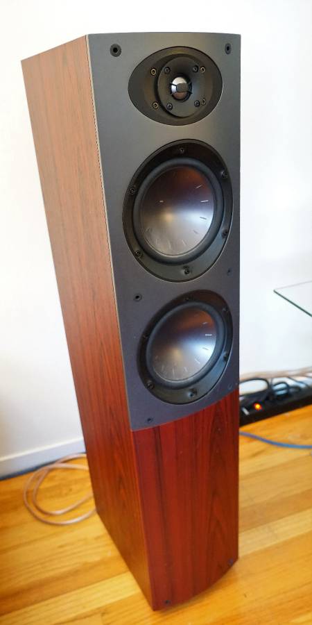

nothing is ‘ wrong’ with the speakers.
i love to tinker in any hobby I do.
i love the learning experience.
who cares if I blow some money on it while doing mods ?
that’s part of the fun for me.

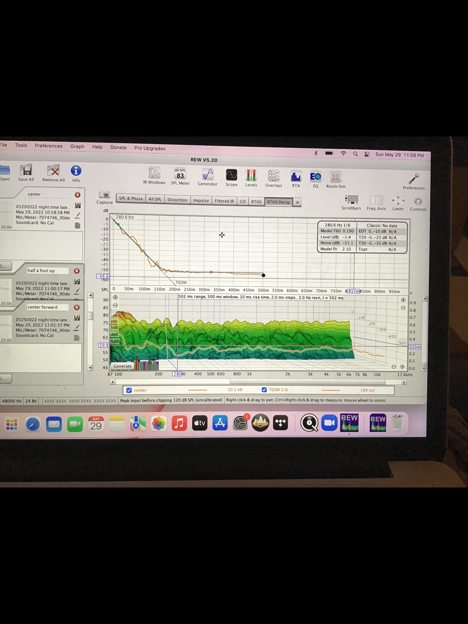

i already have a minidsp mic and have been doing measuremnts in my room for years.
below is my latest RT60 decay measurements. Which are amazing for my really bad room.
thanks!

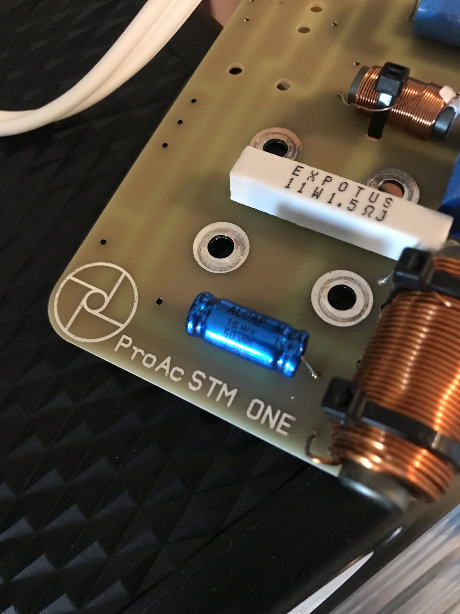

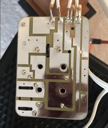

Ok finallyI got around to taking out the XO.
lugs on the left re negative. ( btw)

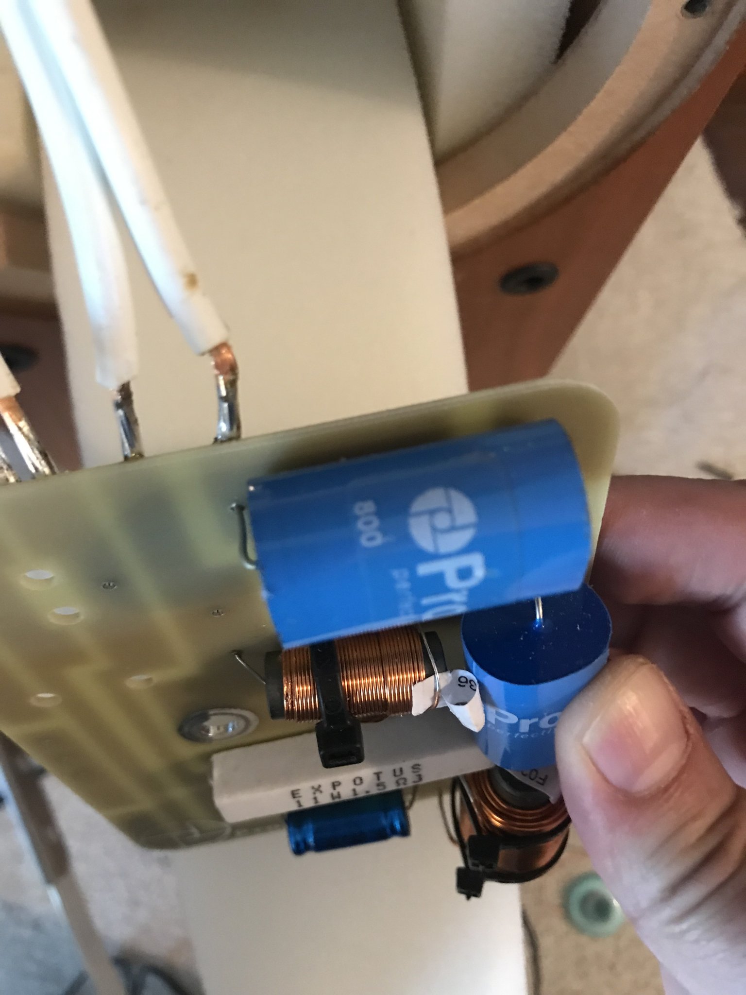

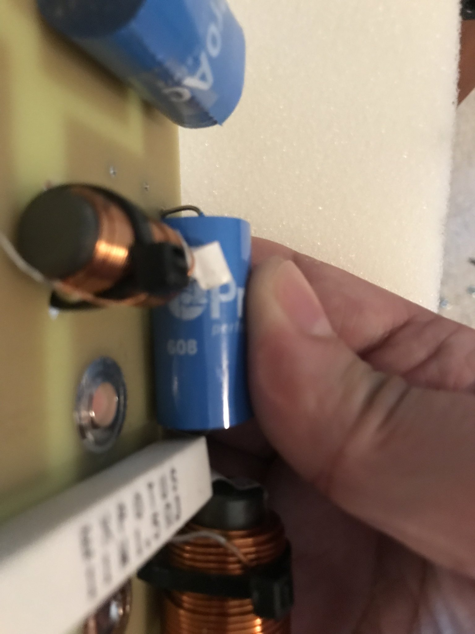

Inductors measure as follows.
Tweeter - 0.22mH. DCR 0.3ohms
Bass - 1.63mH. DCR 0.3ohms
now I didn’t take them off the circuit as I measured with my LCR meter.
because I measured the resistor on board and it was 1.6ohms. Minus .1 from the resistance of the LCR meter leads.
the cap values you can see from the pics
