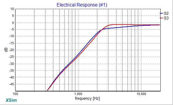

It is alternating current, so that resistor is 50% of the time in front of the crossover and 50% time behind the crossover.
A resistor placed before the XO would appear not to tilt down the treble response, whereas one placed after the XO does.
That is why the suggestion of putting a 0.47 uF capacitor in parallel with a resistor which is placed after the XO has been made - this would lift the upper treble response.
Wrong. The current in any case passes through that resistor, and the power loss is always the same, proportional to the square of the current and the resistance.
Adding a capacitor parallel to this resistor raises the frequency range according to the decreasing reactive impedance of that capacitor at higher frequencies that bridges the resistor.
I would also condone a small cap across the series resistor if there is one, but fore or aft position is likely to still have benefit. I've used them in both physical locations. Usually smaller cap on first resistor and larger on aft due to the induced tilt.
It's worth reposting wolf's opinion.
There is only one resistor. So it is possible to bridge it with a resistor and raise the whole part that does the tweeter, or with a capacitor where only a part of the highest frequencies will be raised depending on the size of the capacitor.

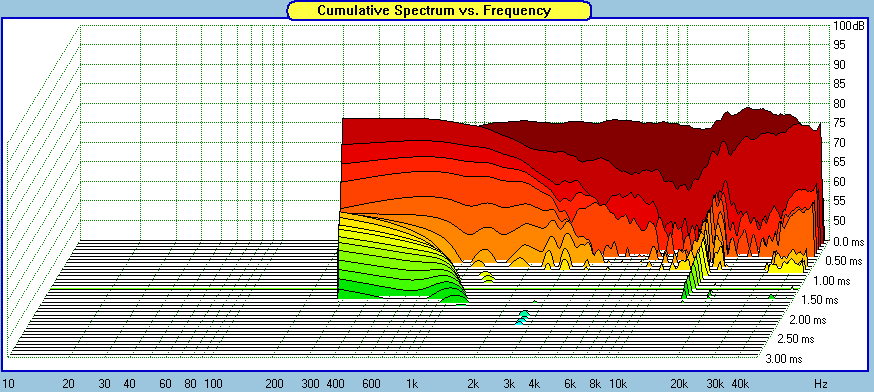

So here is the CSD of the D2604:

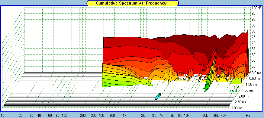

And then of the D2904:
So those are actually very similar responses with maybe the more expensive tweeter having very, very slightly faster decay times above about 3kHz but not really by much. (I'm kind of assuming that you know how to read these or that you are smart enough to figure them out, but if anything isn't clear, just ask.)

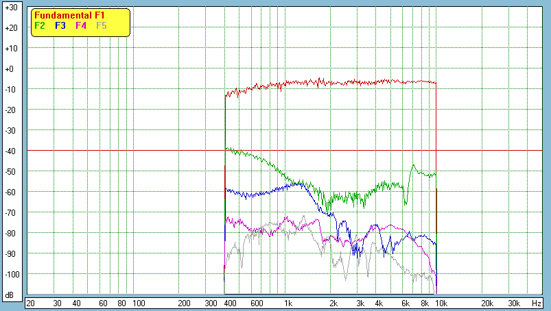

And then here is the Harmonic Distortion for the 2604:

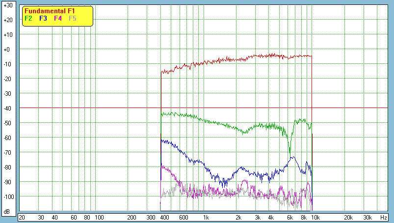

And for the 2904:
It's the 3rd harmonic in blue that is usually considered the worst offender and again, both drivers are remarkably similar - both 3rd harmonics are down around the -80dB mark above about 3Khz. Below 3Khz, the 2904 is doing much better but that's not really where your problem lies is it? But the 2904 does show a better response in terms of 4th and 5th harmonics so there is that. But just in general, the quality differences on these 2 major metrics are actually very small, which is just reinforcing what others have said in that the 2604 is considered to be a very high value little tweeter.

Filter response of a 3rd order electrical network for a Seas 27TBFC/G (6 Ohm nominal): in blue with a 2R2 resistor before the crossover and in red the same resistor after the crossover. Not exactly the same. Just to be precise, I've used the measured impedance.
Ralf

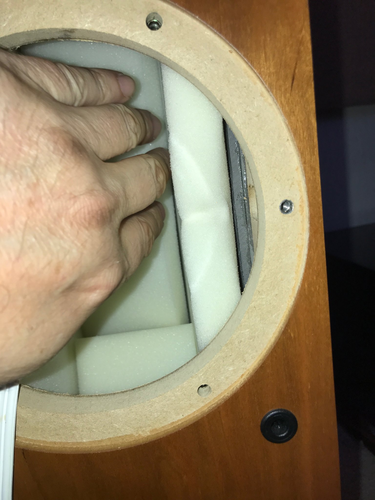

Regarding your ProAcs, the enclosure isn't braced at all. Baffle and other panels will radiate some unwanted frequencies. Also the damping of the cavity, well, it could be that foam is reasonable, but it is applied quite sparsely and won't absorb enough interior sound. Standing waves in the interior will contribute to coloration. I can think of a few tweaks that really make a better speaker here.
So what is a faster start stop time?
it actually is completely lined in bitumen.
its hard to see from the pics.
Check. Bitumen mass plate doesn't do very much, be it it's better than nothing, especially at higher modes of the panels.

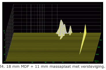

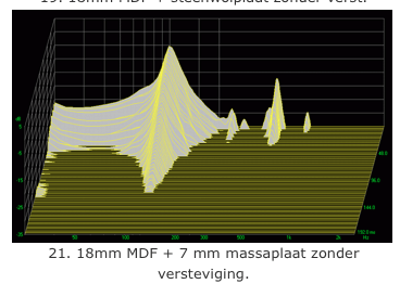

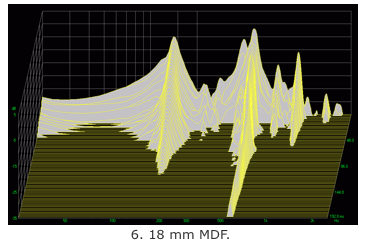

You can read CSD, so:
The bare stuff. Think of this: your midwoofers are mounted on a bare panel which will resonate like @#%%!.
MDF + 'bitumen', 7mm (!) thick. Most of it is 4mm and far less effective. But the higher order panel resonance is under control.
11mm (!!) mass plate actually, but let's call it 'bitumen' plus braces on 18mm MDF. It doesn't get much better than this.
Still lots of room to improve.
Pics courtesy of Martin van der Hoff

here is a pic which shows the thickness of the bitumen. it is at least 7mm.
yeah it’s not the best dampening and cabinet construction, but a lot of British speaker makers don’t like internal bracing.
