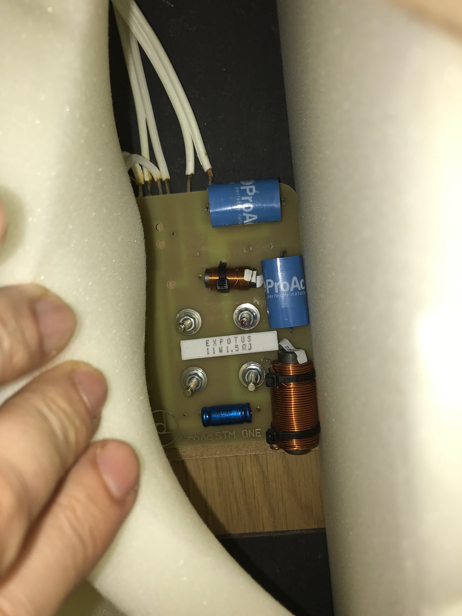

Can you extract the crossover, tone?, and photograph it for us? We can show you where that padding resistor is if you are uncertain of its location.

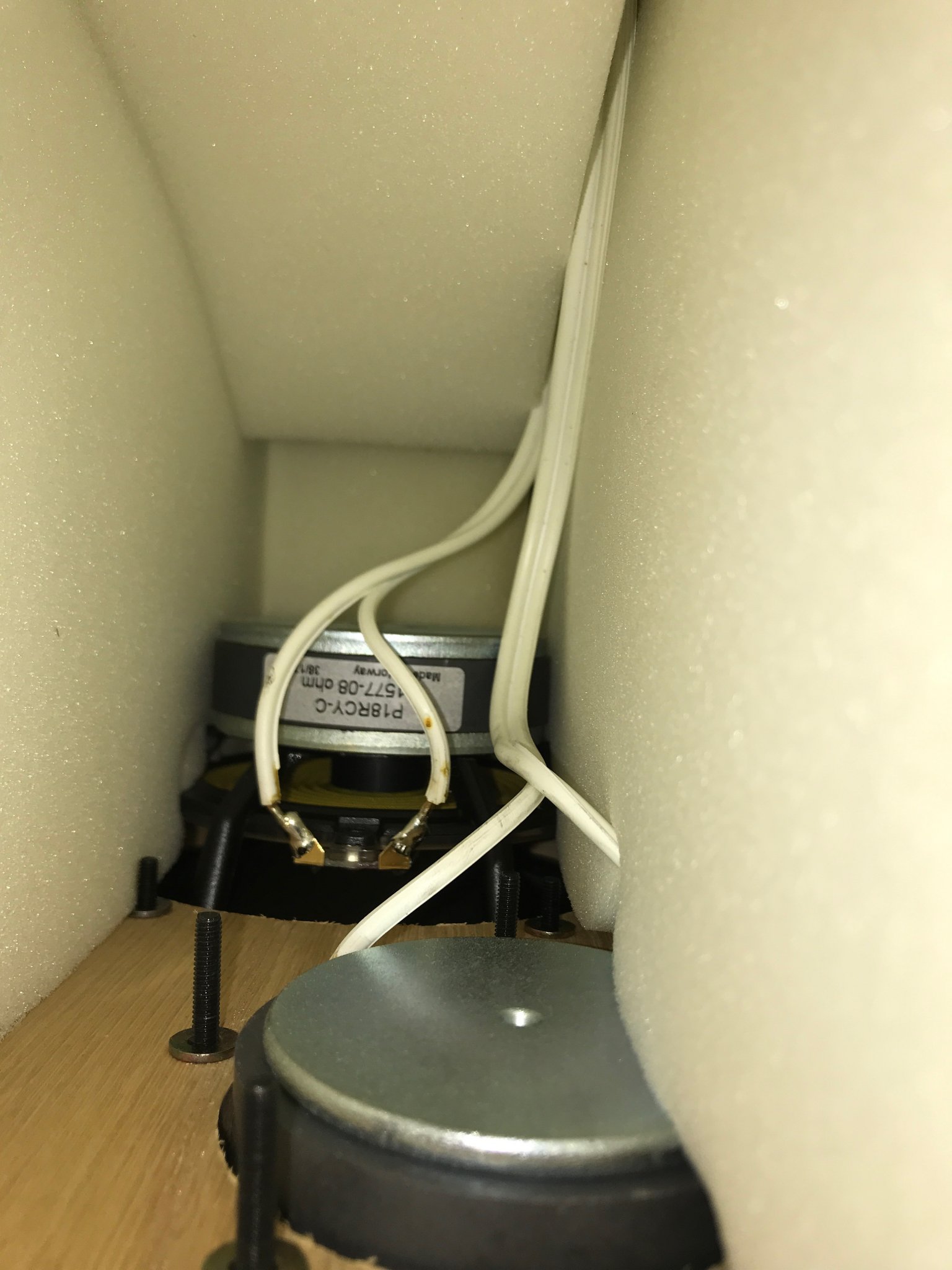

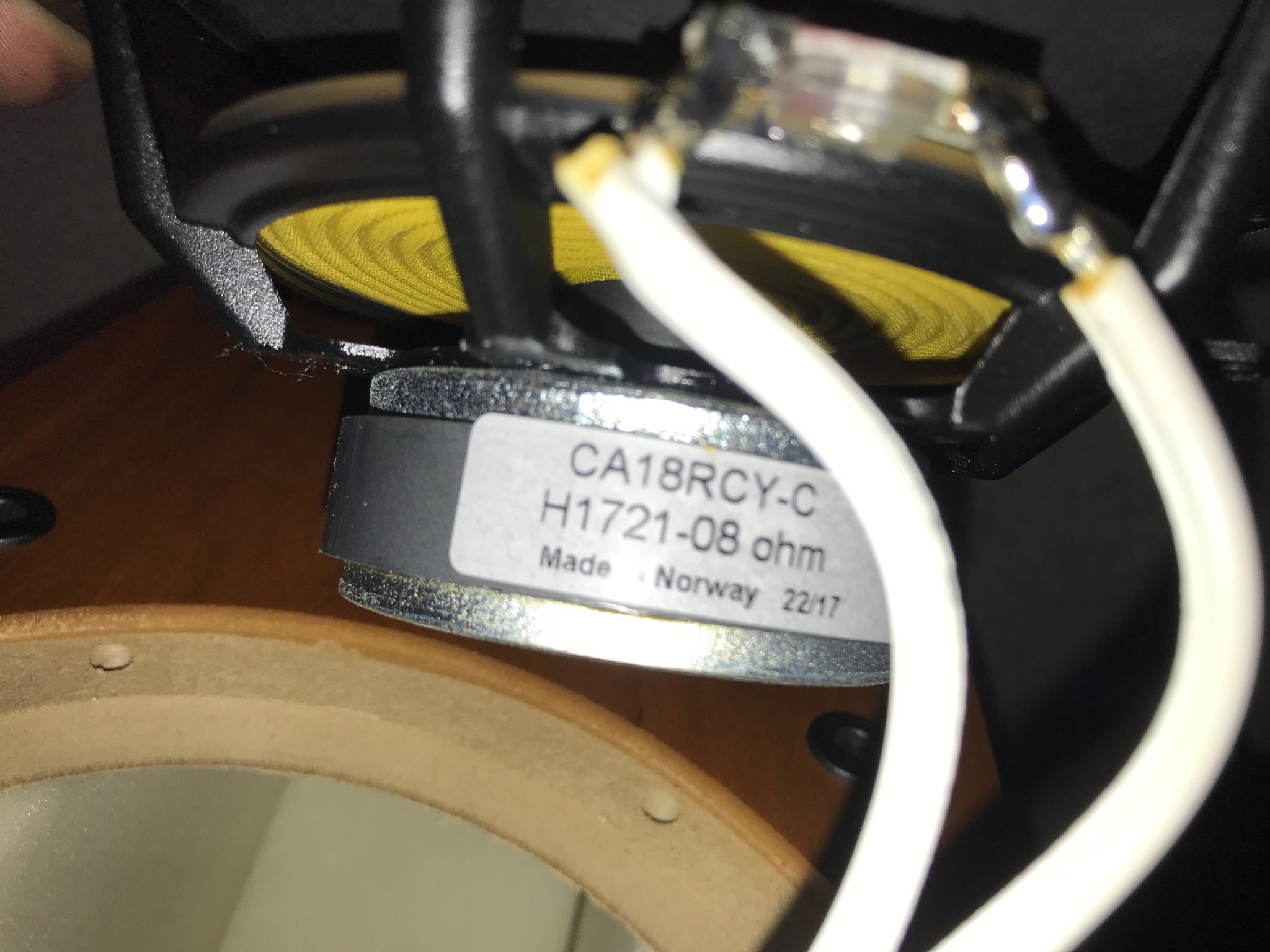

i would assume taking out the lower driver would be the best way to it?
it’s the Proac DT8 and is MTM configuration. It’s bottom ported.
Might be friction fit and jelly glue then.
So taking a woofer out might be the only way to find the XO
yeah was gonna say there is no back panel to take out and no screws on the binding post panel.
I’ll start with the bottom woofer

The trim ring around the plate may be friction fit with a bit of hot glue holding it and the retaining screws could be hidden by that. I would remove the woofer first to verify before you potentially tear up the terminal board trim.I can't see any screws on the terminal plate, Moondog.
crossover pics above
Crossover pics aboveDon’t exchange the faceplates unless the geometry (just around the dome) is exactly equal. Which it’s not, obviously. The smooth top end of the revelator could be ruined by adjusting the little horn these tweeters have. What is so difficult about recessing the tweeter a bit further, it’s quite standard woodworking (assuming you have access to a router)?
We all meant to have it traced, or at least to have a photo of both sides. However, the crossover is so simple that it seems it consist of a 2nd order electrical order network for the woofers and a 3rd order network for the tweeter, with a resistor before it. The resistor should be logically before the crossover, but it is not easy to trace the connections on the photo, a look on the other side should reveal this easily. In this case it provides the required attenuation, and you can easily swap it with a lower value one, for example 1R, 0R56 or a simple wire for 0R. This way the tweeter will sound brighter.Well here is the crossover

besides making it a touch ‘ brighter’ ( and I mean a touch) I wanted the tweeter to have a faster transient responseWe all meant to have it traced, or at least to have a photo of both sides. However, the crossover is so simple that it seems it consist of a 2nd order electrical order network for the woofers and a 3rd order network for the tweeter, with a resistor before it. The resistor should be logically before the crossover, but it is not easy to trace the connections on the photo, a look on the other side should reveal this easily. In this case it provides the required attenuation, and you can easily swap it with a lower value one, for example 1R, 0R56 or a simple wire for 0R. This way the tweeter will sound brighter.
