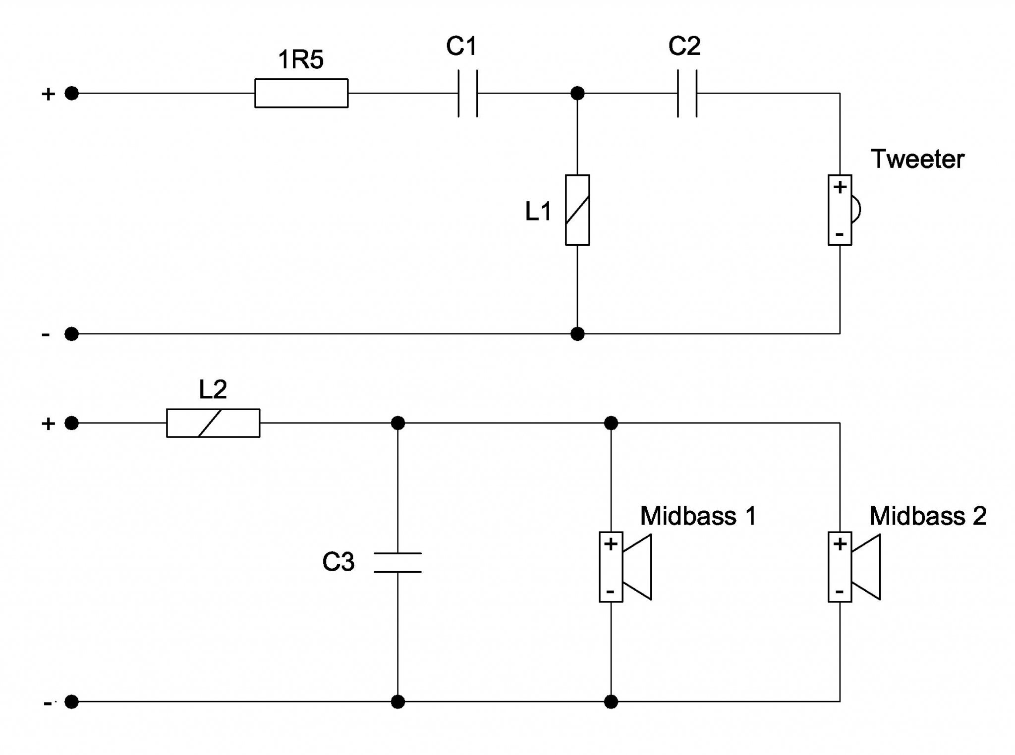

I think you can easily test if you like better the speaker with a brighter tweeter: check if really the resistor is connected between the +in and the midlle cap in the photo above, if it is then connect a wire with alligator clips between the +in and the same cap, in this way you are paralleling the resistor and having a total of 0R more or less (totally reversible, no soldering required). If you like the sound more than before you can unsolder the resistor and play with different ones as said before.

I would first bridge the 1R5 with a piece of wire. If it is a resistor in line with the tweeter, check with an instrument. If not, you must not bridge it.
If there are too many high frequencies, which I doubt, try bridging 1R5 with capacitors, 2,2uF, 1,5uF, some cheap polyester 100V for test, later take some better polypropylene.
Replace bipolar electrolyte (small blue one) with 100V polyester of the same capacity.
Be sure to check with the instrument to see if this is related to the tweeter line.
It would be smart dismantling and drawing the crossover schematic first.
One end of that resistor should go to the tweeter terminal, the other to some of the large capacitors on the crossower.
If those two blue capacitors are in series with the tweeter, you could try replacing them with Mundorf Supreme. It wouldn't be cheap, but the Supremes do seem to add a bit of sparkle compared to most other polypropylene caps.
I wouldn’t do anything until a crossower schematic is drawn. As for capacitors, my favorites are ClarityCapSA. They sound great and are not expensive.

I asked you to "extract" the crossover. That way you can photograph both sides. We can then trace the circuit and be sure of the position of the resistor.
However, you seem to be hell bent on changing the tweeter, even after all the good advice given. I hope I am not rude in suggesting you pursue the effect of altering the attenuation of the existing tweeter as a first line of attack.
I've read that the tweeter in this LS has narrow vertical dispersion, requiring a low seating/listening position as hinted at earlier by Rayma. The LS is also said to have a "forward" sound, by which I assume it is midrange prominent and unrevealing of the contribution made by the tweeter. Please consider that changing the tweeter would not be guaranteed to bring about a noticeable improvement.

That is what I wrote, but the OP clearly is set to the idea that changing the tweeter with a more expensive one will give him the sound he is after. But he isn't able to determine what he really wants with the audiophile jargon "more agile" and sparkle. I was simply suggesting to bridge the resistor after checking it is really the first element in the tweeter crossover. The picture posted suggest that the crossover is the one in post #90 but it is not 100% clear.

Why would that be logical, care to provide more info?The resistor should be logically before the crossover,
Ralf
A resistor before or after XO will still reduce tweeter's level by the same dBs. The one after will have to be taken into account re. impedance of that branch of the XO. Anything else that you know that no-one else does?
I didn't mean that there can't be a resistor after the crossover, but only that looking at the photo posted it seems logical that it is before the crossover. For me the diagram in post #90 seems logically correct. I still wait a photo of the other side of the crossover to be sure.
