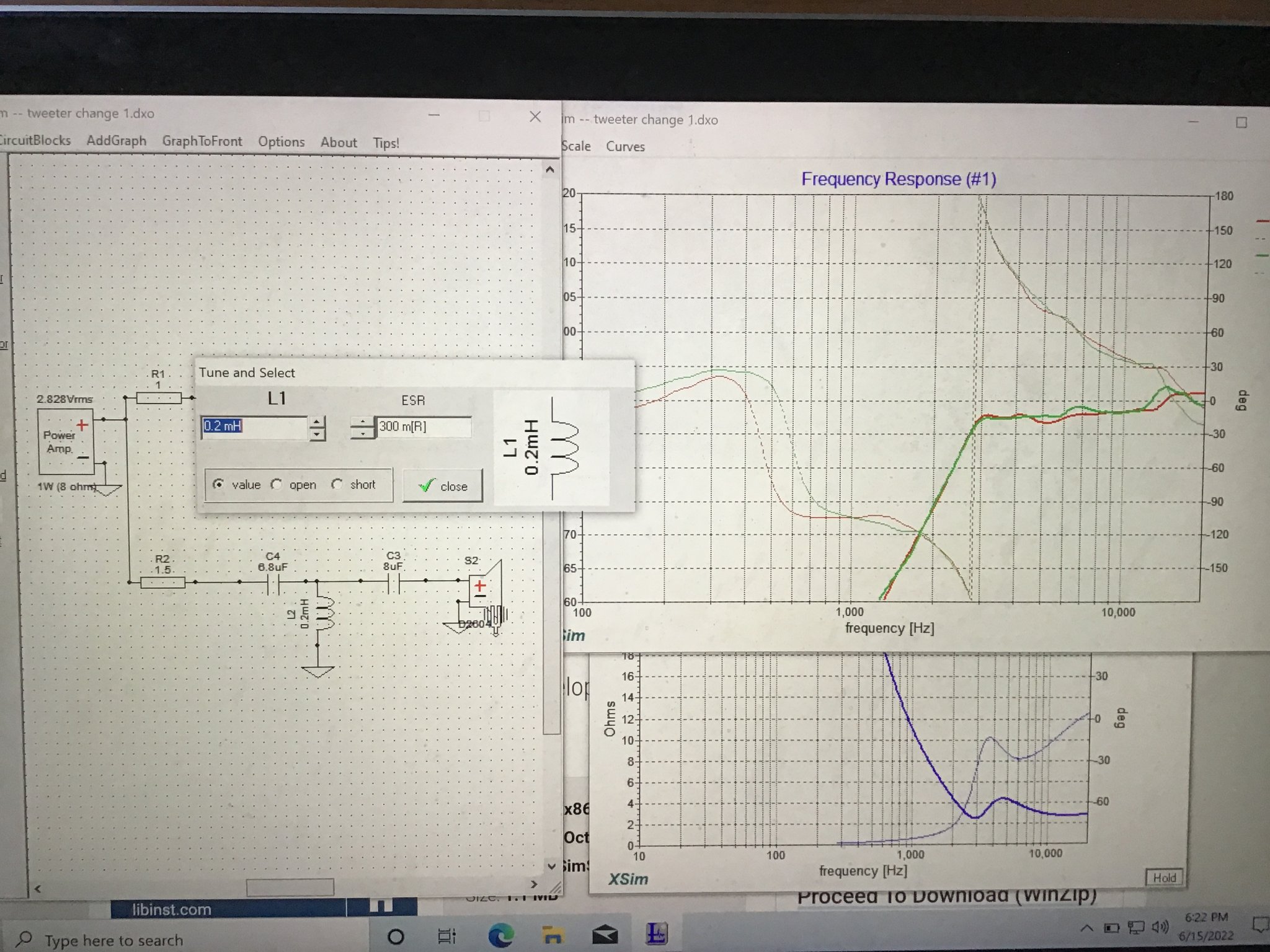

'Upgrading’ my tweeters (can I do this?)
It takes a lot of parts and a lot of patience to modify a crossover. The result is usually great if you succeed. I have a bunch of parts, mostly capacitors and resistors, and I can borrow parts when I need them from some friends on the local DIY forum. Coils of various values, for example, I don't have too much of that. If you don't have all that at hand, it's hard to do.
In this particular case, it will probably be reduced to changes in capacitors and resistors. It's not that complicated.

Try measuring at 2m and with a window of about 5ms. It won’t be without reflections ruining your measurement, but you can check if the dip is still there. It shouldn’t.
Btw NIXIE62 didn’t criticise on the design. Just warning you modding can and will set you of desired course if not done properly.

No, stay on REW. That is all and with ARTA the best solution, costly alternatives aside.
What you do need is a (crossover) simulation app like Xsim, Boxsim or VituixCAD. I use Parallels and W10 on my MacBook Pro and everything runs fine. So if you,re to invest, get W10 running on your Mac.

ok I’m up and running XSIM now on my laptop.
finally
what is ESR in the inductor values?
is that the DCR of the inductor?
thanks
