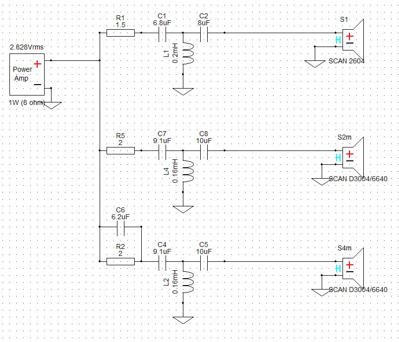

A few of us have already suggested bypassing the resistor. If you use a fairly big cap, say 33uF, the filter slope remains the same, while the 10kHz region gets lifted 1,5dB. That should just bring the sparkle. See #174 😉

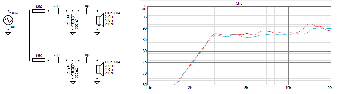

Although I would have a hard time justifying it, given tone?'s interest in a tweeter upgrade to the Scan D3004/6640, here is how it might look compared to the current one. Take this with a large grain of salt though tone? as there is no guarantee that the files I am using are correct. For the Scan D2604, I'm using Zaph's measurements and for the D3004, I'm using HiFi Compass's. Files do not contain baffle diffraction responses but it shouldn't matter as they should be exactly the same and so therefore cancel each other out for the purposes of comparison.

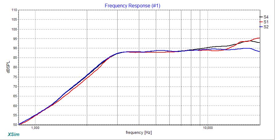

Red is the current tweeter with the correct xo values. Blue is the D3004 with xo adjustments and black is the same with the addition of another capacitor to increase the top end 'sparkle' zone.
And the filters:
So it looks doable to me.
And the filters:
But for better accuracy, you should take measurements of the raw (no xo) FR and impedance of the current tweeter on the baffle and then repeat the exact same thing with any new tweeter, again on the baffle.

Nice post, jreave, I feel the better way to be accurate without redesigning is closer to your first way. It's simpler too, not needing measurements. As you say, the baffle effects remain, it's just the differences between the tweeters that counts. This assumes tone? wants to make them comparable to start with. It should only take factory response and impedance plots and a simulator.

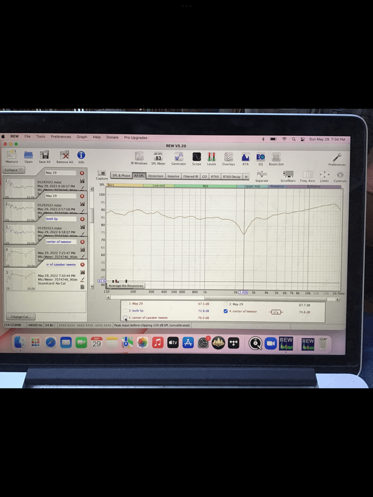

below is a measurement I took of my speaker at one foot with the mic at the center of the tweeter if it helps. I’m assuming that dip at around 4khz is the baffle Diffraction?

You can use them in any crossover simulator. Here I've shown how it would look if you did nothing to the crossover, just screw in the other tweeters. The sim uses the respective impedance plots. The current d2604 is in red.
It appears the first thing to try after this is reducing the resistance...
yeah someone sent me a pad calculator last night and doing the math I think changing the resistor to 1 ohm ( instead of the 1.5ohm currently) for the 3004/6600 tweeter would work nicely.
