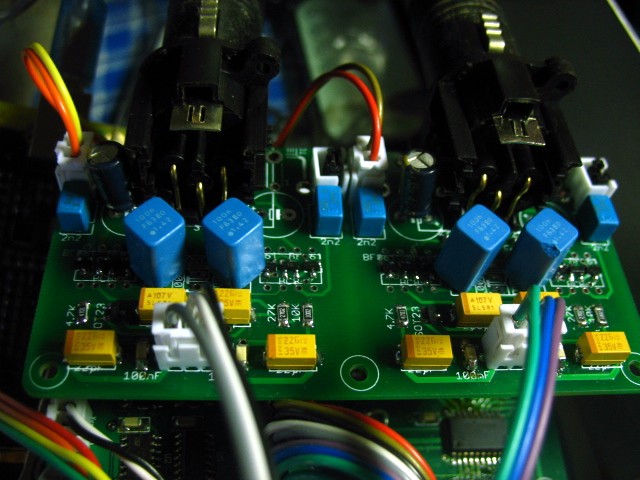

More R2R DAC Buffer Pictures
Attached are two more pictures of the Buffer PCB made by LeonBernieniv for his R2R DAC. Very good looking Buffer job.
The R2R Buffer PCB design is a little different from the first ones used on the DDDAC, but it is still a JFET Buffer with Cascoded JFET CCS at heart. It is dual mono with voltage reference circuits for both sides. All transistors and some capacitors are SMT. The outputs are capacitor coupled. The JFETS are running at 100% Idss with no source resistors or adjustment pot. Some modifications will have to be done to duplicate the circuit function of the DDDAC Buffer. I will need to take a closer look to make sure I totally understand the R2R Buffer layout.
I need the PCB board dimensions and mounting hole distances to see how it might fit on the DDDAC.

carlsor, the board had no more changes with circuit even element value but replace ztx450 with bc847, the circuit has a wide swings that I have not changed your bias settings. So I think it can be used directly on here. Notes TL431 is normal pinning(1.cathode, 2.ref, 3.anode)

Thank you again for the use your Buffer pcb design. I have questions to help me understand your circuit layout better.
1. I don't see any resistors to the gates of the BF861 or to the base of the BC847 transistors. Are these located on the bottom of the PCB? I discovered that these eliminate the possibility of transistor oscillation.
2. I don't see a 10 ohm resistor or adjusting 20 ohm pot from the bottom BF861 to -12V. These cause the JFETS to run at 70-80% of their Idss and to reduce the differential output offset to near 0.0mv. We want to drive output transformers, not output coupling capacitors.
3. Why did you use the BF861 instead of the BF862 JFET transistors?
4. What are the dimensions of your PCB and the distances between mounting holes?
5. Who manufactured your board?
Thank You....carlsor
Yes, the resistors was on the bottom side. BF861 is just a name of the lbr I made it. And dim. is about 8x6cm, I'll have a look late. Maybe it should be more mod as you sad. I'm a l33t and just for fun for this.
faint... I'm noooot a l33t
Carlsor, the dimensions is 4 inch * 2 inch, distances of holes is 3.7 inch * 1.7 inch.
I know most people do not like SMD, the board seems to be some tendency to personalize, and I also did some "wacky" setting, as you can see the OP-like footprints, but v-cut prices more expensive, then put this grotesque stay on the board, the OP-like also has a separate brd file attached.
So if you really do not like SMD, may need to re-design, there are many real master here, I'll not participate.

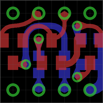

R2R Buffer
LeonBernieniv,
As long as the files are masters we can modify as needed. We may have to make a couple of prototype boards to see exactly what you have designed.
I still cannot see how the little "OP-like" board works with the main buffer board.
