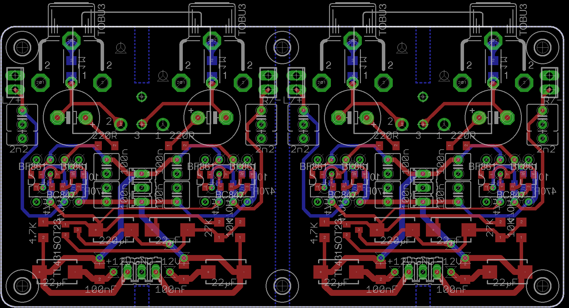

Buffer Boards - Availablity Change
I am not allowed to sell the Buffer PCB sections shown in the pictures and listed in the BOM. There was a misunderstanding with the persons I was working with on the "different PCB project".
LeonBernieniv has graciously offered the Eagle brd files for the the Buffer board he had built a few months ago from a buffer schematic I posted a long time ago. http://www.diyaudio.com/forums/digi...ddac-pcm1794-output-coupling.html#post4035077
http://pan.baidu.com/s/1sjHNrVv
I do not have or know how to use Eagle software. I hope someone in the forum can help me with this.

CCS Mini-board - next revision anyone?
I think its time to go to the next revision CCS Mini-board by dropping the cascode, adding pads for an SMD JFET next to the TO-92 holes, and adding pads for an SMD resistor to be optionally used in place of the pot for those who can measure exactly what source resistance they need. Thermal drift does not appear to be a significant problem with the 2SK246Y and the 2SK208 "O" and "R".
This board can be smaller at no more than 15mm x 15mm. I hope someone with PCB CAD experience comes forward to make this simple board design. I will help with the design review and GB if necessary.

Thought of some other things - I cannot get the .brd file to open - as if I know what that is. If that is a PCB design it seems all that needs to be done is send it to a PCB manufacturer.
I iwll ask John Broskie who he uses for his boards - hey are fantastic quality.
(had to ask)
Figured out how to open it.
Looks like it is ready to be sent to a PCB maker.
Just a matter of finding one ...
Just poking around the net - it seems like the boards could be done for about twenty dollars a piece if twenty boards are made.
Board looks simple (two layer) and not too big.
Should not be a big deal, unless there are only two of us who want to do this!

Buffer Eagle File
rickmcinnis,
The NO! NO! NO! was in reference to your first sentence in your Post #50, not to the rest of it.
It's great that you have been able to open the file.
This board will have to be modified to have the size and hole locations to fit properly on the DAC or Main Board. It was originally made to fit on an R2R DAC, not Doede's DAC. I've never seen it in full detail. Can you send me a pdf or jpg of the board so I can look at it?
Email it to me and we can work out the details out of the forum. I'm sure that there are PCB makers with minimum orders far less than $400.

interested
I'm interested. But have no idea who could make the job. Since smd is not "my cup of tea", I'll find some 2SK246Y.
