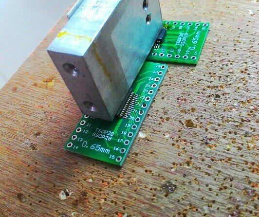

My exps. for SSOP28 package :
- Put IC on the board and align its pin and pad,
- Make 2 soldering points on pin 1 and 15 to fix the chip
- Use small piece of heatsink for chip and hold it by one hand, soldering by other hand.
- Finish soldering job pin by pin, by squeezing solder tip for each pin from chip's edge side.

Now that's my idea of a heatsink!
I never considered using weight to hold the chip to the board.
I thought I was being clever and used some epoxy to glue the chip and then realized after it was too late that this would not allow optimum soldering.
I was using a tiny tip but wonder if it was still too large.
I had been encouraged on the 'net by a technique where you simply ran the iron across the pins. I thought the flux would keep everything from getting messy. I am sure this can work once mastered, but ...
I know I will have to try again. next time with a "heatsink" - thanks!

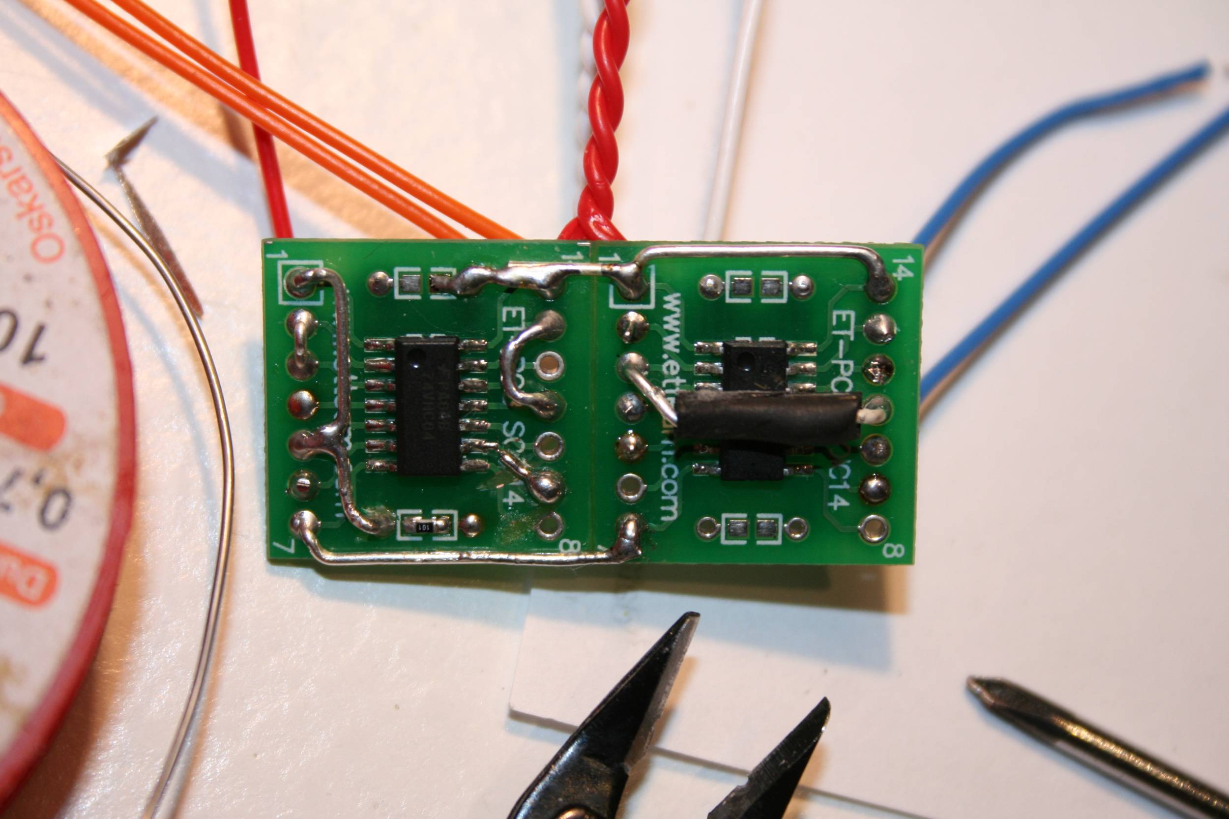

Half clock delay
I 'finished' the clock-delay-thing and it gives sound.
Only one channel does 1.2Volts and the other does 2.4Volts.
What did I do Wrong?
Any suggestion is welcome,
Ed

Nope, this heatsink is small piece of aluminum material so it light, the main purpose is protecting chip from overheat.I never considered using weight to hold the chip to the board.
By using expoxy for gluing chip, it's make you more difficult to rework then if any reason for changing mainboard.
clock-delay-thing problem
Ed,
Excellent looking wiring job! Seems correct as far as I can tell. If you messed this up there would be NO sound.
I assume the 2.4V and 1.2V refer to both differential sides of the Rload resistors which are on the analog side. Even with no digital signal these should both be 2.4V. Are you sure these were both 2.4V before you added the 1/2 clock delay?
The PCM1794 in mono mode provides two outputs to each Rload resistor which are combined and the current summed. Maybe the LR signal path for the low voltage side was messed up during this change, but this is the only I2S signal not affected by this upgrade. You did change the Data resistors from 1K to 100 ohms, right?

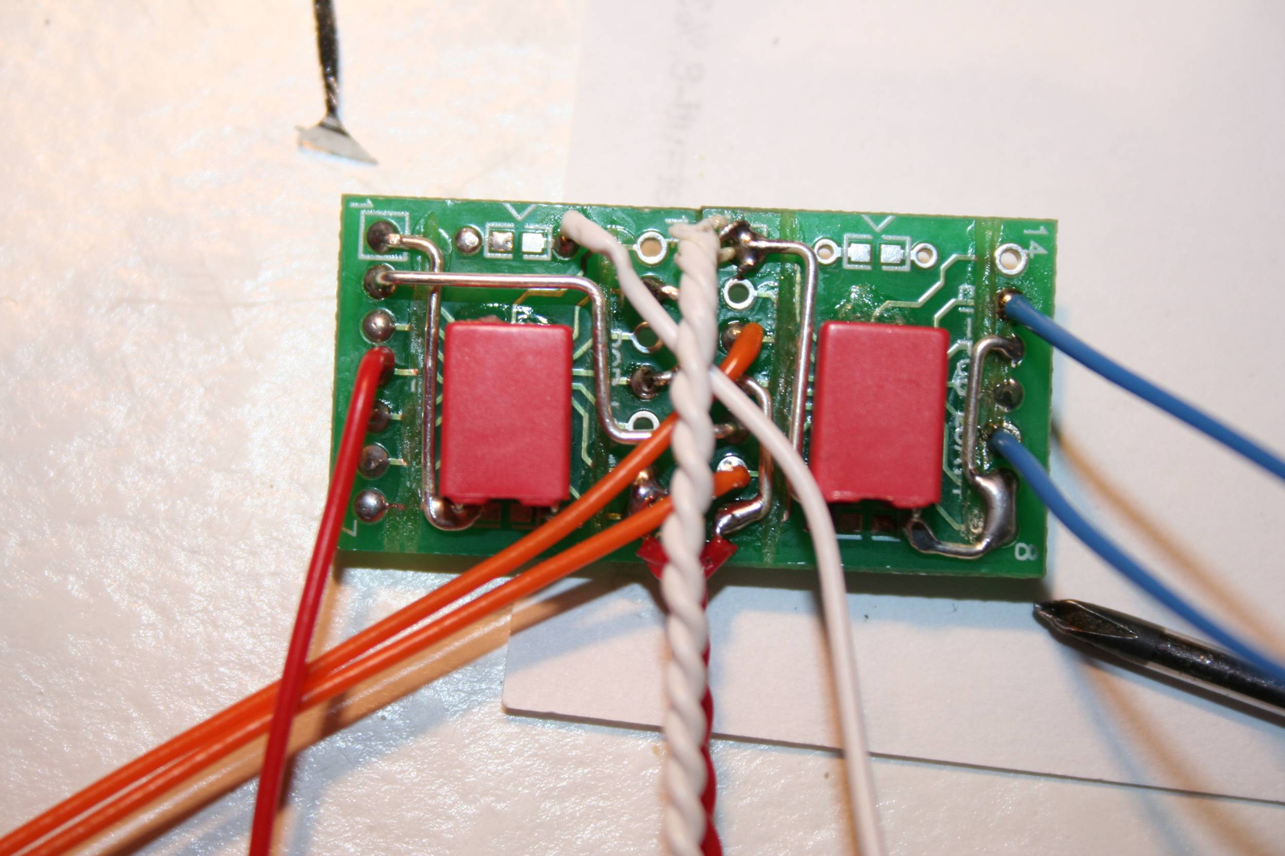

Hi Carlsor,
Thanks for having a look and thanks for the compliment!
It's always a problem to be shure how the situtation was before the mod?!
I played a 400 herz testtone at a certain level, where I mesured the difference in output between the left and right Dac's pos- and neg posts. This after noticeing the channel difference while playing music material.
I did change the 1K resitors to100 ohms.
I wil take the Dac apart again, and check both decks seperately hehehehe...
Thank you again for the help,
Ed

Ed,
If you have a 2 DAC board stack then it sounds as if one of your DACs has stopped putting out an analog signal from one channel - hence, half the voltage at one Rload. Hopefully its just a connection problem. Doesn't sound like a digital problem.

Hi Carlsor,
You must be right.
I will start playing the decks one by one so the problematic guy will expose himself. After thet it will be much easier to track the problem. Everything will be better in reach then. I let know what I find out,

Hi Carlsor,
Problem solved.
It appeared that , with removing the 1 K resistor in order to change for the 100 ohm one, I screwed the foil that makes the connection from the resistor to the DATA connection point. That's all. So my friend is 'singing' again, even better than before.
Thank you for your helpfull how-to!
Up to the pin 20 mod!
Happy Eddie
