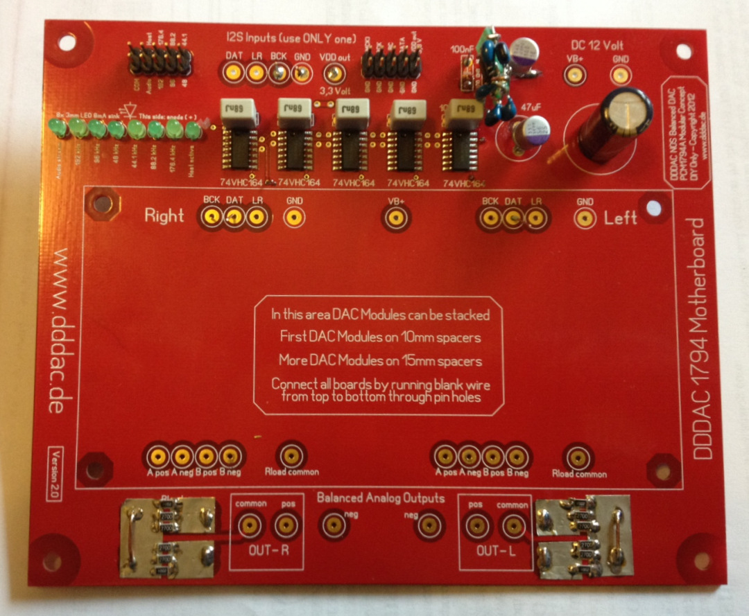

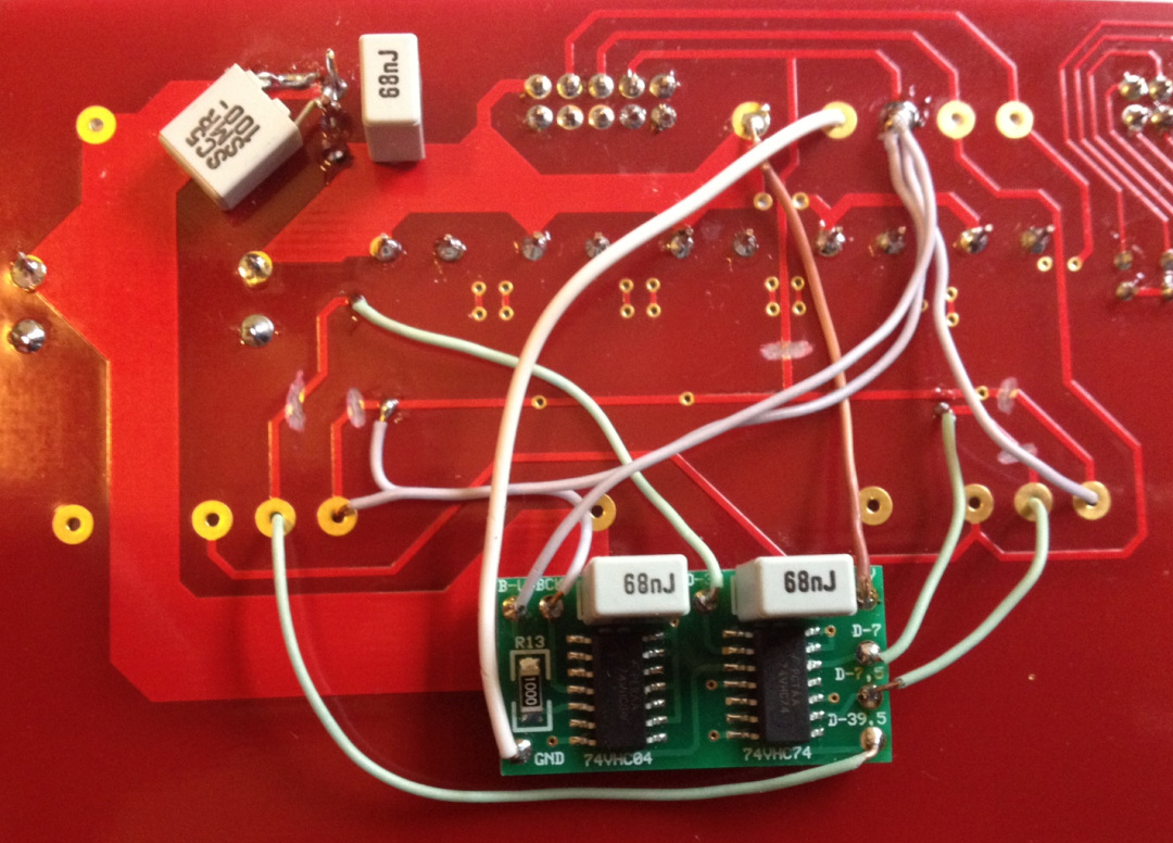

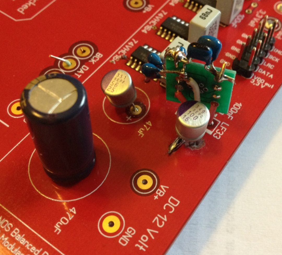

Digital Vreg - PPS Film caps and ADM1750 Liner Regulator
Below are pictures of my latest red Main Board build. The only changes from my earlier two red Main Boards is the use of 0.068uf PPS film bypass caps and a 5 volt regulator made from an SOIC adaptor board and the ADM7150 5V Liner Regulator chip. I coupled this with a Buffered DAC board that also had PPS film caps and diy ADM7150 3.3Vregs in the digital section. I also used Susumu RG's for the Rload resistors. The ½ clock delay board from the GB can be seen in the picture of the bottom of the red board. I modified the Main Board to accept an OSCON (top) and PPS film cap (bottom) just ahead of the Vreg just like I had done on all my main boards. The bypass cap after the Vreg is installed through the bottom of the board.
PPS (Polyphenylene Sulfide) is a fairly new capacitor film material that has better high frequency characteristics than PET film and can handle higher temperatures for SMD soldering. These are mentioned as components in some expensive audiophile equipment and professional Mods. These are available as both SMD and through-the-hole capacitors. The mouser part number is 80-SMR5683J100J03L4 and costs about $1usd each in quantities of 10 or more for through-the-hole PPS capacitors.
This DAC exhibited some sound qualities that exceeded anything I had heard in my previous two upgraded DAC builds. The change was small but unmistakable to me: More emotion. Getting drawn into the music more often when trying to do something else. More note sustain and decay. More precise location of instruments and voices along the soundstage. The ADM7150 Vreg should not sound better than the Belleson. More about the ADM7150 Vreg in my next post.
Since I have committed the sin of making more than one change at a time, I ordered another complete set of PPS film caps to install on one of my DAC builds with Belleson Vregs. This should help determine if the PPS caps made the difference I heard. IMO they certainly did no harm.
... This should help determine if the PPS caps made the difference I heard. IMO they certainly did no harm.

I also have the PPS bypass caps on the DAC board in all digital positions. I have 15 PPS caps in all in my build. I suspect that a better bypass cap would have the greatest impact at the PCM1794 chip Vdd.
@carlsor:
I've been listening to panasonic 100 nF PPS SMD capacitors on the VDD supply of my modified DDDAC and these capacitors had a certain quality to them that was different from e.g. 100 nF C0G SMD capacitors from Kemet. I decided to use the C0G's because - to my ears - they imbued a more tonally rich sound than the PPS capacitors. Yet today I tend to conclude that capacitors - even of the same "technology" - may sound quite different depending on the manufacturer.
One technical aspect though is that PPS (to my knowledge) has a steeply rising diffraction factor above about 1 MHz. I remember reading this in a paper from Vishay but right now can't find the reference ... C0G on the other hand has a quite equal and linear dissipation factor.
Anyway, just FYI - in my experience even minute changes to a circuit may be heard so good luck in experimenting ;-)
