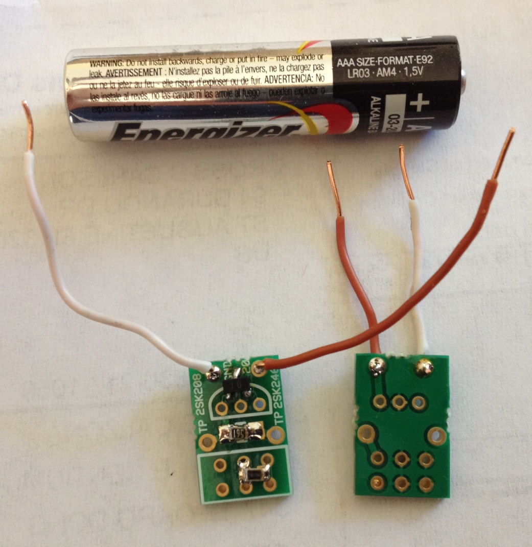

CCS Board Assembly Instructions
The board is so small (10mm x 15mm) that it is easier to leave the boards connected to each other so that they don’t move around so much while soldering components. I succeeded on my first try at soldering and testing a pair of CCS boards with matched SMD resistors. They both measured within +/- 0.001ma of 0.400ma when I was done. The number written on the JFET pouch is the total resistance needed for the 2SK208 to operate at 0.40ma. The paper pouch is easily opened with a razor blade or X-acto knife.
1. Solder all the SMD components including the 2SK208, fixed resistor, and pot area SMD resistor if you ordered the parts kit with matching resistor values. SMD tweezers are a must! SMD techniques are recommended, but not absolutely necessary if you are careful. NOTE: I used a small soldering tip with Wonder solder. The soldering pencil heat was the same as for soldering through-the-hole components. I put a small amount of solder on the gate pad for the JFET and on one pad for each of the SMD resisters. Next I held each SMD component in place and touched the hot tip to the pad leg junction until the solder melted – usually within 1 second. Next I soldered the other leads/ends by putting the solder between the component and the hot tip and pushed through the solder until there was solder flow – again usually less than 1 sec. You may want to resolder the first solder joints if they don't look good enough. I am 67 and don’t have the steadiest hands or great eyesight and limited SMD experience – so it should be “a piece of cake” for you guys to succeed at this. I didn’t use a magnifying glass, but it would help.
2. TEST: Measure the fixed resistor by putting an ohm meter across the two TP points. The 2SK208 and it’s solder connections can be tested be putting a meter in the diode test mode and putting the red/pos probe on the JFET gate and touching the black meter lead to the pin 20 hole and then to the right TP hole. You should get readings between 0.2 and 0.8.
3. If everything appears ok then install a multi-turn 500 ohm pot if matching resistors were not used. Depending on the available space and orientation of your DAC installation, the pot can be installed on either side of the board and aimed upward or outward from the CCS board. Pots can be obtained with the adjusting screw at the top or side of the pot. 1K or 2K pots can be used if that is what you have on hand. You can use a smaller value pot as long as it is larger than the total resistance number minus the fixed resistor value.
4. Install wire leads from the Pin 20 and GND holes long enough for battery or breadboard testing if desired. They can be shortened later.
5. Adjust the Pot until the resistance from the right TP to GND equals the desired total resistance. Your CCS board is done.
6. TEST: A 1.5V battery can be used to test the CCS before installing it in your DAC. The packet I sent you also has a label for the voltage you should get from volt meter leads across the 2 TP holes. The voltage should be at least 95% of the voltage you should be getting at 2.4V from pin 20; after all, it is a CCS device.
7. If the DAC has already been operating with the 6K resistor at pin 20, then measure the DC voltage at the Rload resistors for future reference. Shorten the CCS leads. Replace the 6K resistor with the CCS board. If the ground end of the 6K resistor is inaccessible because of the components around it, run a wire from any ground plane point on each CCS board to the Rload common points on the DAC board. You may want to rotate the CCS board about 90 degrees to the side. This is what I had to do.
8. Power up the DAC. You should be getting a voltage near what you measured with the 6K resistor in place. A difference within +/-5% should be fine. If your DAC has an Rload resistance of 133ohms/board you should measure within +/-0.1V of 2.7V at Rload A-pos, A-neg, B-pos, and B-neg to Rload common. If you have a CCS with a pot you can adjust to get closer to 2.7V if you wish. Rload resistors at 135 ohms will read a little higher at about 2.74V.

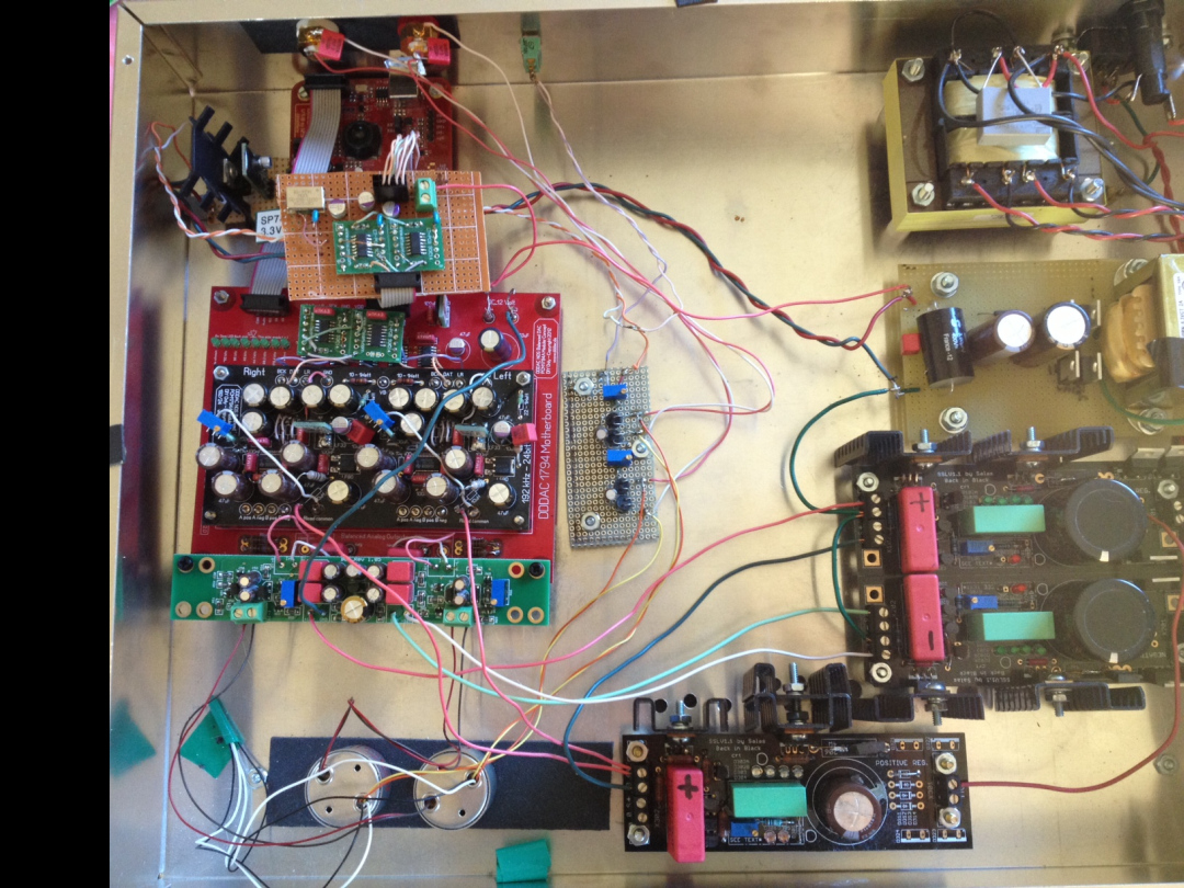

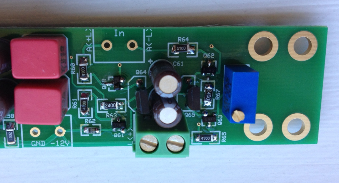

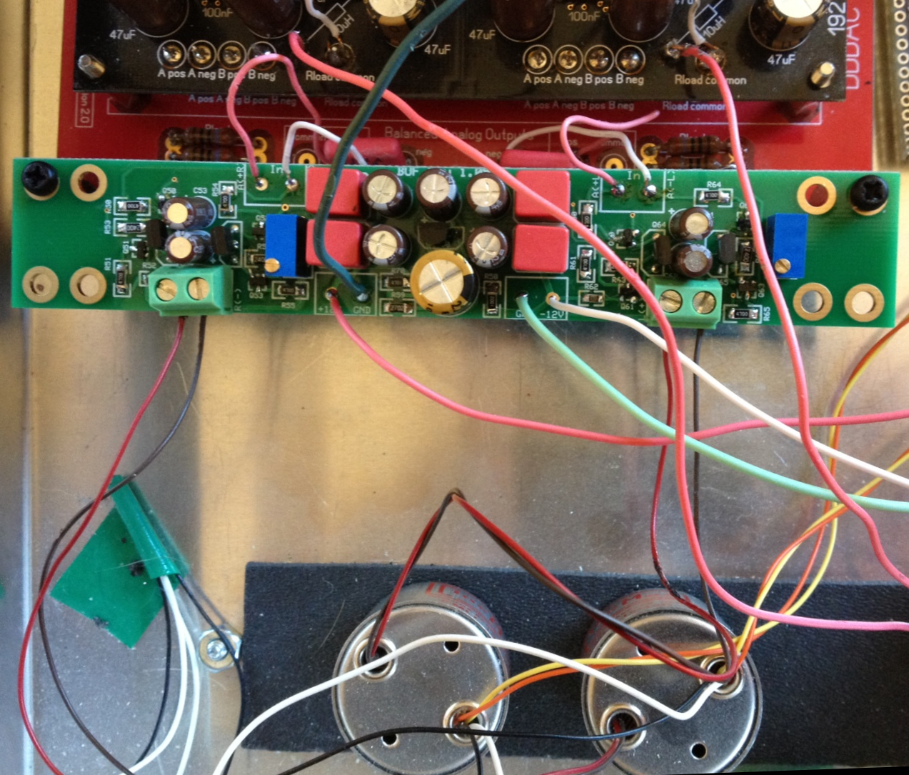

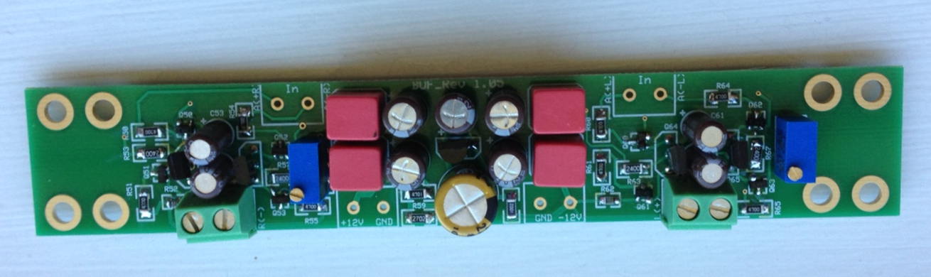

GB Buffer Board Assembled
I assembled my first GB Buffer board and it WORKS! I replaced an earlier broken-in prototype buffer board with this new buffer board and it sounds good, except for that "new parts" sound. A new break-in time period begins. When it approaches about 300 hours of music play time and sounds so bad I want to throw it against the wall - I will know that I am within a day of musical Nirvana. There will be stretches of pleasing and improving sq up until then.
The Cinemags should sound like they put their "big boy pants" on. No longer polite and thin sounding when driven by a single board DAC. If you haven't ordered your through-the-hole parts yet, I suggest that you add a pair of inexpensive 150pf WIMA FKP2 film caps to the order and install these on the outputs of the Cinemags to also break-in. Afterwards you can decide if you like how these affect the sound. IMO these make the musical details sound more real.
Attached are some pictures. I will post the Assembly, testing, and adjustment procedure shortly.

Hi carlsors,
Glad to know that the board is working 🙂
You did a great job showing everybody the board installed. Thanks!
I am really curious to know which breadboard you have between the dac and the waveio? It is a kind of reclock?
Best Regards,
Enrico
