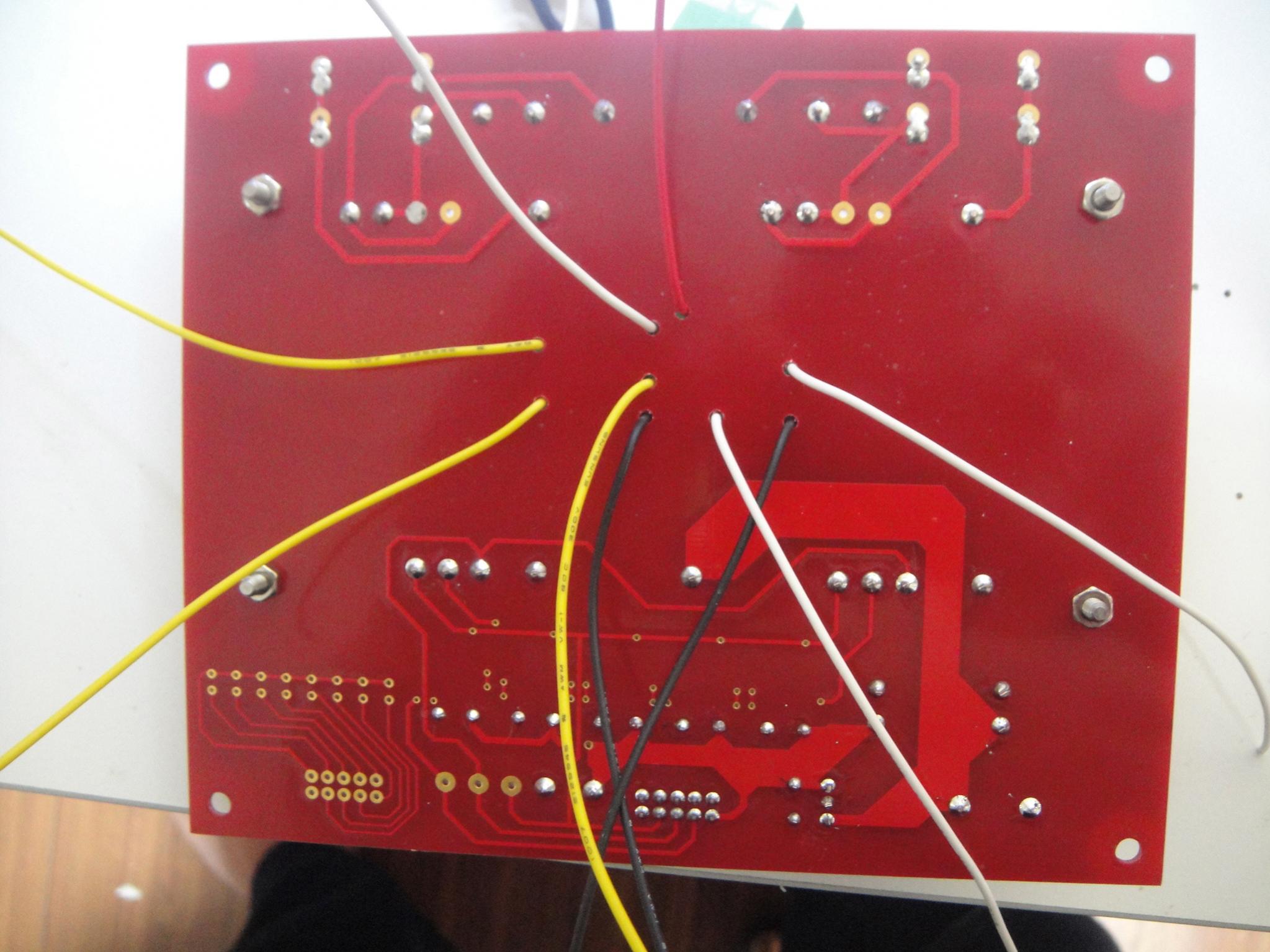

Hoping to get some pictures how exactly you connected your 1/2 clock delay to the red MB.

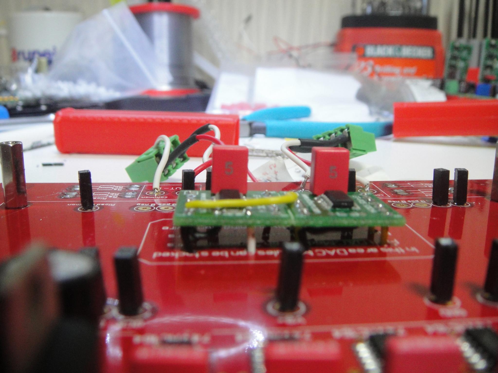

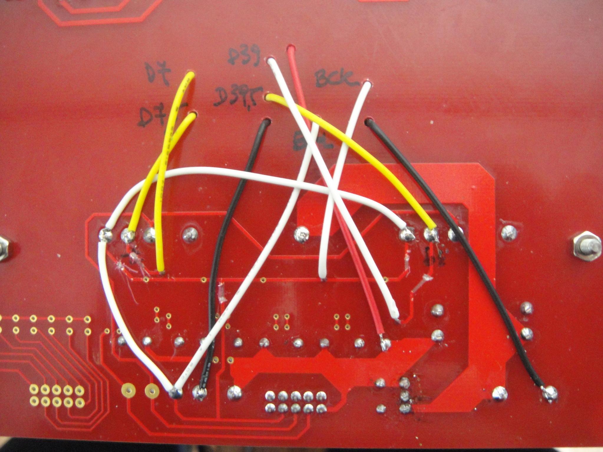

Attached are few pictures that should help you to understand the connections of the half clock delay.
To build mine I do the following steps:
- Allocate the 1/2 clock board in the top of the mother board (better with some paper tape) and mark the 9 small holes.
- Marked in the mother boards the holes as per 1/2 clock PCB (like D7, D7.5, D39 etc...)
- Soldered the 9 piece of wires into the 1/2 clock board (better with different colors).
- Inserted the cables in the holes and fixed the 1/2 board with a small bi-adesive tape.
- Revert the mother boards and make the connection as per schematic (in the pictures you can see clearly the traces that have to be cut and where the wires should be soldered)
I hope this can help you but let me know...
